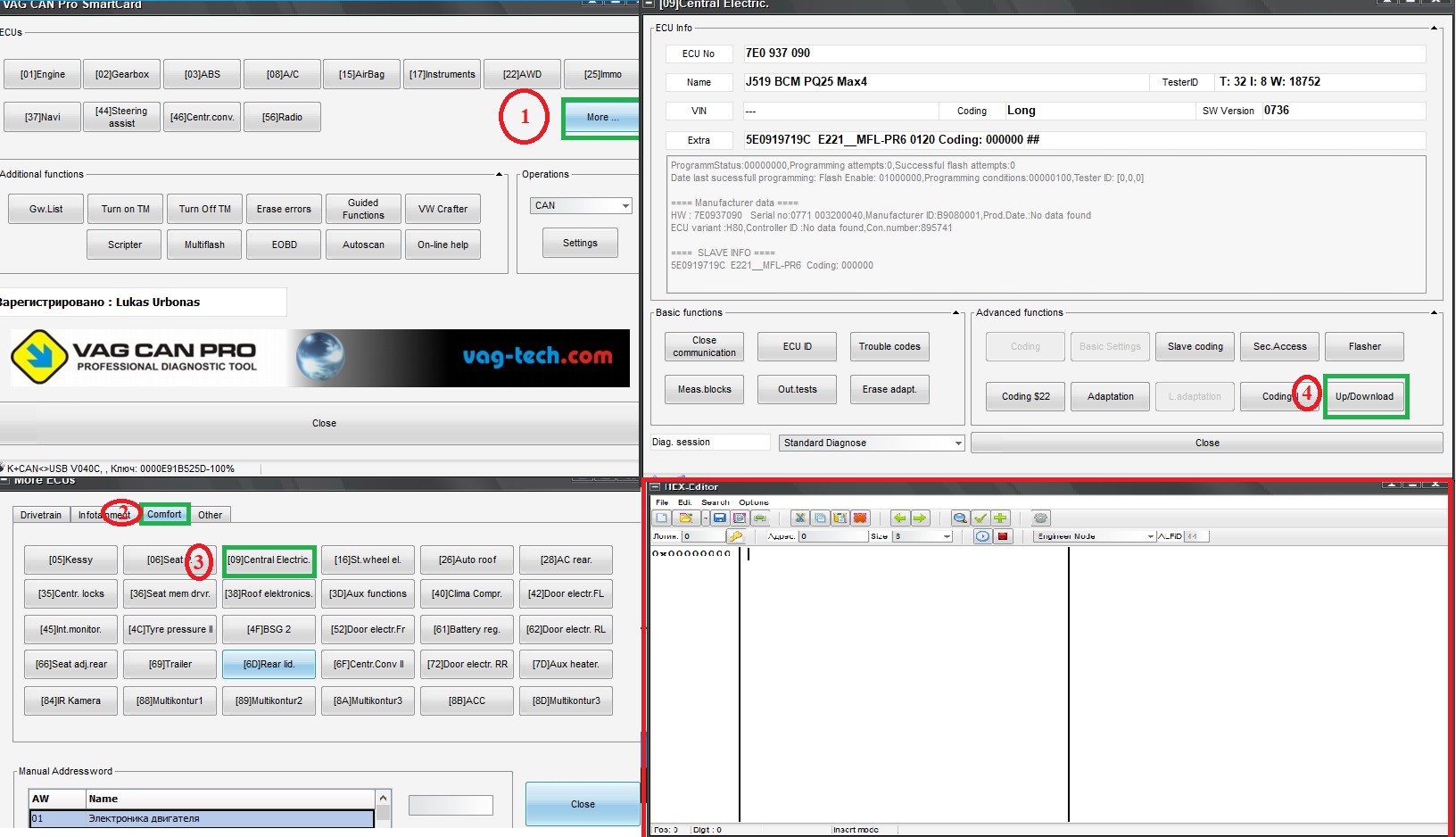

To have access to the first method that you say for lighting adaptation, the language setting of the VCP program must be in English.
Here you have a video of how to access and modify the values in a BCM PQ25.

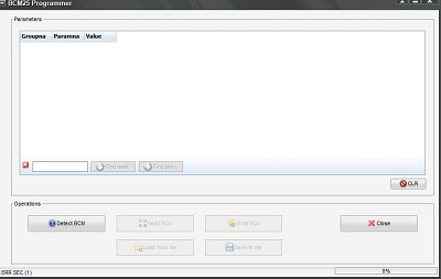

Rest of screen from google, I post my own on eng, but there are still some inscriptions that are not in English so sorry :|
anyway not possible access to this area with my vcp dongle. ERR SEC(1)may i change to Japan and it work😂

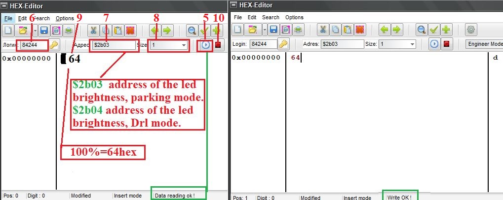

And i did 100% parking led :mrgreen:
alternative edit eeprom
More>comfort>09cetrEectric>Connect>UpDownload
how to make personally one less/more is not yet clear

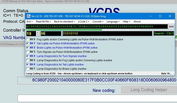

Byte19=56HEX is the only one that might make sense. Test it.
The rest of the bytes don't make any sense in your Rapid, neither before nor now.

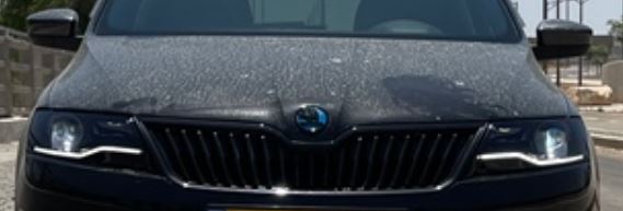

Rapid wrote: Wed May 31, 2023 9:39 pm but the drl and turn signals worked perfect.
...you mean that DRL worked perfectly cheating with Scandinavian lights, we must get used to telling the truth of things.
at that time I did not have led tail or only one(right)and there was a problem that it did not work correctly,
But everything was decided with the replacement of the Light Bulb Carrier 5JH 945 232
and coding for tail, inside 18 Byte uncheck all and leave only 0 -1-6 there it was explained differently from user on old bcm, so something like this. It looks like it's just removing warning from cluster. Tail works from box no need adaptation
Wow that help partially :!: outside turn led work perfect :mrgreen: but inside still work as crazy :!:

-BCM Byte19 = 46HEX

-BCM Byte19 = 46HEX
Everything remains the same, sometimes the right, inside works perfectly, but sometimes it also starts flashing quickly

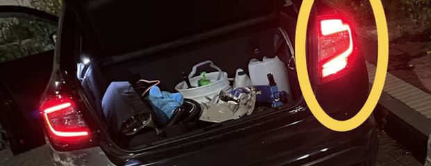

And Sometimes I notice that when approaching the car the rear led lights come on ,maybe 5sec not at full capacity, They also light up after closing ,40 seconds.
