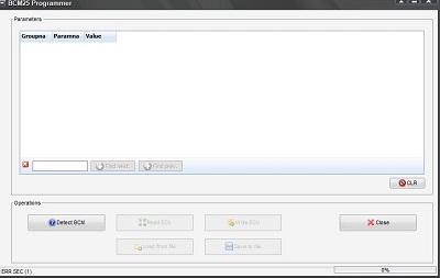

To have access to the first method that you say for lighting adaptation, the language setting of the VCP program must be in English.
Here you have a video of how to access and modify the values in a BCM PQ25.
Rest of screen from google, I post my own on eng, but there are still some inscriptions that are not in English so sorry :|

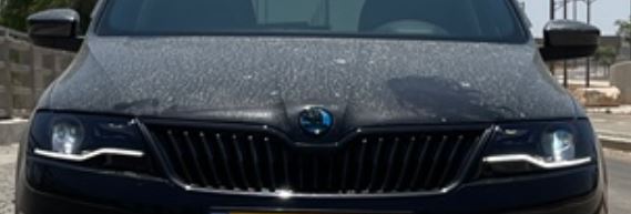

anyway not possible access to this area with my vcp dongle. ERR SEC(1)may i change to Japan and it work😂
And i did 100% parking led :mrgreen:

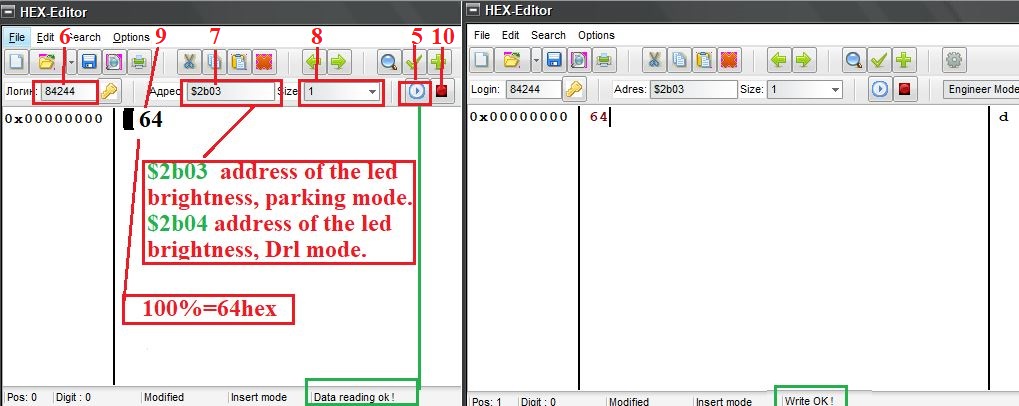

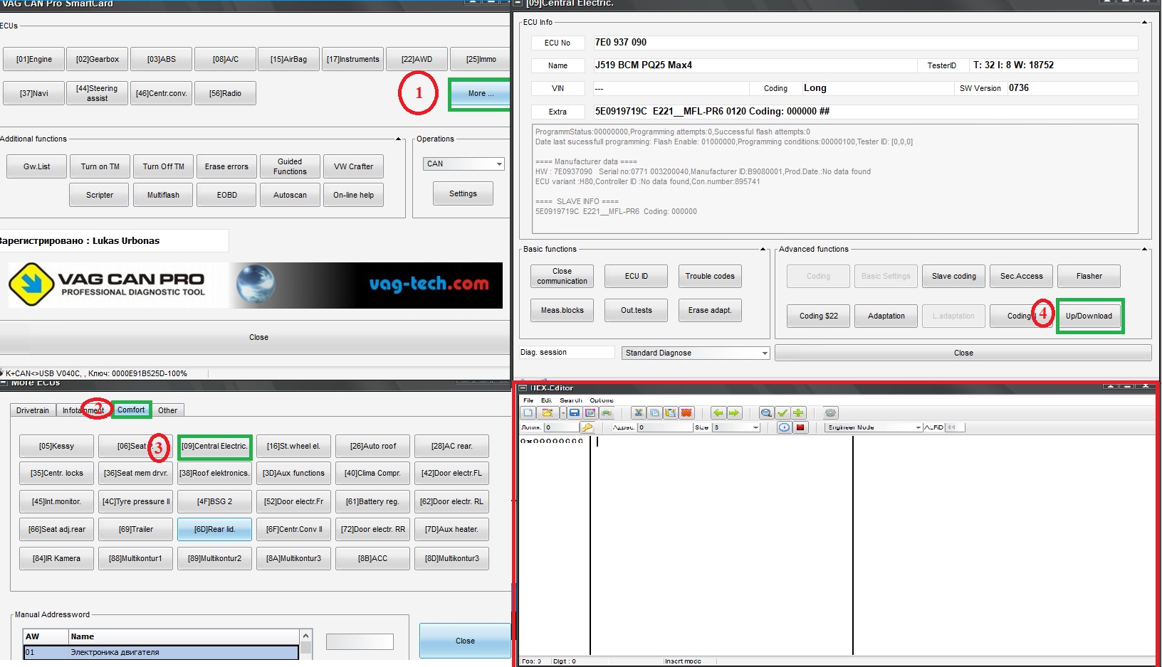

alternative edit eeprom
More>comfort>09cetrEectric>Connect>UpDownload
how to make personally one less/more is not yet clear

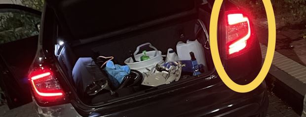

And Sometimes I notice that when approaching the car the rear led lights come on ,maybe 5sec not at full capacity, They also light up after closing ,40 seconds.
