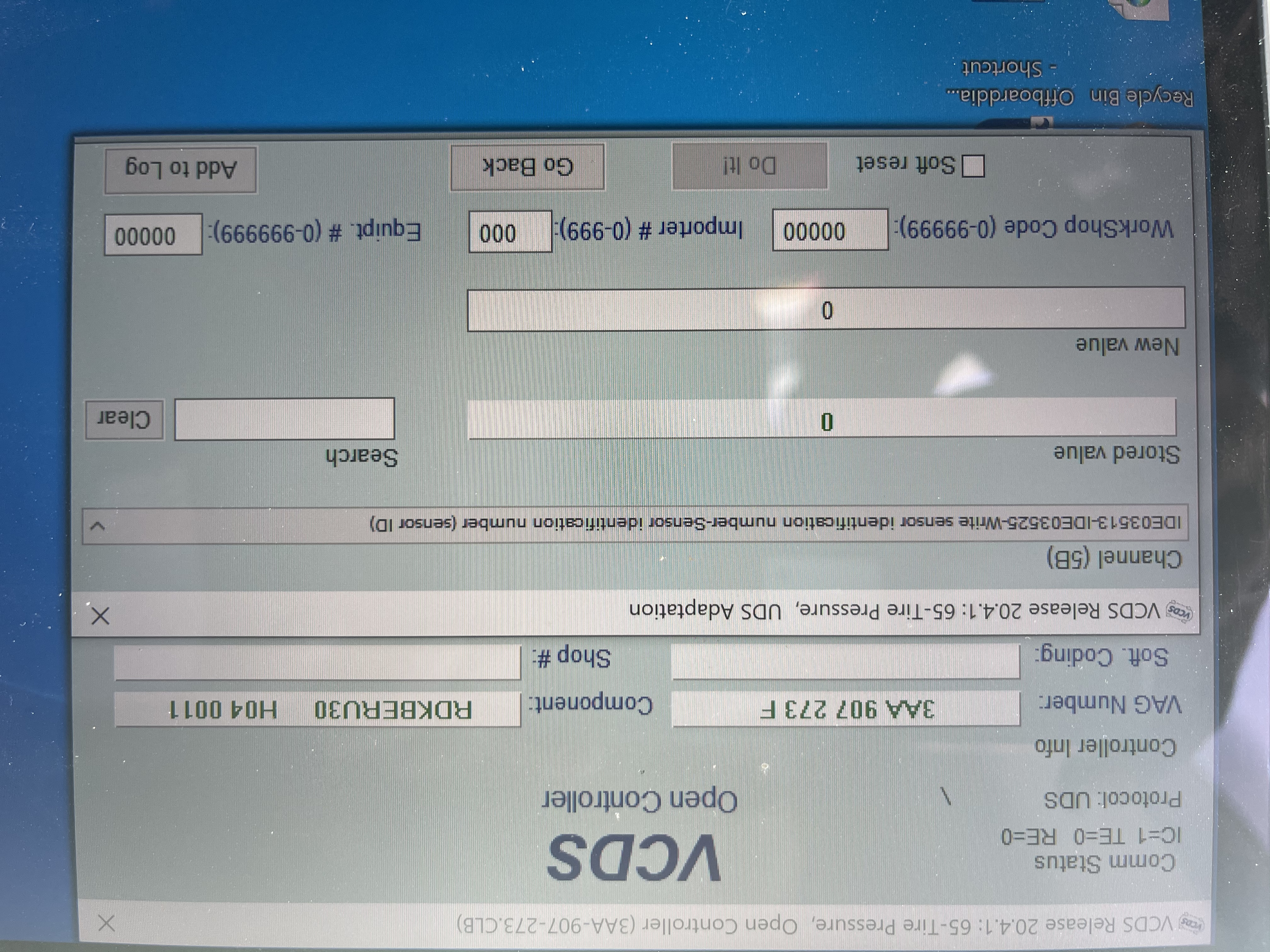

When the TPMS unit is new or flashed, this is what usually happens... it happened to me... :)
You must load the file with the wheel pressures.
Re: BCM Max Transporter 2013
Posted: Sat Apr 17, 2021 1:37 pm
by Shadow109

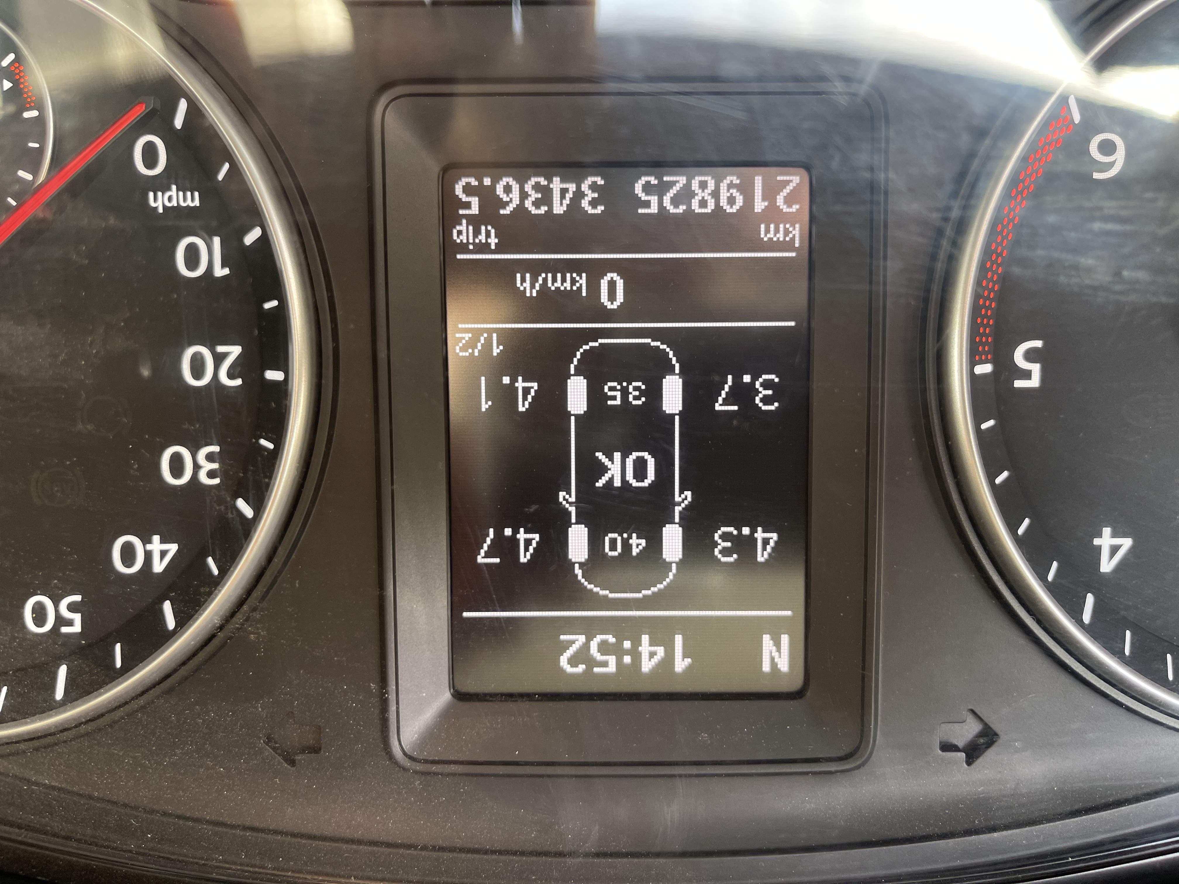

Finally
My TPMS unit was already in the middle, I did move it, but that didn’t help, so I started to play with the adaptation menu and make tests, until I found the secret 🤫
I changed the value to 1, and immediately the TP numbers had showed up
Posted: Sat Apr 17, 2021 4:17 pm
by patil
Oh good that you found the missing link and rectified it👍
