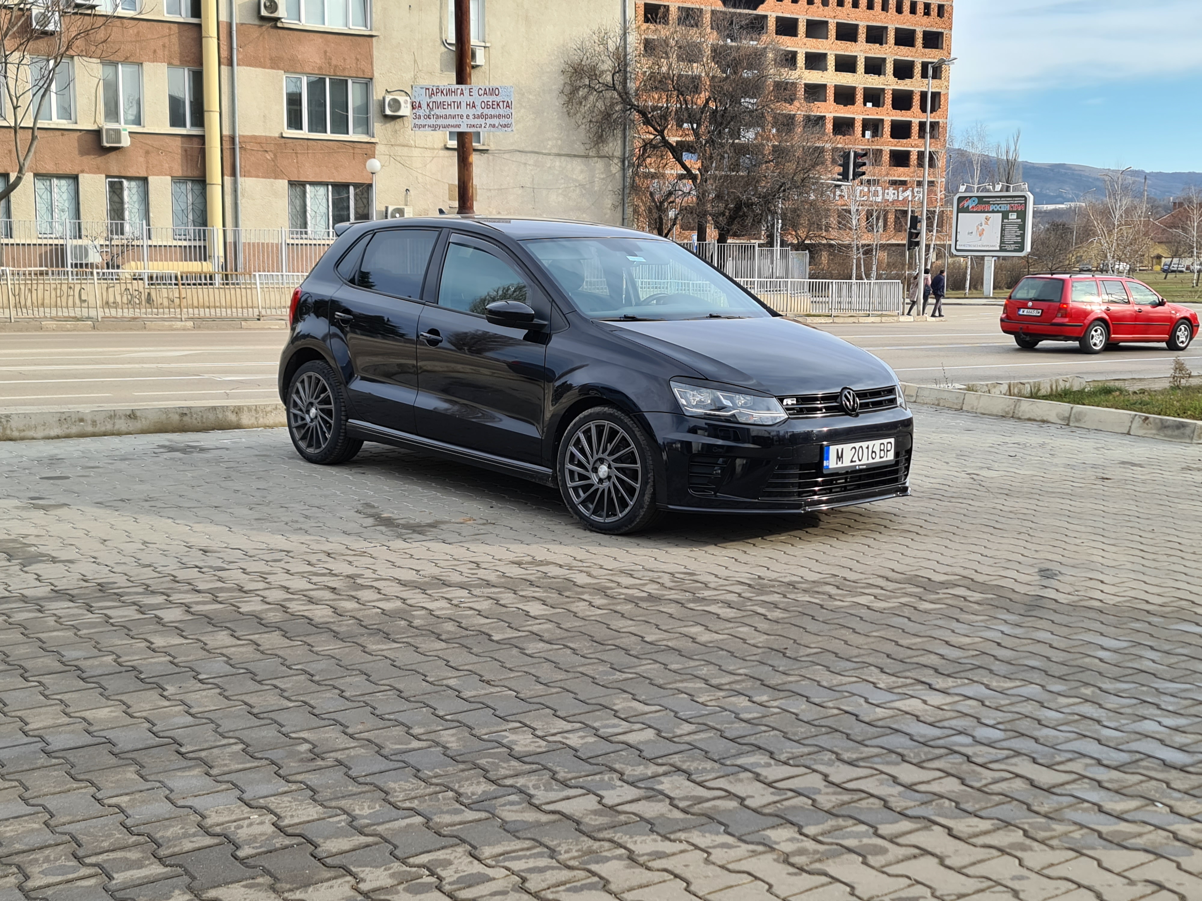

And here is one picture from this morning:
I also noticed that there is a new menu in MDF - LIGHT / VISION and in the submenu - Travel Mode, and watch:

patil
- Posts: 577
Re: 6C Full LED Headlights number
Your 6R looks stunning with LED headlights and those alloys
Travel mode: When you cross borders from LHD to RHD country, travel mode can be used to avoid glaring to oncoming traffic. AFS unit dips the low beam a little when travel mode is activated.ZahariGeorgiev wrote: Thu Jan 06, 2022 12:03 pm
[youtube]https://youtu.be/sy4n1SW1wCQ[/youtube]
Welcome to India(RHD) to try travel mode.
Thank you patil, a lots of people when they see it and ask me what kind of polo is that, and also they think it is Golf 7patil wrote: Thu Jan 06, 2022 3:58 pmYour 6R looks stunning with LED headlights and those alloysI can also see an old generation VW in background
