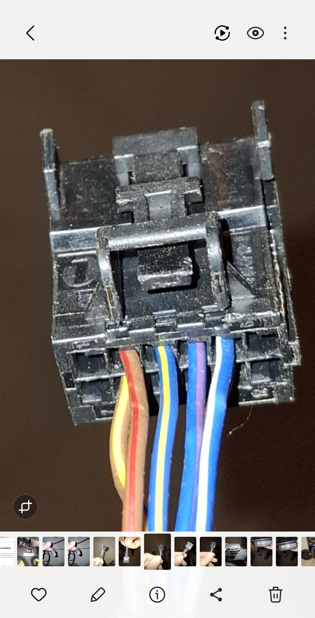

ciclo wrote: Sat Nov 08, 2025 1:52 am Image
'With extreme care'
Gently press the terminal tab. There are normally two travels.
It should come out relatively easily.
If you find yourself pulling the wire too hard, you're doing something wrong.
When reinserting the wires, first check that the tab is at the correct angle. You can use a utility knife blade to reposition it. Gently.
Have a nice weekend!
Ok does it need some other clips to be removed before that step? Besidea that on the picture rhat I pulled of?
Posts: 9037
Re: Parking Sensors
The connector you're showing looks like a coupling (aftermarket wiring).
Please show it from the front, or tell me the reference number of that connector so I can tell you which tools to use.

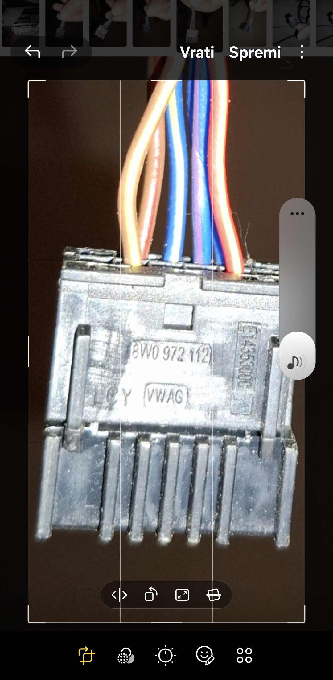

ciclo wrote: Sat Nov 08, 2025 7:51 am The connector you're showing looks like a coupling (aftermarket wiring).

Buci wrote: Sat Nov 08, 2025 8:00 am
Posts: 9037
Re: Parking Sensors
To press the tab...
The original connector is 8E0 972 112, but in this wiring they have used another original 8W0 which is compatible.
Posts: 9037
Re: Parking Sensors
Since I see you have no experience with VW connectors, you must do this job very meticulously. Do not use improvised tools to remove the terminals or you will end up breaking the connector, ...and the installation is over until 'you install a new connector with terminals'.
