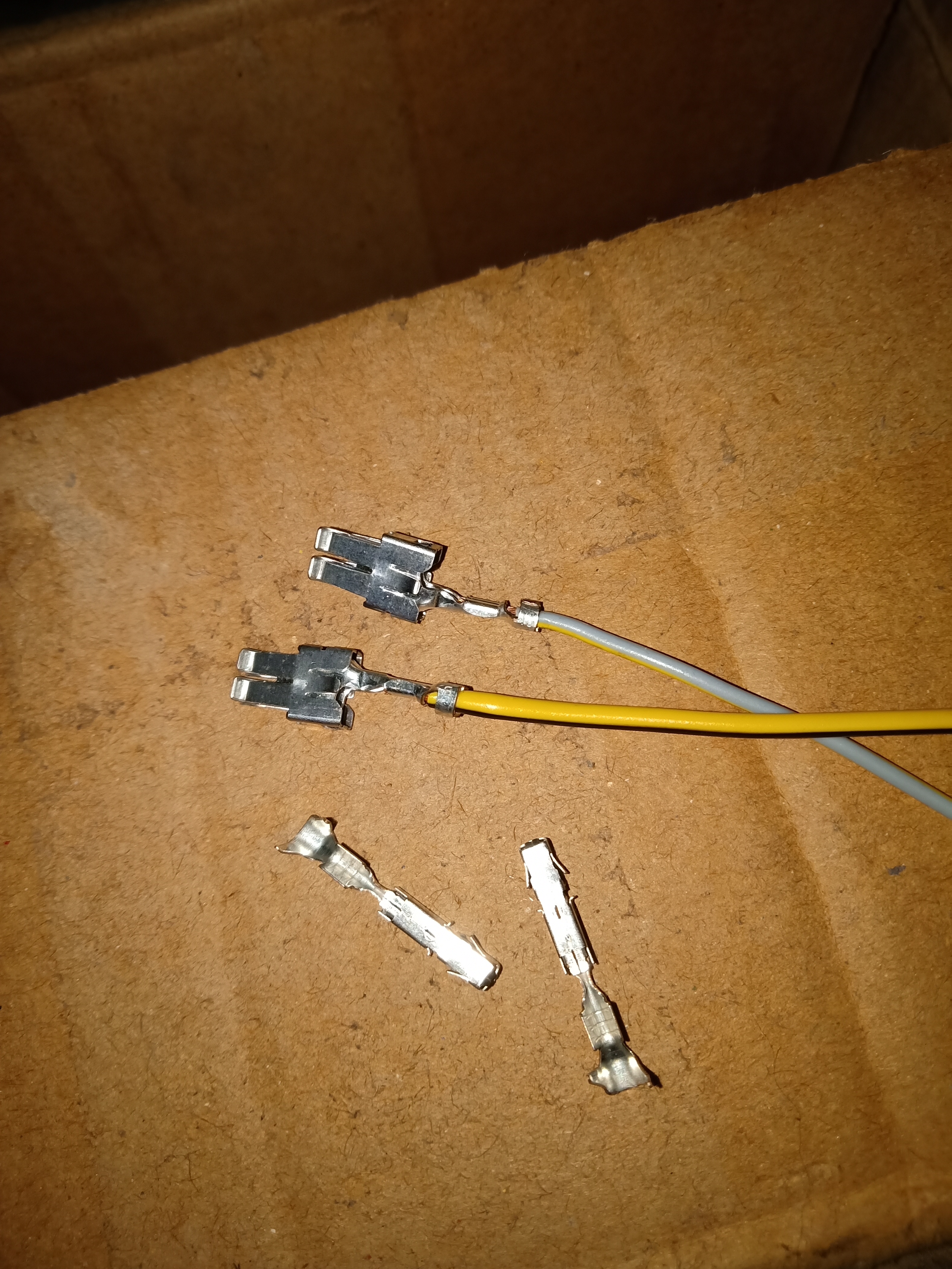

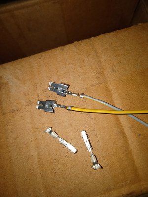

ciclo wrote:I have doubts, maybe I was the one who made the mistake.
I don't know the reasons why those MQS terminals are crimped in those cables.
Please verify again the wires 40a and 41a with incorrect terminals.
No problem for me to send you asap a new BCM-fusebox wiring. (free, of course)
If i keep t73a 40 & 41 as it is for time being can I adapt bcm and start the car ??
What error will it give??
Posts: 8981
Re: Bixenon headlights with AFS For polo gt Tsi 2015
hmthakur wrote: Fri Aug 17, 2018 10:06 am Whats the part no. Of MCP 1.5 ??
Can i get them at vw showroom??
You can get it for free from me.
I'll send you a new wiring for those two cables only - from the BCM to the fuse box -.
Do not uninstall the complete wiring -BCM/Fusebox- , when you receive my cables cut those with incorrect terminals.
I will send them urgently, however it will take 10 to 15 days (SP to IND). :|
Posts: 8981
hmthakur wrote: Fri Aug 17, 2018 10:15 am
You can not do that. Parking/side lights are mandatory.
https://uk-polos.net/viewtopic.php?f=62 ... 57#p540248
The car will always start.

Posts: 8981
I'm sorry, you already have to accept my proposal.
Verified (multimeter) and ready to be sent.
Is the same shipping address as before?
Do you want something more from me that I can send in the envelope you see?
