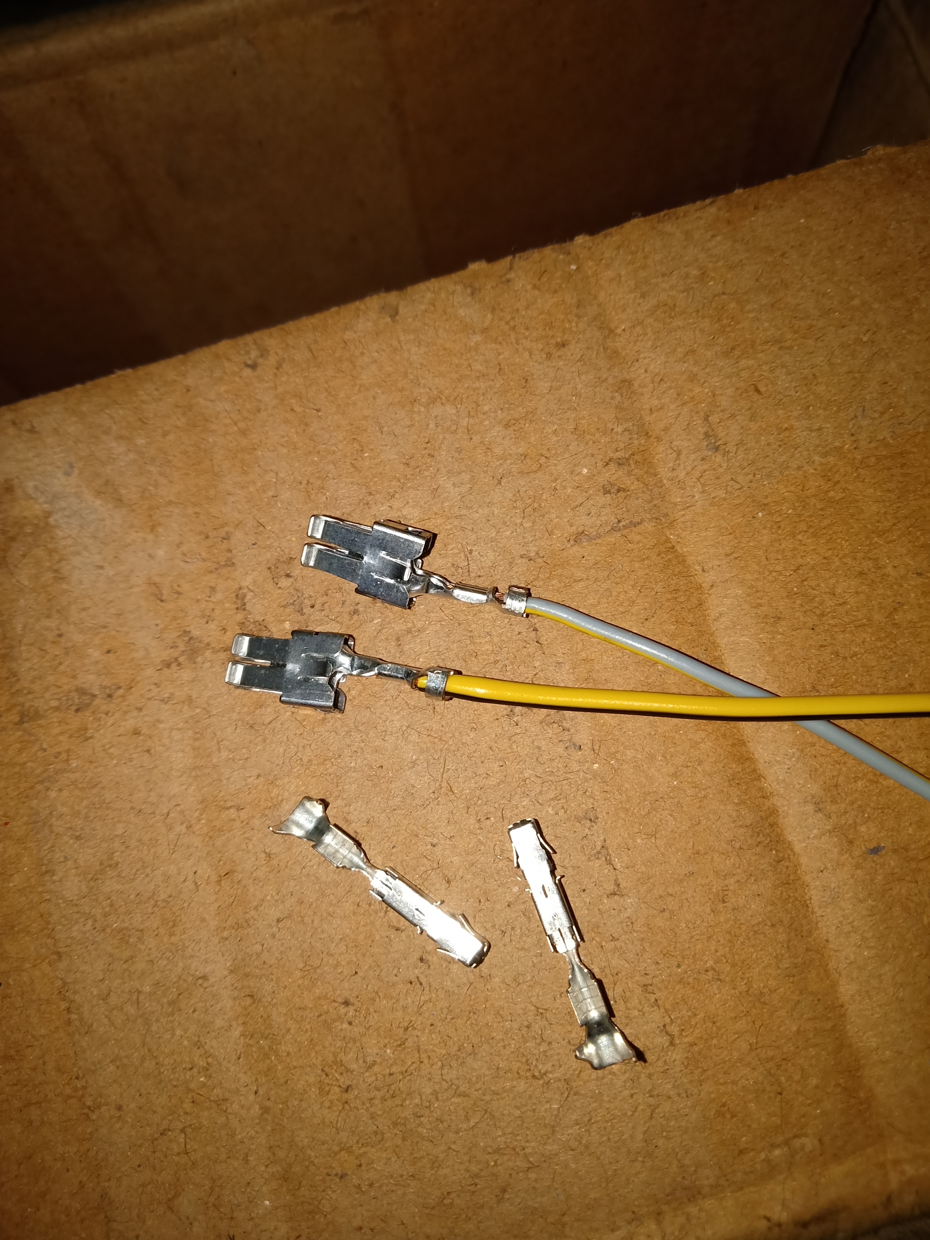

ciclo wrote:I have doubts, maybe I was the one who made the mistake.
I don't know the reasons why those MQS terminals are crimped in those cables.
Please verify again the wires 40a and 41a with incorrect terminals.
No problem for me to send you asap a new BCM-fusebox wiring. (free, of course)

hmthakur wrote: Fri Aug 17, 2018 10:06 am Whats the part no. Of MCP 1.5 ??
Can i get them at vw showroom??
You can get it for free from me.
I'll send you a new wiring for those two cables only - from the BCM to the fuse box -.
Do not uninstall the complete wiring -BCM/Fusebox- , when you receive my cables cut those with incorrect terminals.
I will send them urgently, however it will take 10 to 15 days (SP to IND). :|

hmthakur wrote: Fri Aug 17, 2018 10:15 am
If i keep t73a 40 & 41 as it is for time being can I adapt bcm and start the car ??
What error will it give??
You can not do that. Parking/side lights are mandatory.
https://uk-polos.net/viewtopic.php?f=62 ... 57#p540248
The car will always start.

Send the loom i will keep the car parked. Just wanted to if car will start or not??
Re: Bixenon headlights with AFS For polo gt Tsi 2015
Posted: Fri Aug 17, 2018 10:37 am
by ciclo
You can do the whole process of installation and adaptation of BCM.
The car will start, but you can not drive without parking/side lights.
This afternoon - Spanish time - I will send the new cables.
I'll keep you informed.

ciclo wrote:You can do the whole process of installation and adaptation of BCM.
Ciclo
You don’t send whole loom, just send me the 10 12 pins i will recrimp them
Posted: Fri Aug 17, 2018 11:46 am
by ciclo
I'm sorry, you already have to accept my proposal.
Verified (multimeter) and ready to be sent.
Is the same shipping address as before?
Do you want something more from me that I can send in the envelope you see?

Please send me 5 fuse pins as both broke from loom 1( extender)
Posted: Fri Aug 17, 2018 12:02 pm
by ciclo
Electrical installations are easier and cheaper to do with the right tools.
Do you mean :arrow: 5 JPT terminals? Yes, no problem.

ciclo wrote:Electrical installations are easier and cheaper to do with the right tools.
Do you mean [emoji666] 5 JPT terminals? Yes, no problem.
Yes jpt terminals
My addresses is same
Posted: Fri Aug 17, 2018 1:32 pm
by ciclo
Ok, thank you, I send you 10 JPT. (please be careful when insert/extract the pins/terminals)
I'll keep you informed about tracking number by email.
