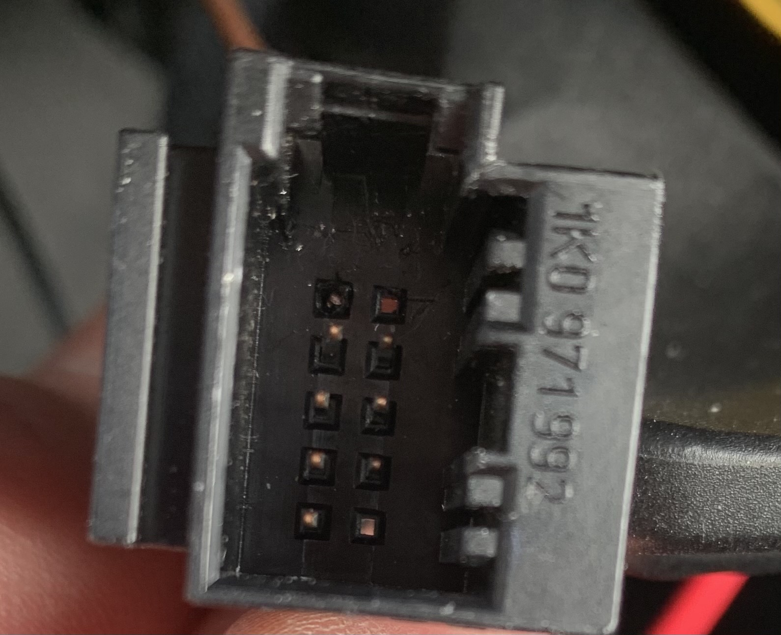

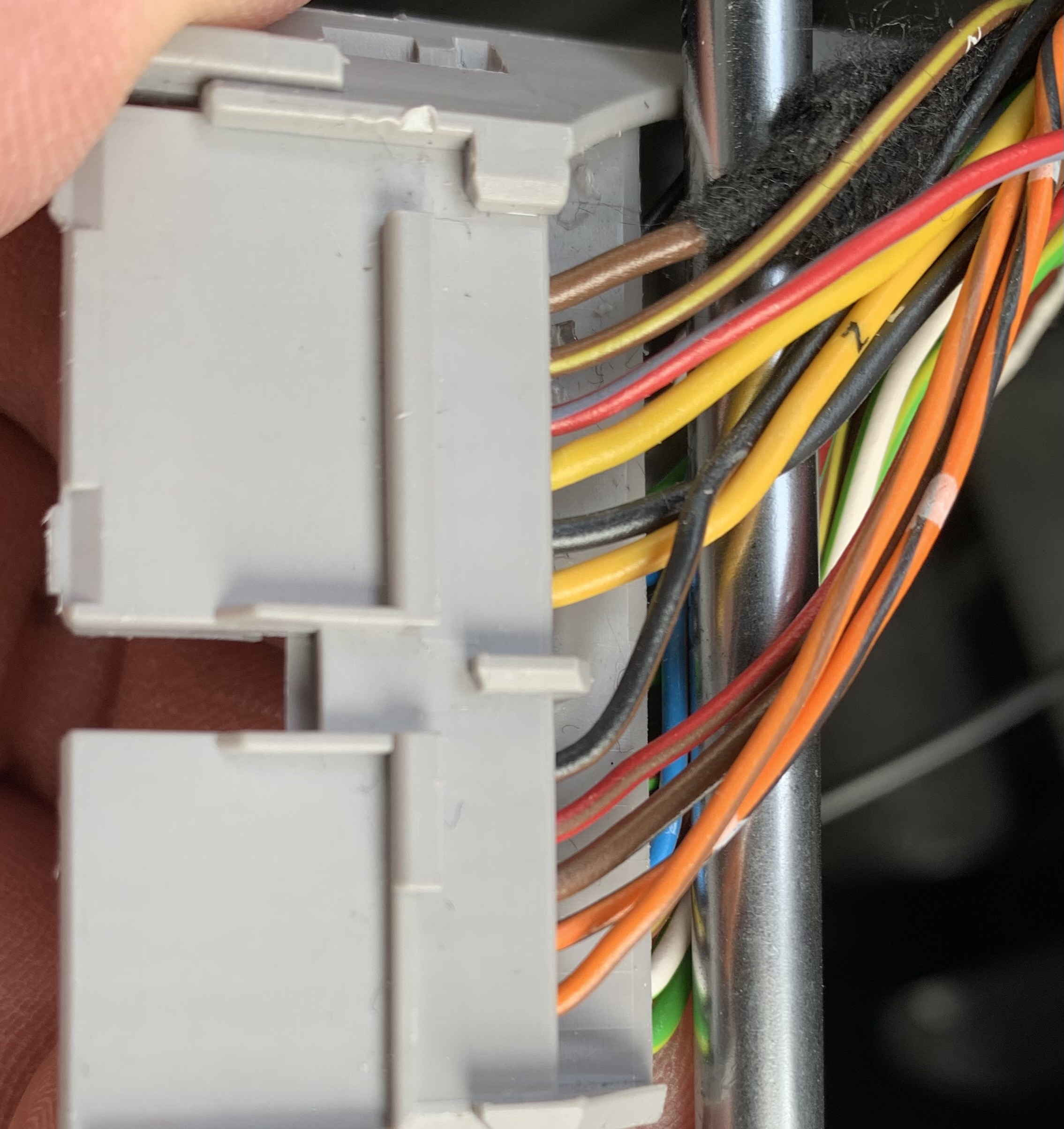

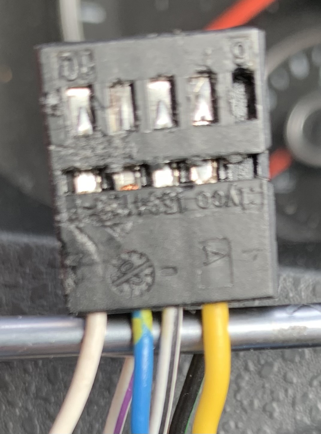

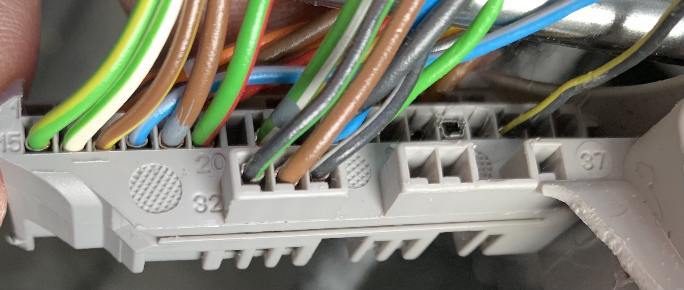

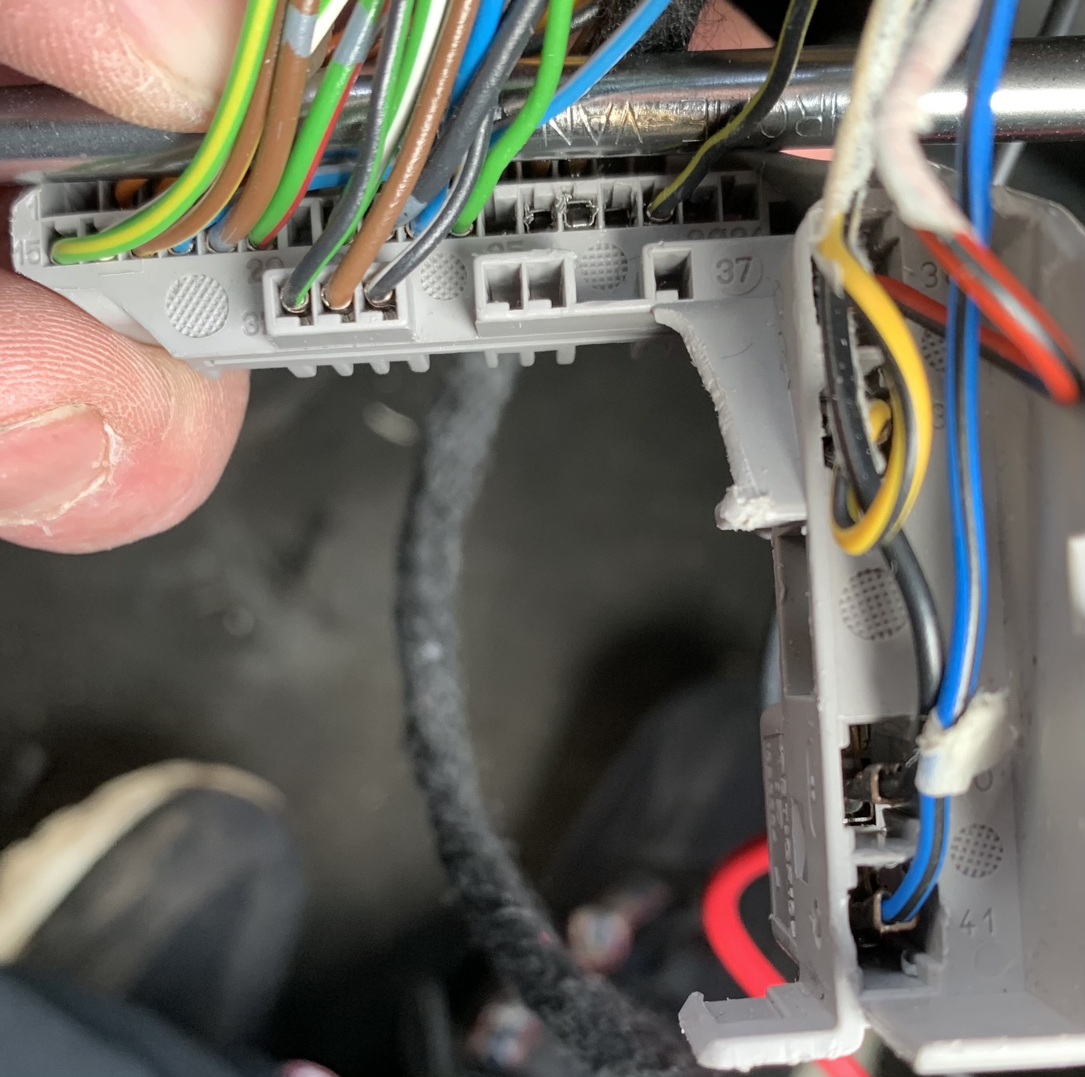

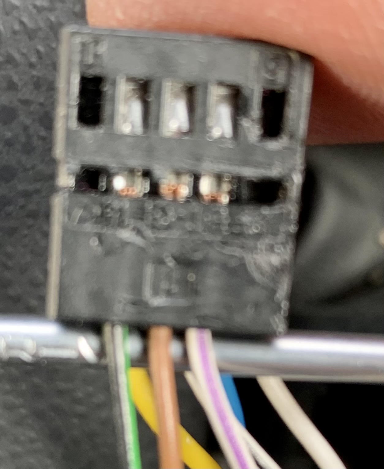

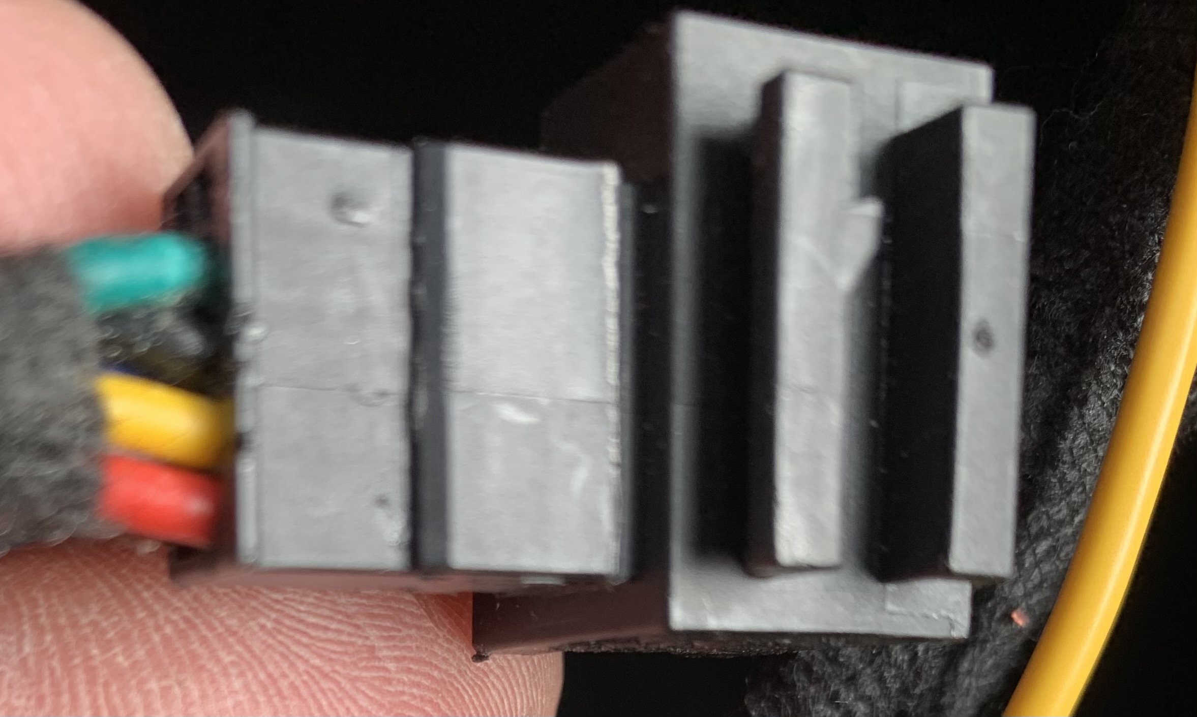

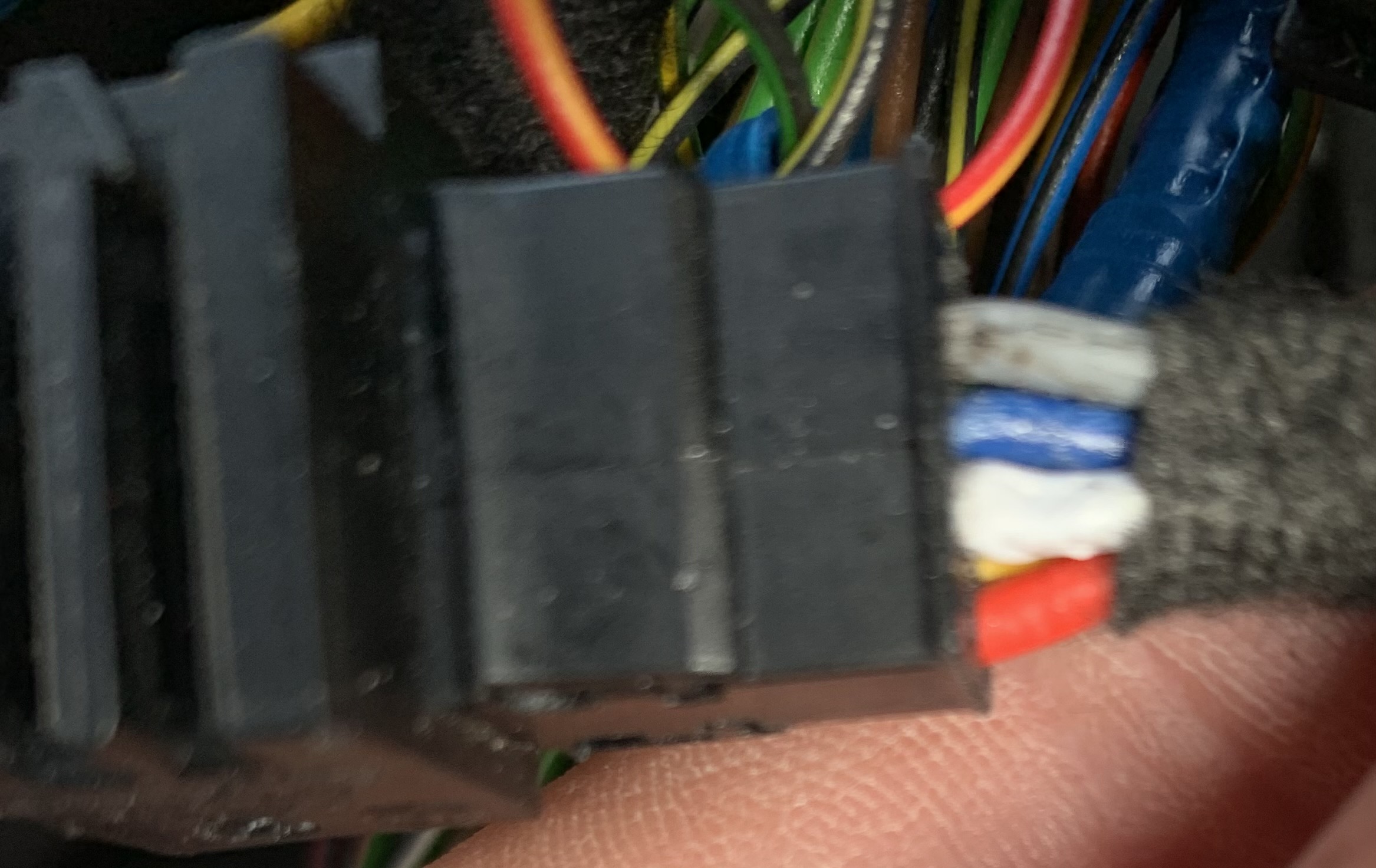

The installation of the CCE requires some explanation. As I mentioned some mistakes happened at my part even dough I am perfect too
The wire colours are not the genuine colours on the 8E0971980 Coupling because the little MQS terminals broke into the T41 connector. It happened maybe my lack of patience
Pin1 - empty
Pin2 is the extra green/black goes to T41/10 LinBus MFSW
Pin3 original Blue/Black
Pin4 original Orange/yellow
Pin5 - empty
Pin6 - empty
Pin7 Yellow to LinBus T73b/17
Pin8 original Blue/Yellow
Pin9 original Blue with yellow stripes
Pin10 original White
Here are some pictures. Sorry some of them a bit blurry
- IMG_0090.jpg (362.21 KiB) Viewed 5375 times
- IMG_0092.jpg (466.44 KiB) Viewed 5375 times
- IMG_0091.jpg (541.03 KiB) Viewed 5375 times
- IMG_0094.jpg (242.89 KiB) Viewed 5375 times
- IMG_0093.jpg (307.33 KiB) Viewed 5375 times
- IMG_0089.jpg (390.73 KiB) Viewed 5375 times

- Posts: 8982
Re: VW T5.1 Caravelle BCM Upgrade
Alex, it is possible to have the automatic function to switch between LB and HB, but it is necessary to install a camera to make it possible.
For the PQ25 the camera is installed in the rear view mirror.
This function is called High Beam Assist or Light Assist.
Related information
... but you already knew this, right?
Returning to the matter, your high beams work perfectly in the Auto position ... manually.

Some MQS terminals on the T41 connector are difficult to remove, or at least have a strange way of being removed.
When the MQS terminals are removed from the T41 slots, the metal retaining tabs on the terminals are jammed a second time during the removal stroke.
It is necessary to use a small hook (L shape) to re-release the tab from the terminal. You can even make this L-shaped hook out of an office clip.
This is the hole where you can insert the hook to release the MQS terminal tab a second time:
I recommend using a flashlight to illuminate the hole in its entire depth and to be able to press on the tab of the exact terminal that you are releasing.

Hi Ciclo,
No I was not aware of the camera unfortunately. It not something I wish to do right now.
I planning to retrofit heated windscreen at some point in the future.If/ when I doing I will consider the mirror upgrade.
I am extremely happy with results as it is right now
May I ask why should we bother with MQS terminals remaining bits removal?
I spent two hours in the morning without a success.
They are not connecting to anything anyway. The stalk does not have any pins for those locations.
I believe the problem is in the wiring of the new connector. I was distracted many times during I was doing that and it is possible that I mixed up some wires.
Is it possible?
It is very strange that the SW lost all functionality and does not lit up at all also the horn operates with the 0/1 button only
I have some wiring diagrams for the T5.1 I will try to identify the wires by colour and confirm whether I put them in a right location or not.
Is it possible?
