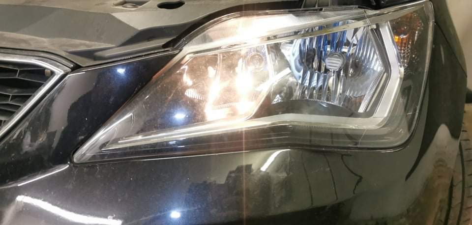

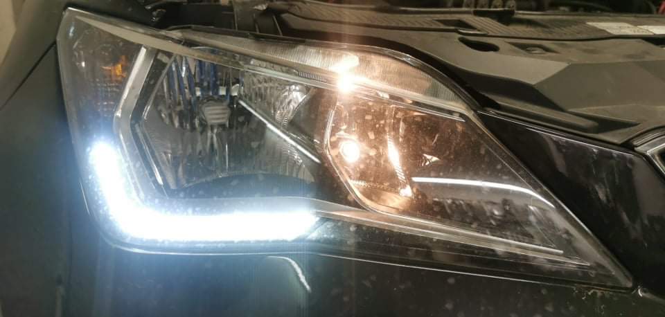

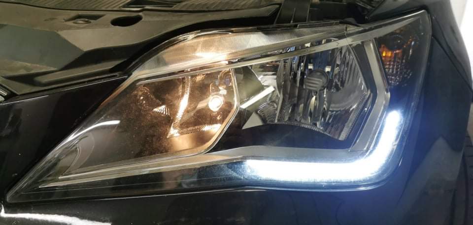

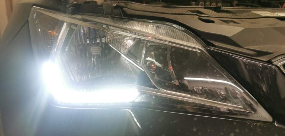

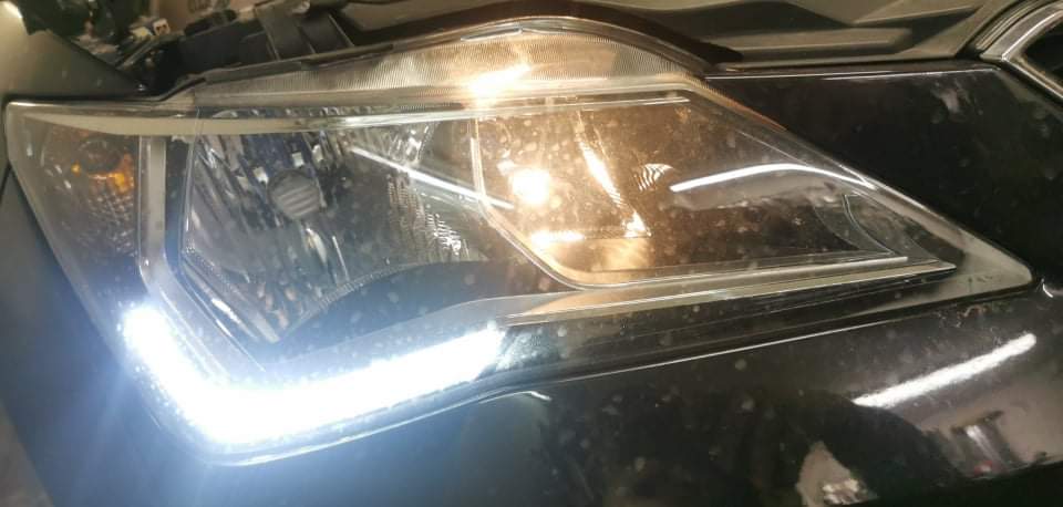

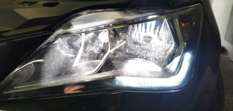

Light switch position:
- 0 = full brightness of the LED module (drl) + parking full brightness
- Parking = Parking lights on, parking brightness dim + full brightness drl
- Low beam (low beam) = low beam on, parking lights dimmed, full brightness of the LED module.
- AUTO:
Lights on = dipped beam on, parking lights dimmed on, LED module full brightness.
Where is problem? I don’t know 😪

Posts: 8988
But, what BCM coding are you referring to?
Maybe it is better that you take pictures in a garage and in daylight conditions, because due of how your 6P halogen headlights with LED drl are built, it is possible that everything is working well...
Please show with pictures what's the problem. Make a comparison.

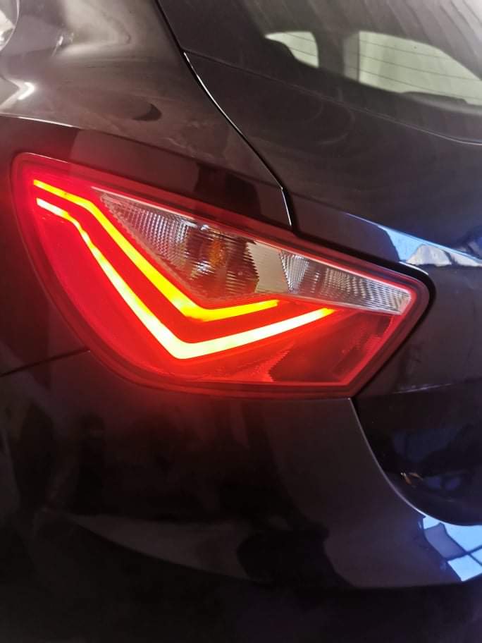

What is the operation of your rear Parking lights in these conditions ...

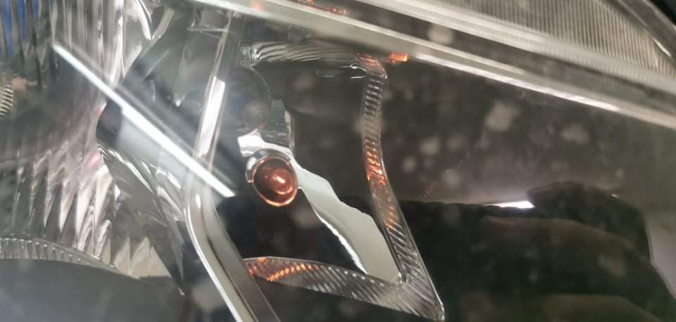

Due to the behavior of the lights, it seems that, maybe, the two new cables that go to each headlight have been swapped of position in the T10 connector.
Posts: 8988
It is impossible to understand with total clarity the images if you do not add a comment with each one of them.
I am not an expert on halogen headlights, and even less so on SEAT halogen headlights.

ciclo wrote: Wed Nov 10, 2021 1:20 pm It is impossible to understand with total clarity the images if you do not add a comment with each one of them.
1.3 position 0
2 parking position

ciclo wrote: Wed Nov 10, 2021 1:14 pm Due to the behavior of the lights, it seems that, maybe, the two new cables that go to each headlight have been swapped of position in the T10 connector.
I do not have physical access to the car, the electrician says that when I replace the cables, the DRL goes out and throws an error

ciclo wrote: Wed Nov 10, 2021 1:04 pm What is the operation of your rear Parking lights in these conditions ...
Rear parking lights sparkle at full power
By replacing the cables T10 / 4 -> T10 / 10. LED lights + dimmed parking, parking with full power, the LED does not light at all
Posts: 8988
I have a feeling that the procedures are not being carried out the right way. Installation and coding are paired in a deep love, if any change is made in the electrical installation it must also be done in the coding.
