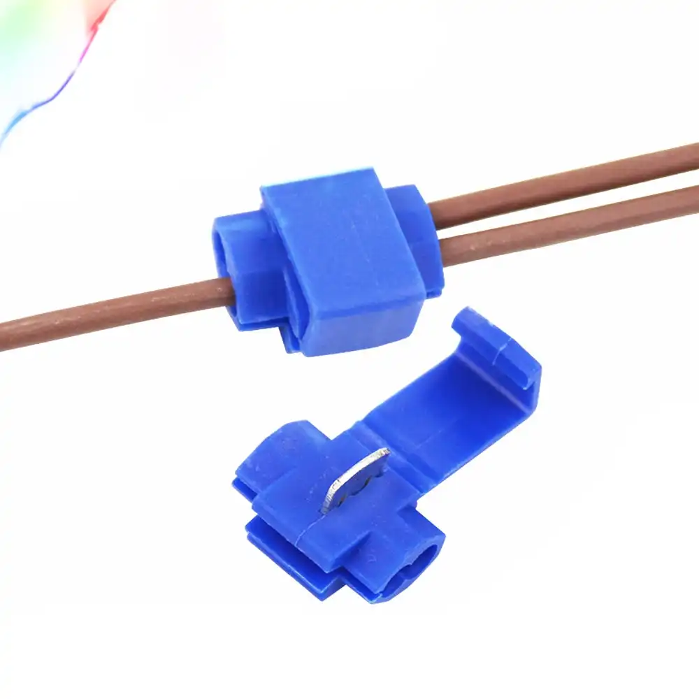

It is recommended to use scotch locks/splices like this to connect the wires:
