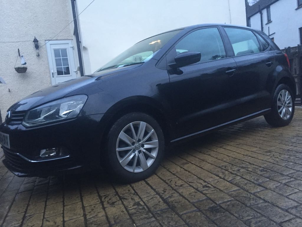

some pictures of your car so we can determine the type would be great. we always like pictures.

Ok mate I'll try and post one now :-)

Not the best pic but it's the only one I have atm.
It's a 64 1.2 tsi se bluemotion
Posts: 6687
Re: New polo owner looking for some help.
so you have a nice Polo 6C (facelifted 6R) and your engine has a timing belt. you'll probably need 5W30 oil with VW longlife spec
