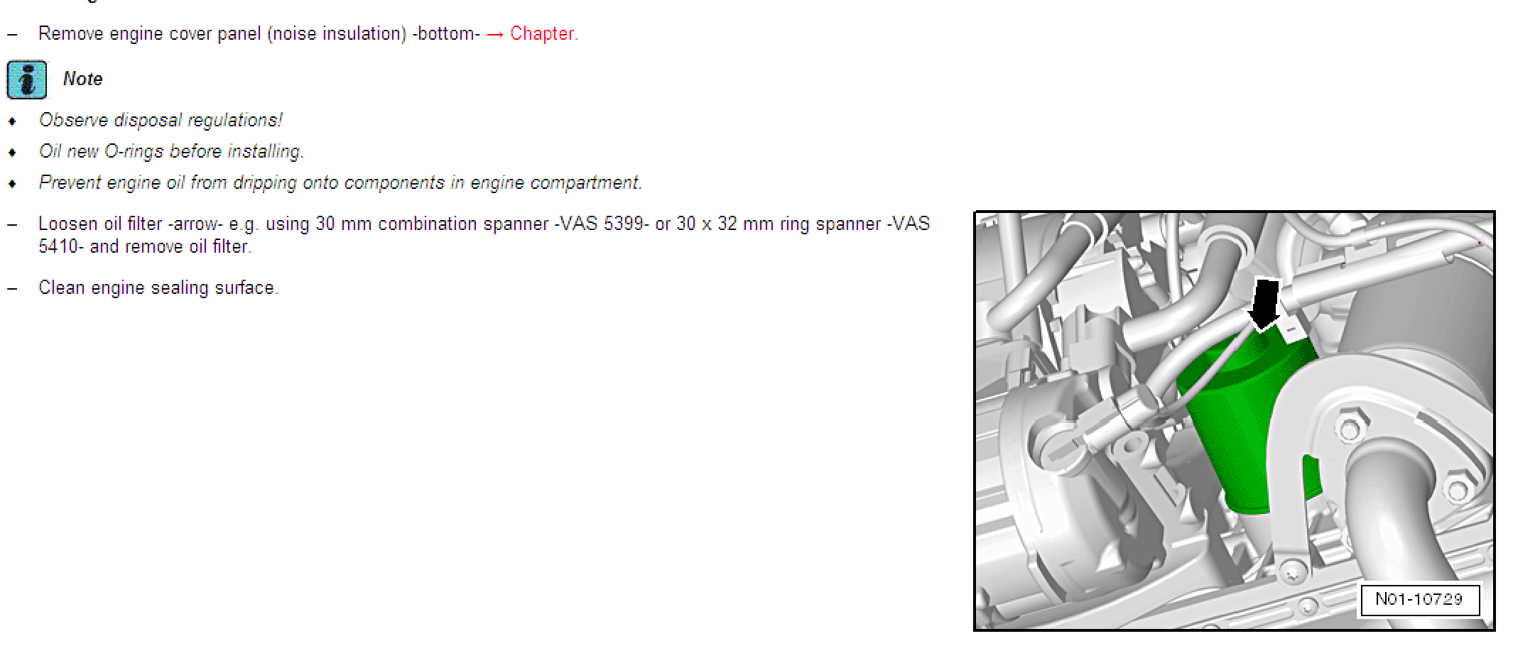

best i can find

Thanks but I don’t even know where to look for that. I’m guessing it’s not in the normal engine Bay Area? Any more help from anyone else (no offence to the guy who posted the diagram) would be appreciated

On that engine maybe quite difficult to find, it is down the front of the engine block, just above the level of the sump and just to the right of the back of the alternator.
It has a hex end on it to make removal easier.
Not the easiest of filters to remove and fit without spilling oil and getting cuts on your hands/arms!
Edit:- that "item" under the triangle part is the engine mounting, you don't want to go and take that off!
Tip:- as it seems like you don't know very much about engines, without being nasty, maybe buy a Haynes Workshop Manual for that car and start learning how to carry out some of these tasks.
Another Edit:- the section from the official workshop manual that iichel posted does show that the filter is located behind the AC compressor not the alternator as I said above, though it does need to get lifted up past the rear of the alternator to get it out of the car. That picture clearly shows where it is located wrt the exhaust down pipe as well.
