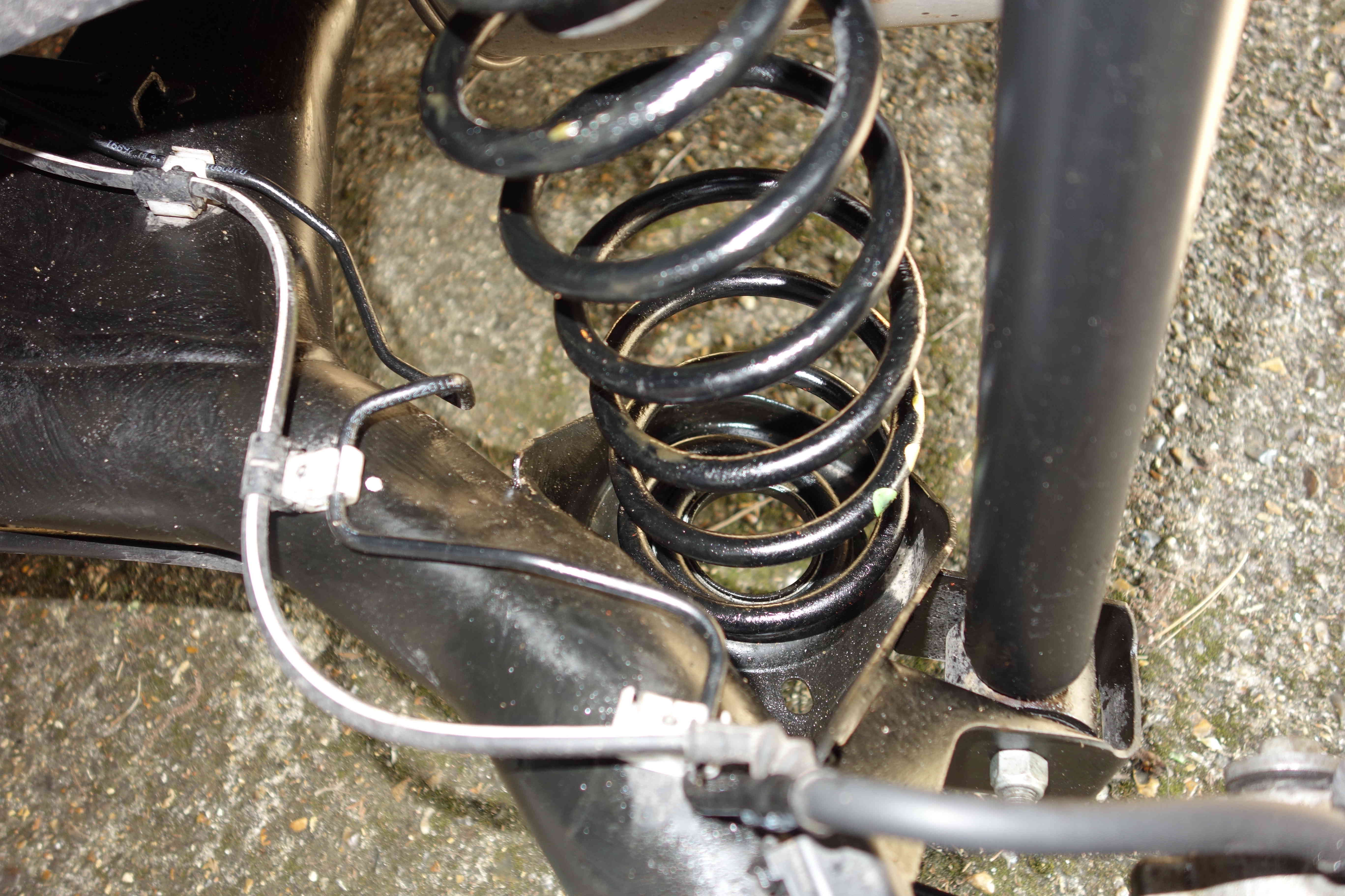

Here's what my rear coilspring setup looks like:

I have not checked the parts listing, but certainly in earlier models way back to the start of 9N type back in 2001> there has always been an aluminium ring in there. Typically it will not be possible to see this - though maybe on your car veteran as it is still newish and low milage, if you look up in through the hole on the lower spring cup, you might just make out the edge of that aluminium ring - or be able to spot some white dust as that ring “disolves” !
Edit:- it could be that that is showing grey/silver at the base of the spring in your picture.

Your spring assembly looks allright to me veteran

Before posting that pic I magnified it to max to look for any remote sign of a separate ring of any kind. But there's nothing obvious there. That whitish annulus you mention, RUM, is more likely to be, in my case, just dried remnants of contaminants.
I'll be getting underneath the rear of the car probably during the coming weekend, weather permitting, and I'll try looking at the 'seat' from a different angle. Maybe there is a ring or a very thin bush of some kind there but that it's almost wholly covered over by the coil end?
You suggest that it's likely to be made of aluminium and, as you say, RUM, allowing aluminium to mate directly with steel is, from the standpoint of corrosion pertaining to different base metals, normally a complete no-no, especially for surfaces that will be moving against each other. In this particular case, it would lead to disintegration of the aluminium component (but obviously not as rapidly as inferred by the young age of my Polo!).
I'll in due course post some further pics of the bottom end of the spring, so do return to this posting over the forthcoming days and week.

I've checked up on what Haynes shows in that area, I agree it shows nothing, but if you consider that Haynes seem to have been using a Polo 6R that had quite a few miles under its belt, and when you consider that I've already said that that ring washer is made of aluminium, and surrounded on both faces with steel - okay initially painted steel, then I'd guess that on that car that was the subject of the Haynes manual, that that ring washer had "left the scene" - turned into the white dust I was referring to.
I might just be wrong here, but I think if you ask anyone that has replaced rear springs on a Fabia/Polo/Ibiza that was roughly 8+years old, they will not have spotted any ring washer in that location - and I'd guess that most of them do not believe that there was ever a ring washer in there - but there was at one time.
If you look at your picture zoomed - and you consider that the hole on the lower spring cup has raised sides to help locate the spring, looking that the end of the spring you will see silvery/greyish showing, as I said, that is the aluminium ring washer, P/N 1J0512109 and called UNDERLAY, so this part has been in use on VW Group cars for quite a long time, maybe even initially on a Golf!

I think that your car's "UNDERLAY" (the word VW use in the parts listing) had already disolved due to the action of water + salt + dissimilar metals being in contact with each other.cheba wrote: Sat May 26, 2018 5:33 pm I cannot remember seeing any kind of bushing or ring when I removed my rear springs when changing to a Bilstein B14 kit last year on my Polo (built late 2013).
It will have had that part fitted during initial assembly.
Edit:- cheba, I'd think that not seeing/finding a washer in there would not surprise me as you like me at the time, were not expecting to find one there, it was only after trying to work out why there was white dusty deposits there that I looked up the parts listing and discovered that there is meant to be a washer in there. As my car had just failed its MOT test for 10>15mm missing off the end of one rear spring, my urgent action that day was to buy two new springs and fit them - and after passing the MOT getting round to investigating any other issues like ordering in 2 new bottom bolts and 2 new washers (UNDERLAY in VW language).
