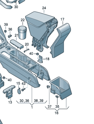

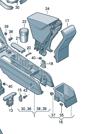

I took a look for part number and it should be:
number 17 - 6F0863289
number 24 - 6F0864207
look like easy swap, just take out that tray (16) and bolt in arm rest (nuts should be already there if not it is M6 nut) than push that back cover on
//EDIT:
some one at seat forum already did this swap and posted whole list of needed parts:
//EDIT:
https://forums.seatcupra.net/index.php?threads/anyone-ordered-yet.439499/page-10
1 x 6F0863289 82V - Frame Titan Black
1 x 6F0864207 LI8 - Armrest Titan Black
2 x 6F0863513A - Retainer for centre console
2 x N 91079901 - Hex Collared Bolt
2 x N 01508210 - Hexagon Collar Nut
