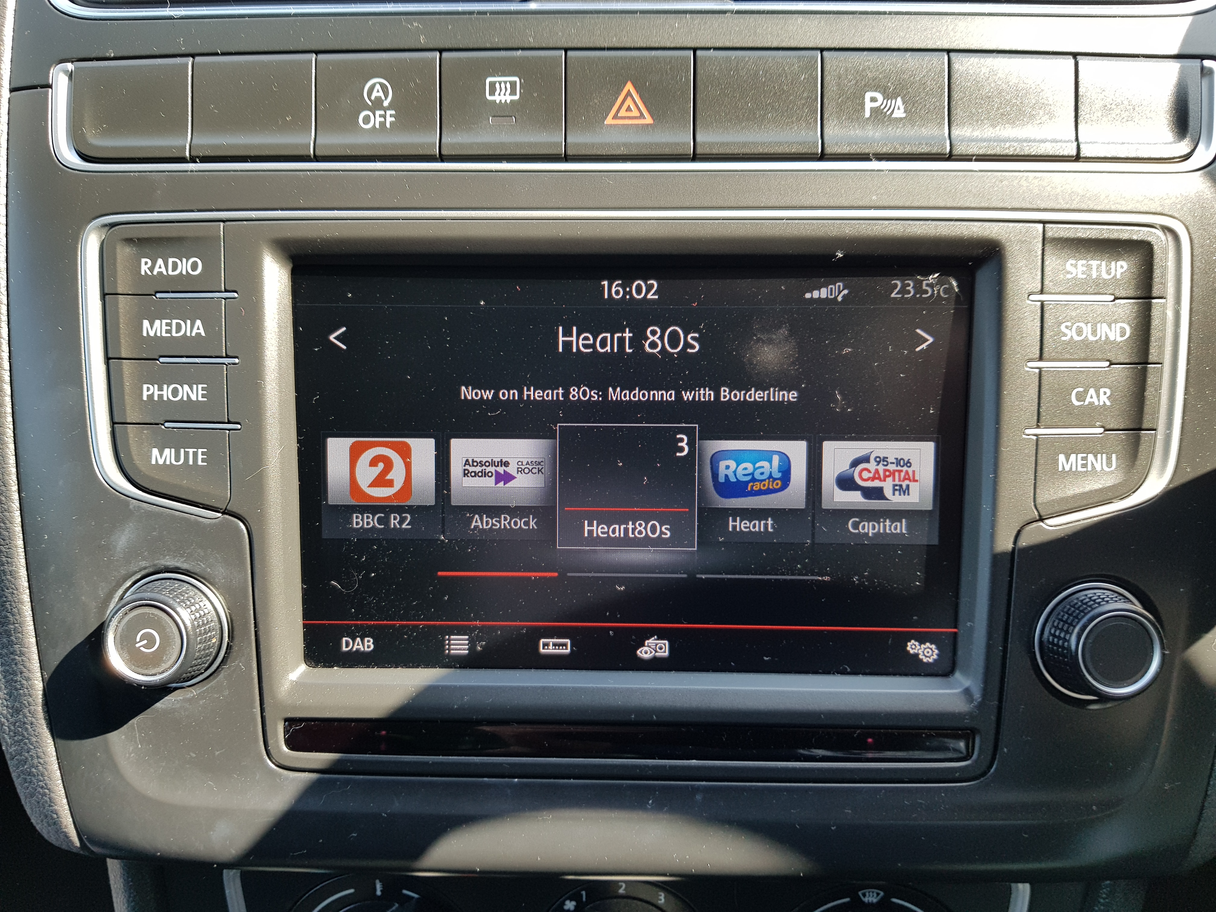

Here's a pic of my composition media unit.

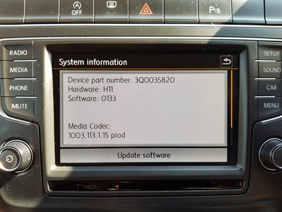

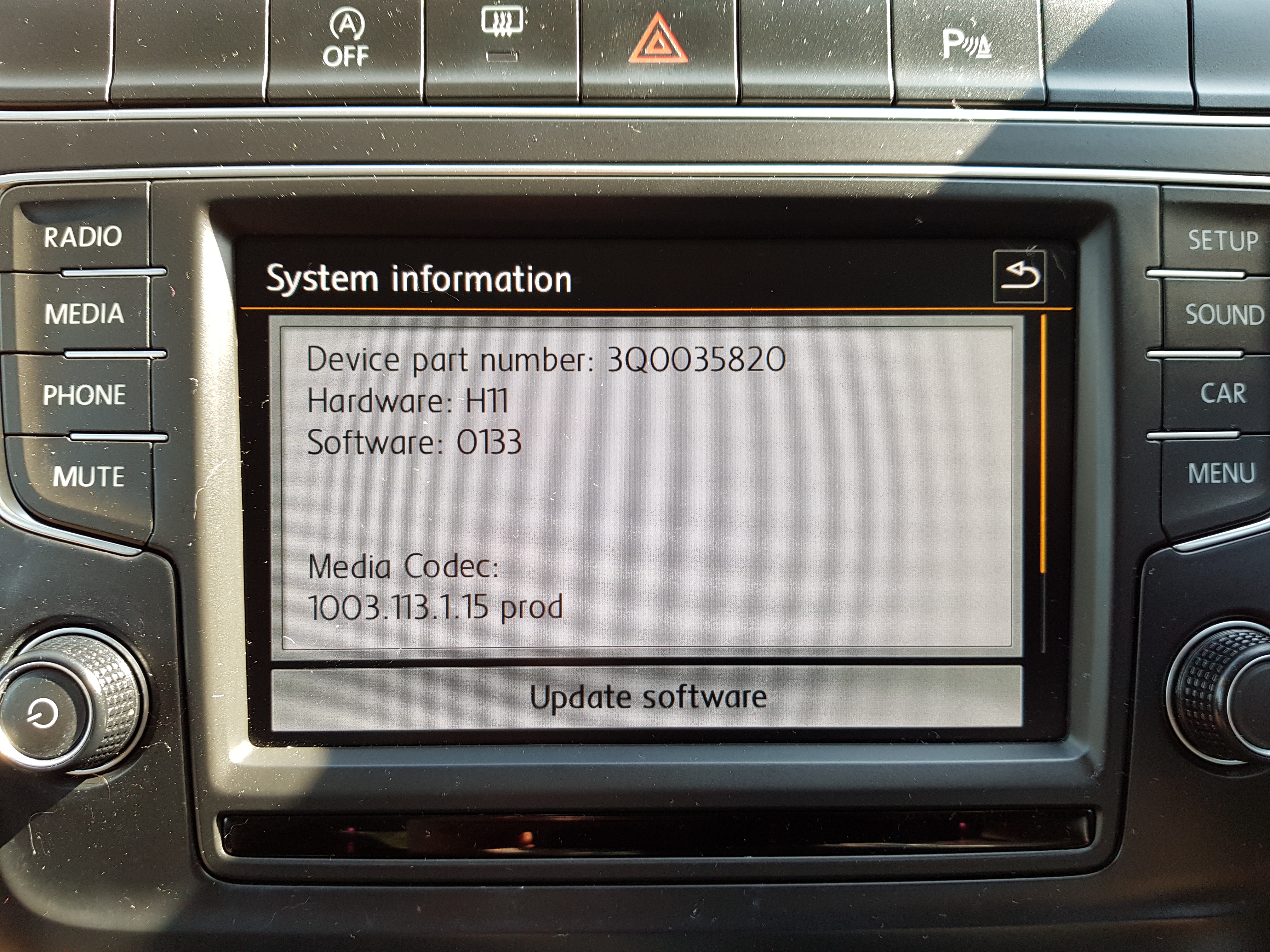

And in the set up function I found this info

Yes a composition media will take a badge RVC, like from Golf 7, but you'll need an adapter.
Complete set here: http://www.carsystems.pl/vw-rear-emblem ... d1214.html
