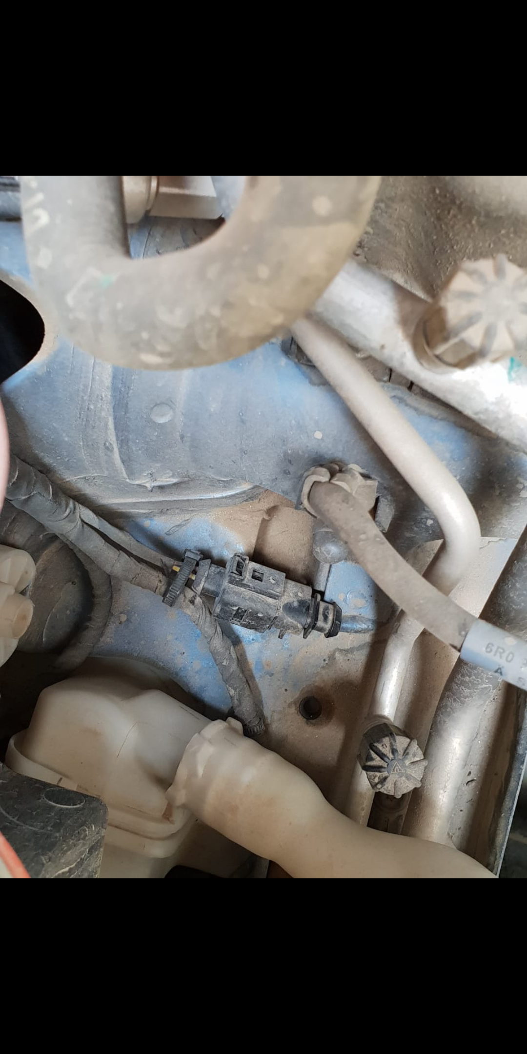

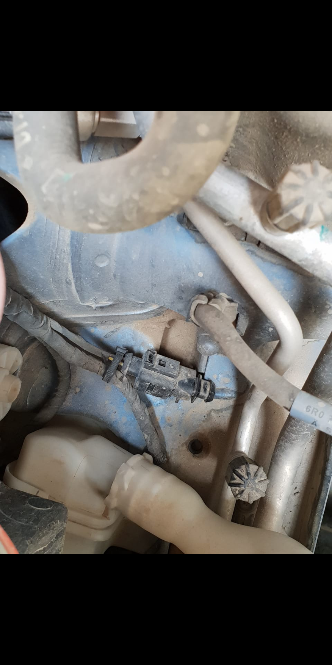

Hi iichel, i have worked on so many polos without foglamps in india. In all cars i have found that foglamp wiring is already there till below the headlight. From there onwords we can get 2 pin female socket and h8 male extender from vw. Vw sell that wiring as incase of accident if fog lamp connctoer is broken then change that wiring. Best way to check is remove headlight switch connector and see if there is wire in pin number 8 or not. If wire is there means fog lamp wiring is also present.iichel wrote: Tue Jul 17, 2018 10:58 am Yes, for fog lights without BCM control (no cornering lights) you'll do the following:

Thanks for your comment. Yes, I'm aware that these wirings are often present in the Indian VW Polos. However, in the EU spec, VW is known for nut putting a mm too much of wiring into the car and I don't expect the wires to be present in this English VW Polo RHD.

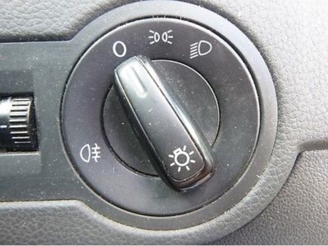

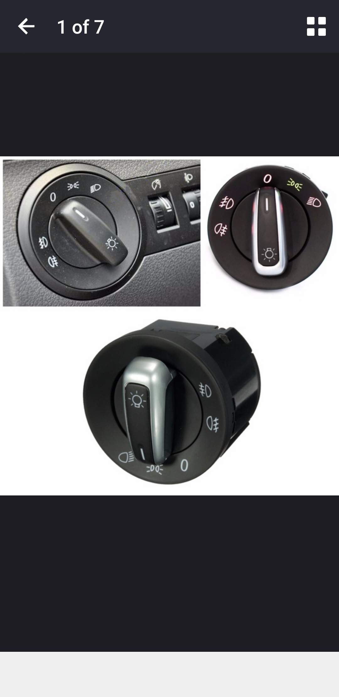

This is the switch I have currently..
But is this what I need?.. Or is it the auto lights one haha
- Posts: 6695
Re: FITTING FOG LIGHTS TO MY 6R 2010??
No that seems to be the right one. Make sure you find one with the 17-pin connector and it will also depend on how your DRL's are controlled.
