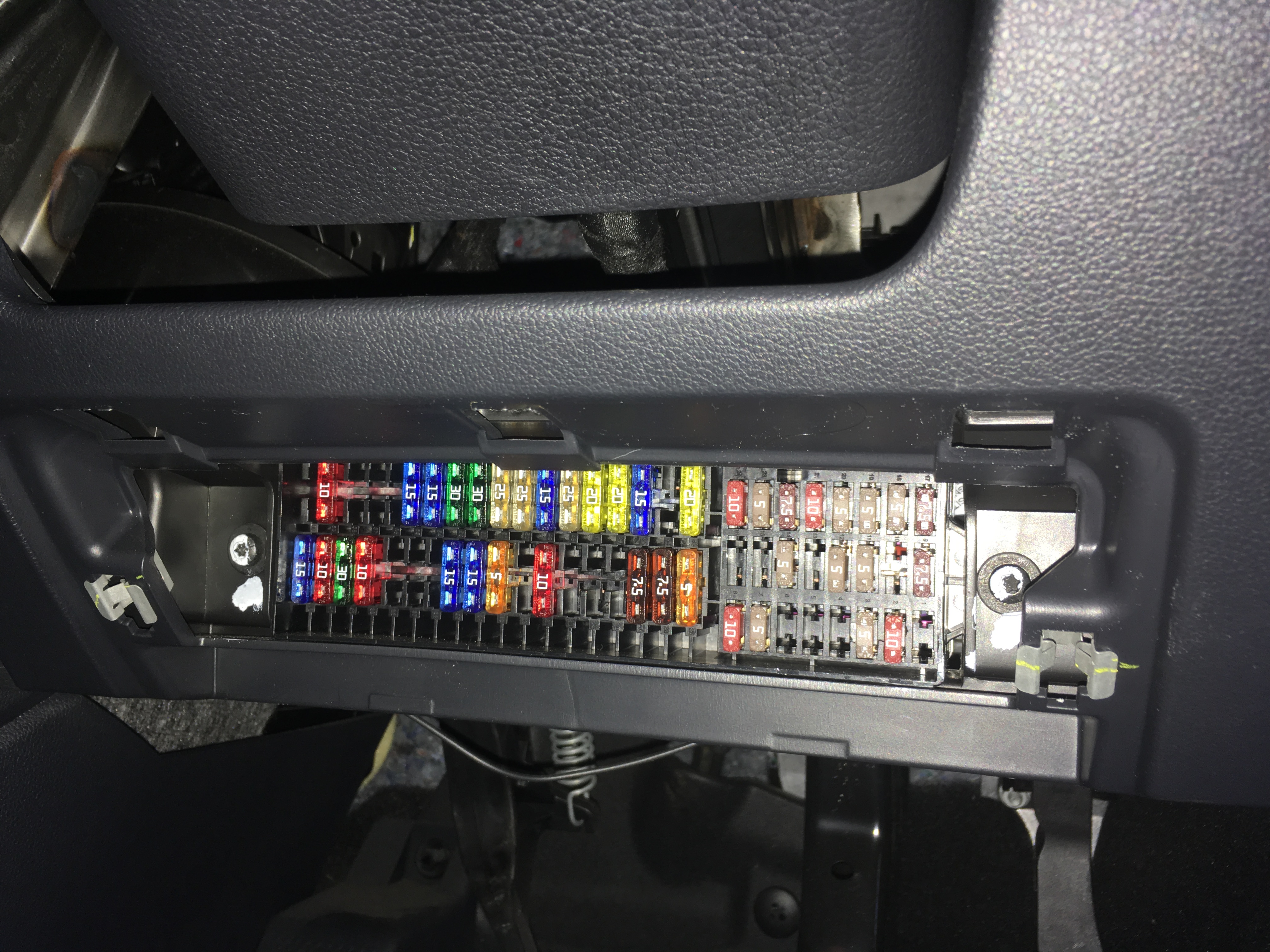

Hello
I have a 2012 Polo 6R and i have routed the cables for the front and rear dashcam. But I'm not sure which fuse to use for an an always on power supply. The dashboard camera has a parking mode, hence why I'd like to have this feature.
Exact mode: 1.4 Match Polo 2012 (62 reg registered in October 2012)
My dashboard camera is:
https://www.amazon.co.uk/gp/product/B07 ... UTF8&psc=1
and I am using the following hard-wire kit
https://www.amazon.co.uk/Hardwire-Charg ... GFX5AMQYDH
Here's a photograph of my fusebox. I have a multimeter, and the three different types of fuses with adda on fuses.
I'd be really grateful if someone can point out the obvious as I can't figure it out.
Thank you
Photograph of fusebox:
Please visit the link: https://i.imgur.com/ByWHh2o.jpg as it's high res and I have also attached it

If you'd like to take a permanent live, I'd suggest the empty slot at fuse 44.
You can see a full overview of all the fuses here: https://uk-polos.net/viewtopic.php?f=56&t=71052
The ones with terminal 30 in the most right column are permanently live.
