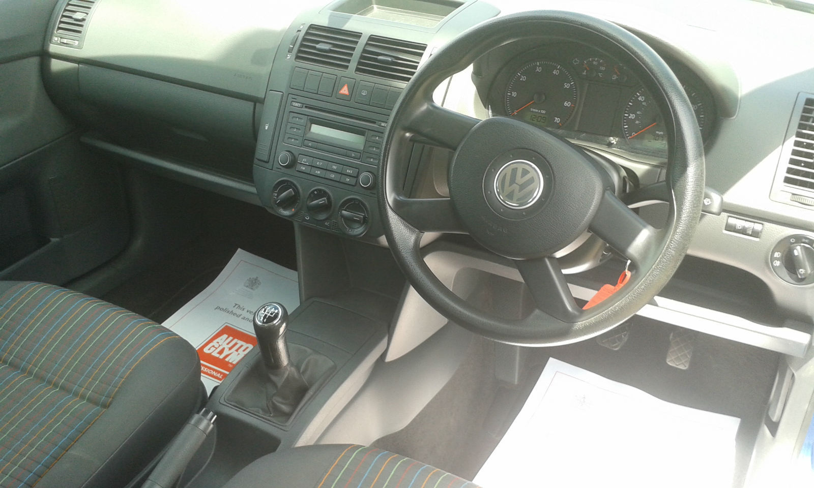

bit of advise needed just got my daughter a 2005 9n3 1.4p s 75 16v
Central locking help , its only got one normal type key that unlocks the central locking on handle lock and starts car , how can i find out if its suposed to have a remote central locking fob as i believe some dont
stereo help , car has a RCD200 stereo that works fine but want somthing factory looking with aux in and maybe usb ( will try and add a pic below ;-) )

The S doesnt have remote central locking - youll need to install a kit to make it remote central locking. Rclick.co.uk do some very good kits, and theres an install guide at the top of the DIY Guides section on the forum
Stereo wise, get something newer is the easiest option. A Pioneer SPH-DA120 is a very good choice :)

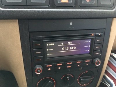

i was looking at the RCN210 stereo as it looks the same but has the aux and usb , was looking at others but as the orignal has sharp corners as the aftermarket ones ive seen have rounded corners so unsure about them fitting properley

The RCN210 would work, so that would be a good option
All aftermarkets come with fascias for the corners. This series of polo uses a standard double din so single or double din aftermarket radios will fit without issue.

Yep the RCN 210 is a perfect fit more than happy with mine

The RCN210 was a good option for me also a polo 9n3

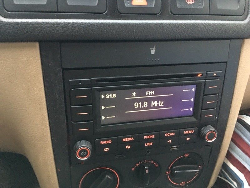

https://www.ebay.ie/itm/Car-Radio-RCN21 ... 363b18181f
Has micro SD card Slot USB slot Aux in + bluetooth

i like the stock look of the RCN210
so will i need a the can bus simulator or quadlock adaptor ( have the factory RCD210 )

You will need both the quadlock adapter and the canbus simulator
The quadlock cable converts the existing volkswagen square connector into an ISO which the new radio RCN210 uses
the can simulator plugs into the ISO harness then into the back of the RCN210
I think the can simulator is to provide permanent live & prevent battery drainage issues ( I could be wrong though )
There are two wires from the quad adapter to be connected to the cigarette lighter 12v+ as a switched live and an orange cable that goes to the illumination around the ciggy lighter
and when the lights are on the radio display dims and the orange backlighting comes on
The fakra aeriel connector on mine ( rcn210) had a little silver attachment plugged in to it so I just pulled this out and the harness adapter fitted perfectly
i think there was 1 wire left unconnected ( maybe blue ) I think this may have been for a powered aeriel but again open to correction :-)
