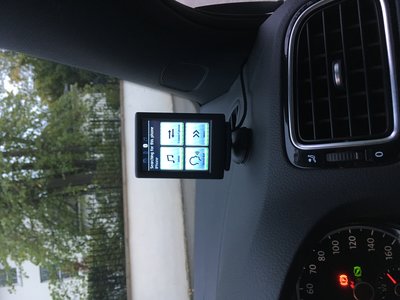

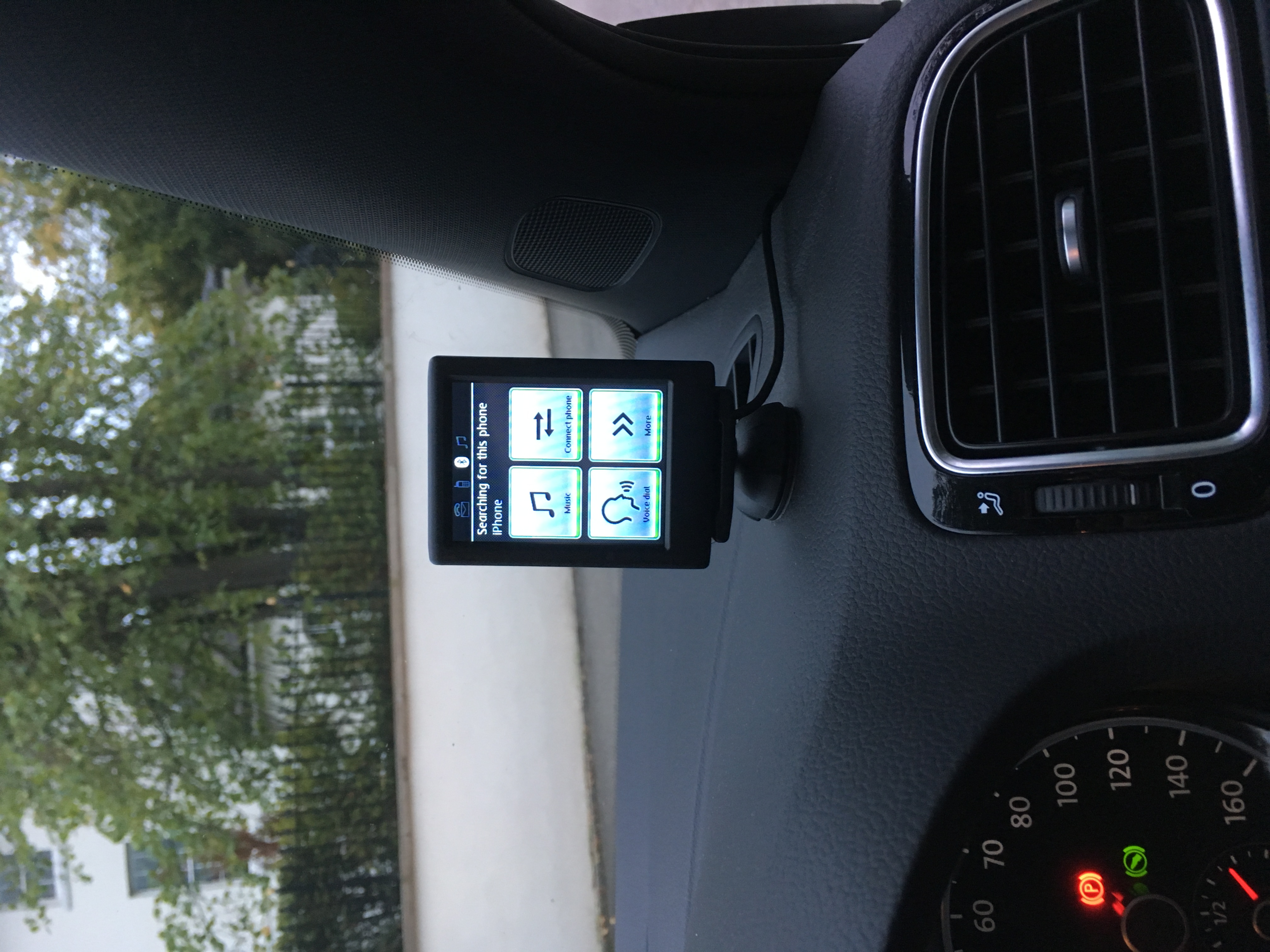

This is the bluetooth kit which is rubbish for playing music through. I need to look under the seat again.

maccap wrote: Mon Oct 08, 2018 7:14 pm This is the bluetooth kit which is rubbish for playing music through. I need to look under the seat again.
Oh OK, I thought you meant that the touch display thing was mounted in a Bury phone cradle/adapter on the dashboard (on the passenger side of the center console). Some cars have this cradle, and it is a sign that the car has Mobile Phone Preparation.
maccap wrote: Mon Oct 08, 2018 7:31 pm Just had another look under the front seats and there is nothing except for a voltage stabilizer. I confirmed this by partcode.
It seems like the car doesn't have Mobile Phone Preparation from the factory then. I think the little touch display thing is a kit for dealers to install if the customer wants to retrofit Bluetooth, but I don't know what kind of functionality you get with it.
