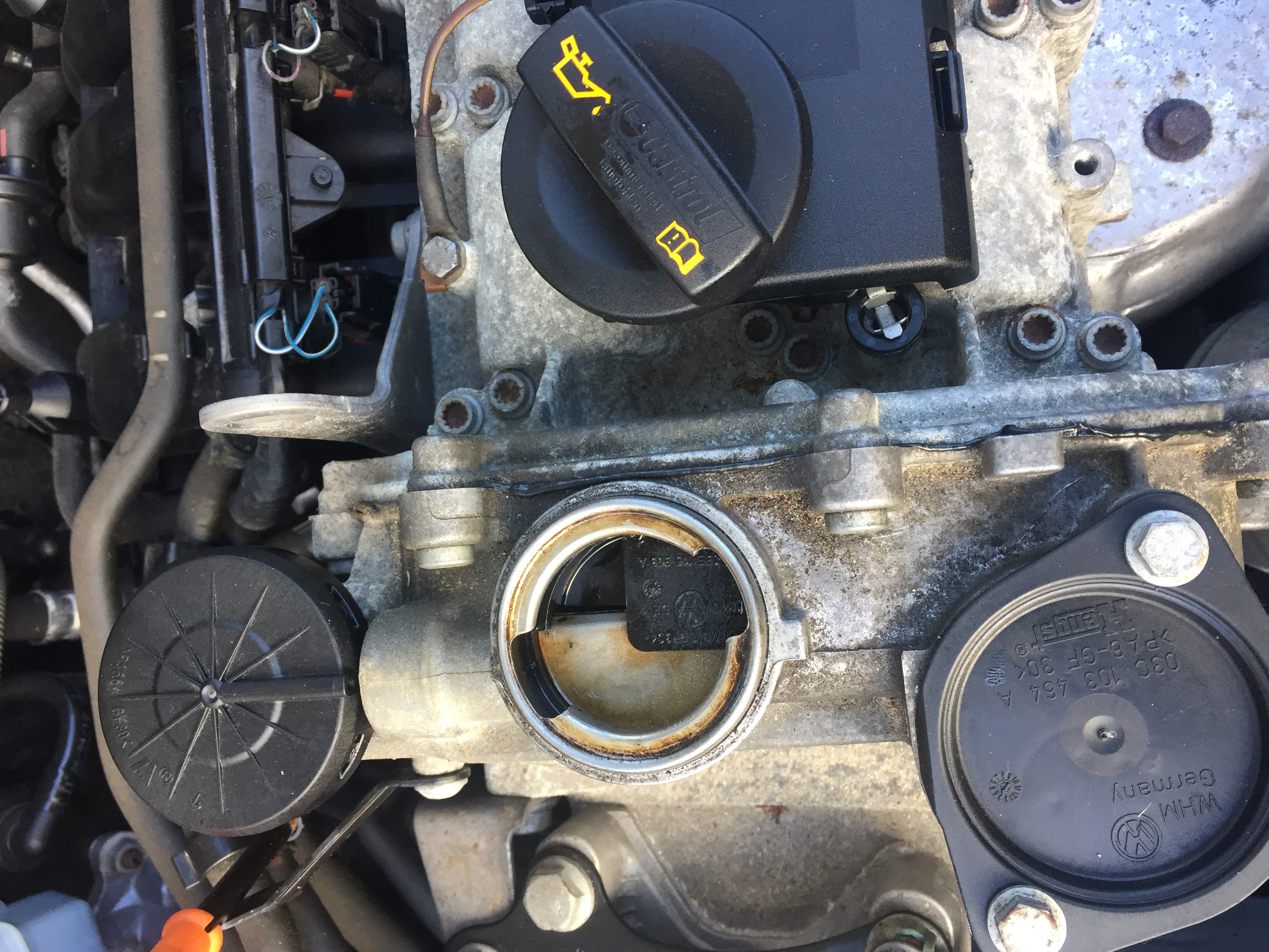

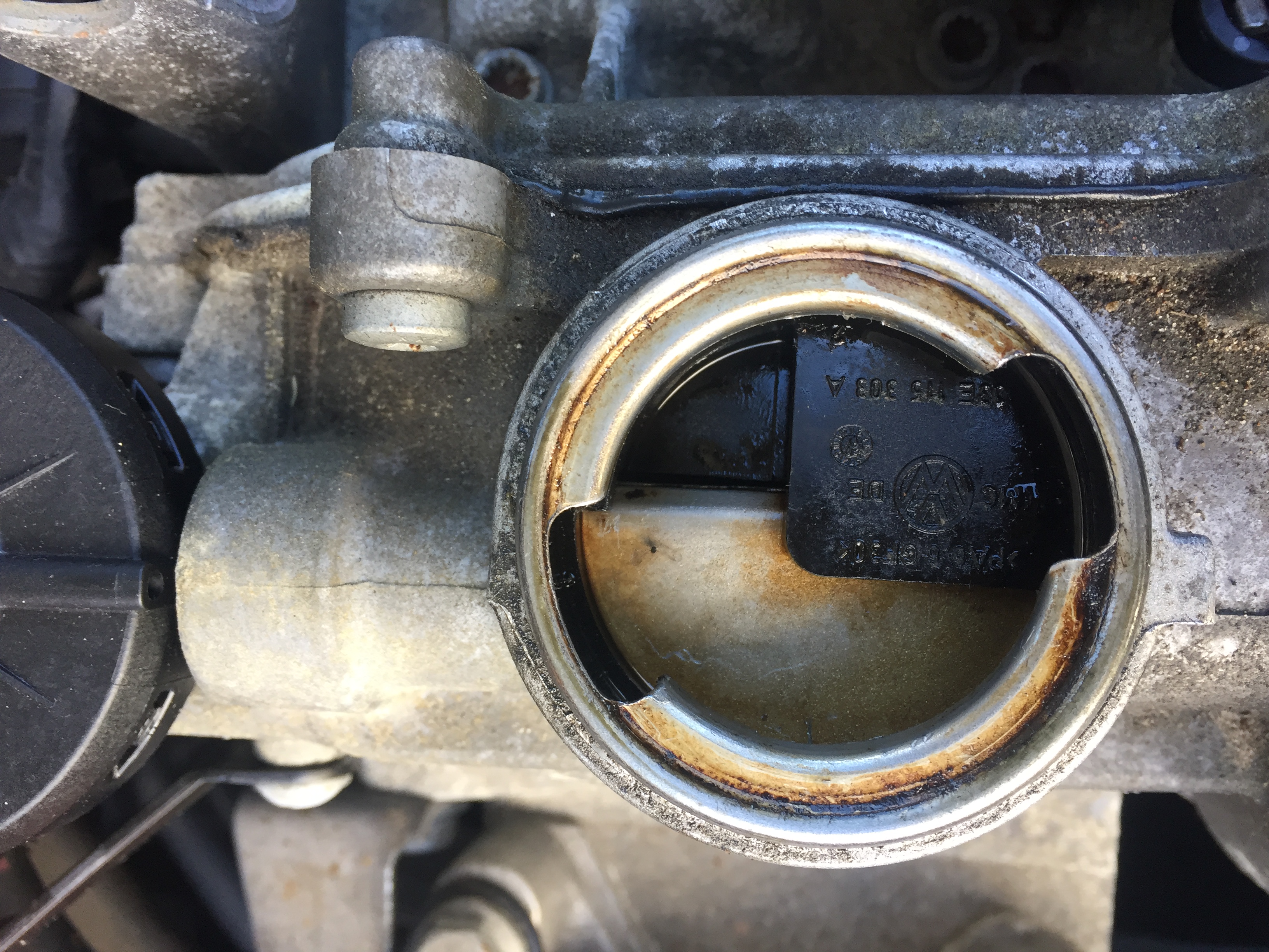

What is this below oil filler cap and how do I get the oil in vw polo 1.2 2012

Re: What is this below oil filler cap and how do I get the oil in vw polo 1.2 2012
That is probably just deflector shields to stop the oil being thrown up against the base of the filler cap because that is what that black cap with the oil can is, with the engine stopped running, remove that black cap and pour oil in if necessary, it will run down past these deflector plates/shields.
