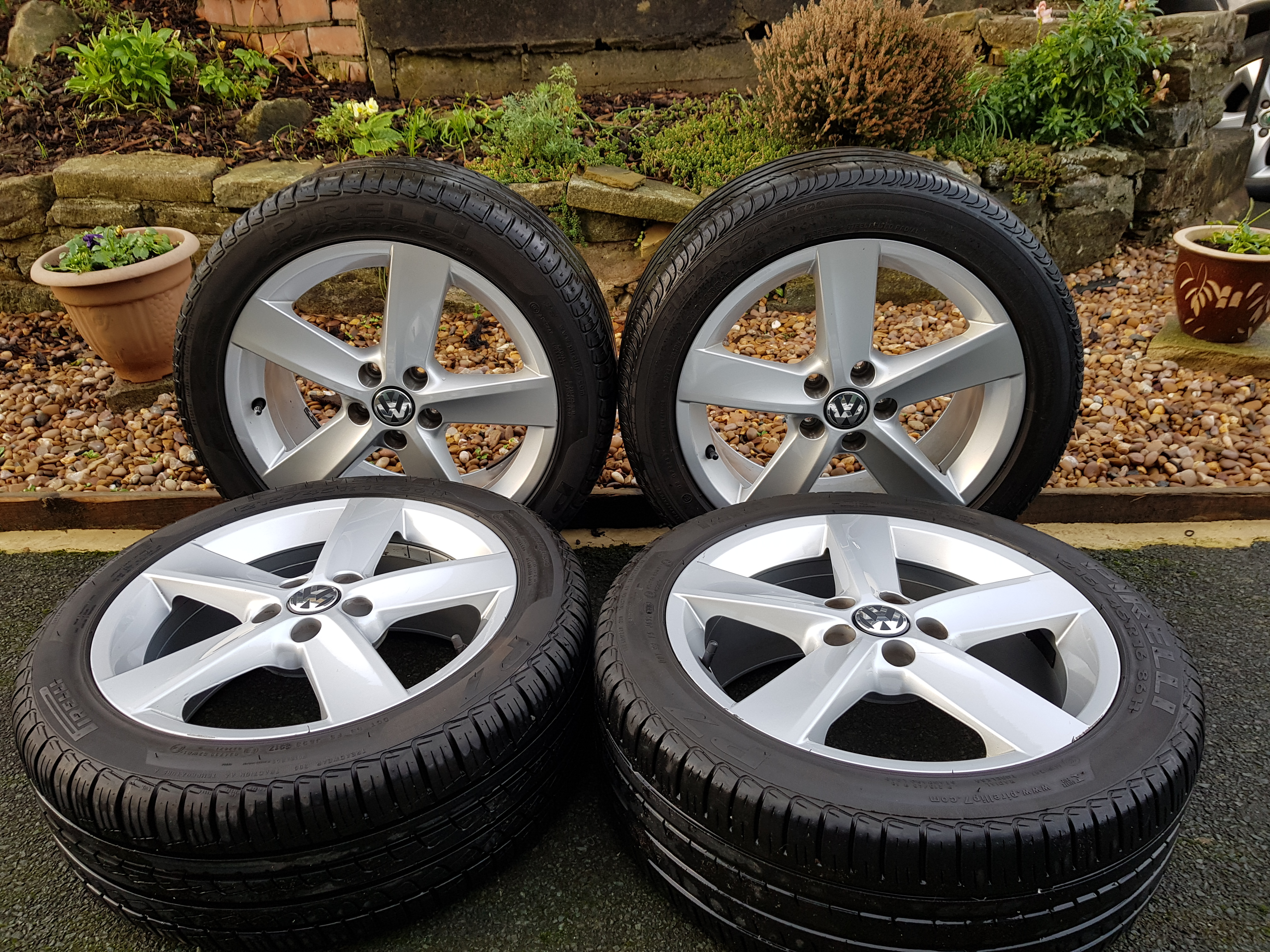

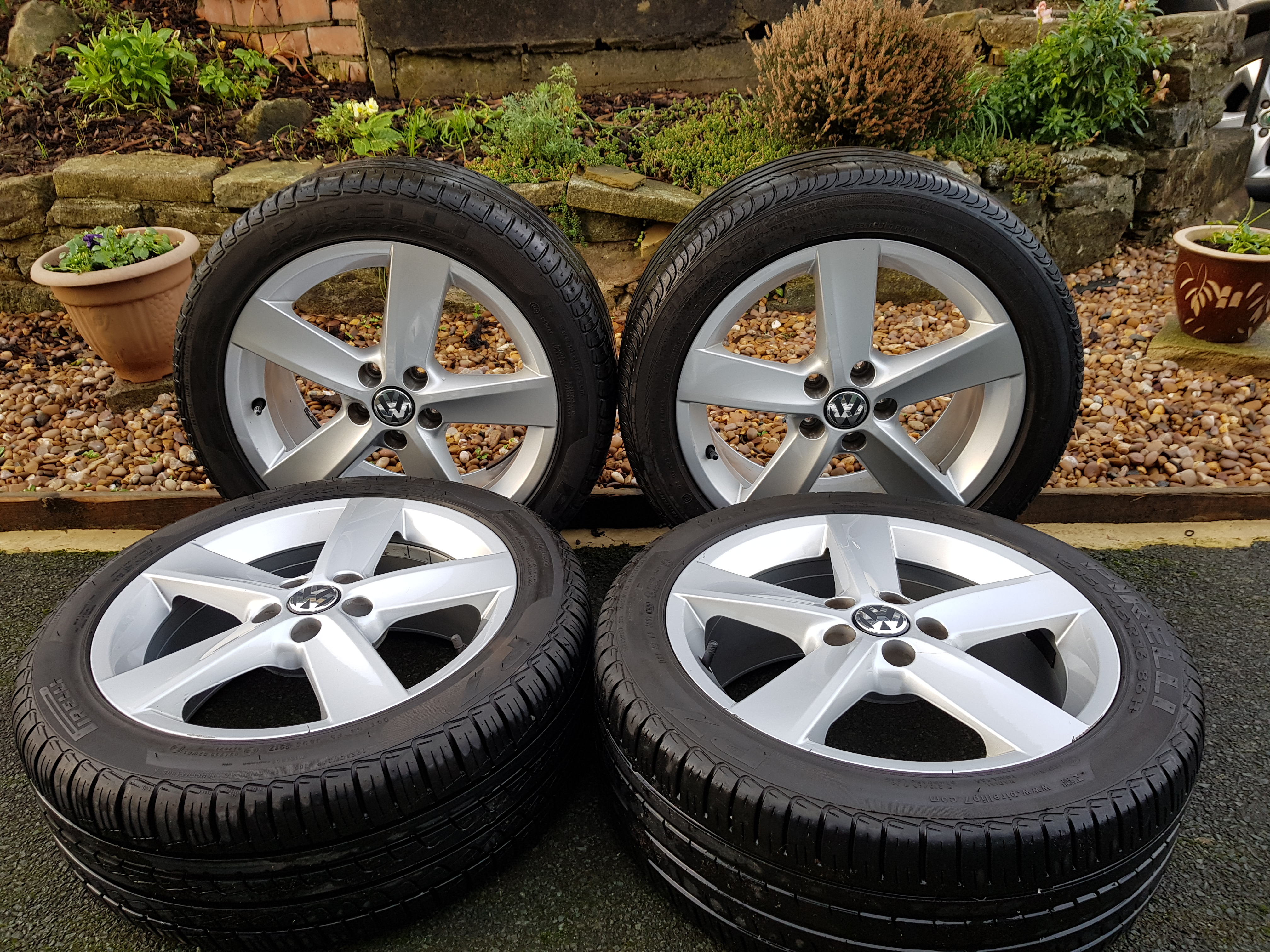

If you want some 16 inch genuine VW alloys I currently have my 16 inch Rivazza alloys for sale complete with tyres and new set of centre caps. Tyres fitted are 215/45R16 .
I'm selling because I went up a size to 17 inch.
Pm me for more details.
