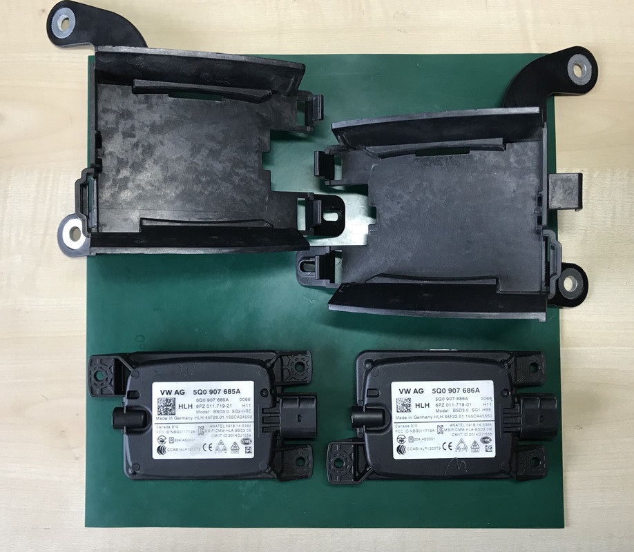

#1 Components
1- Radar Master Left J769 7E0907566C
2- Radar Slave Right J770 7E0907568C
From VW Transporter T5/T6
3- Side LED Module K233 (driver) & K234 (front pax) 35D949145 & 35D949146 from Passat B7, CC including full wiring harness
https://s.click.aliexpress.com/e/c8GuAXM7
4- Audi Q7 Lane Change Assist Activation Button E530/K232 4L1927451
