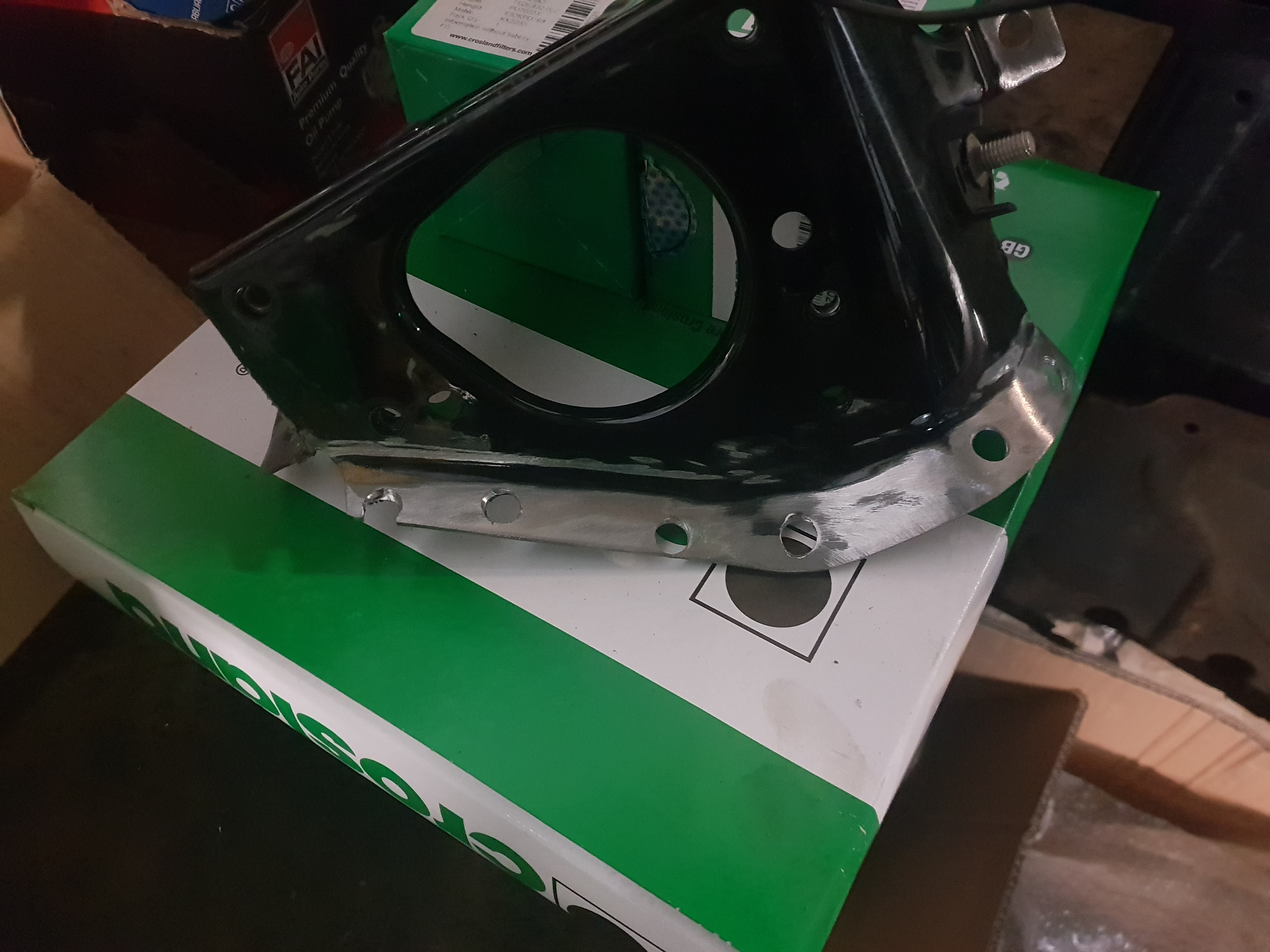

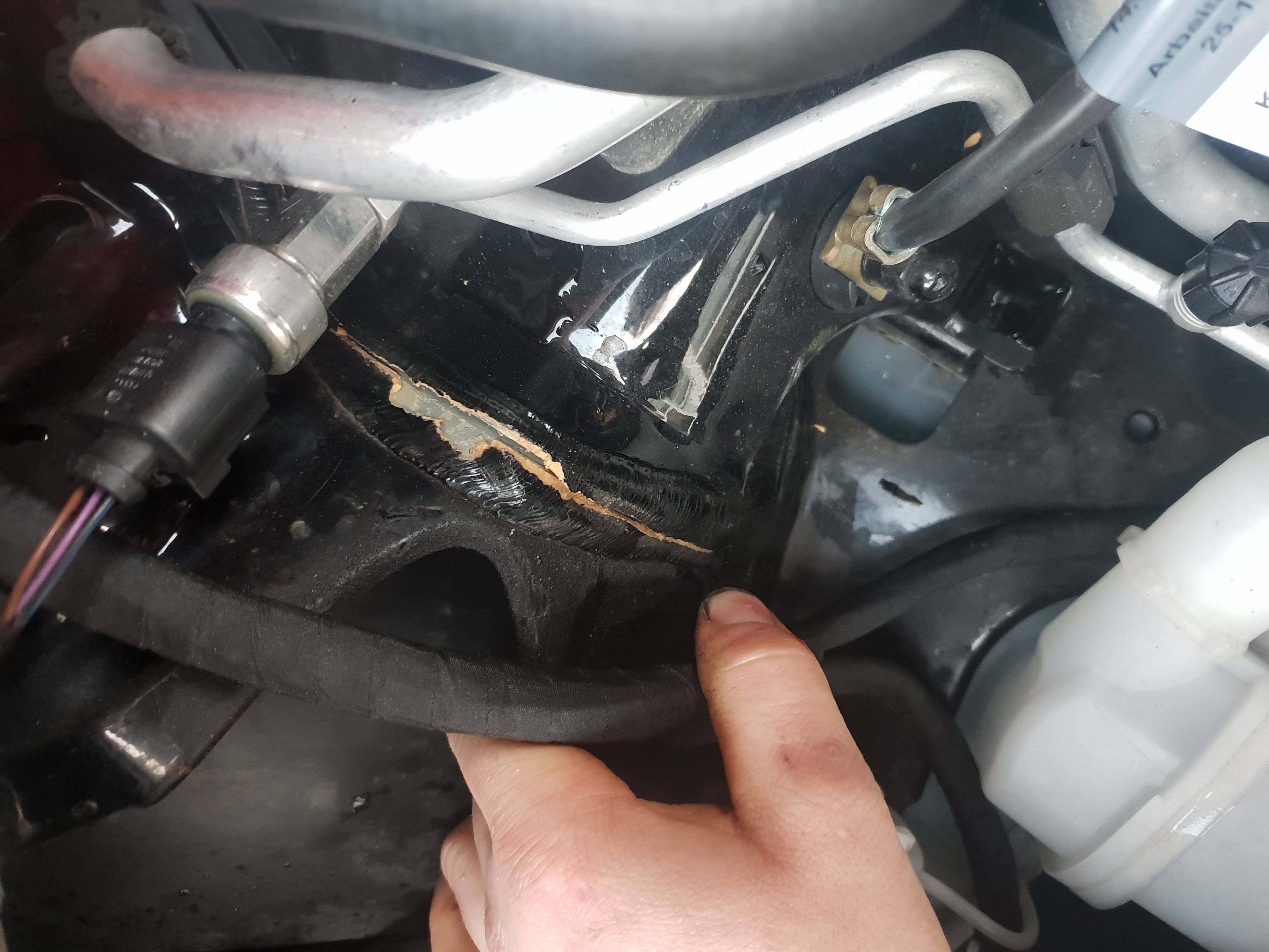

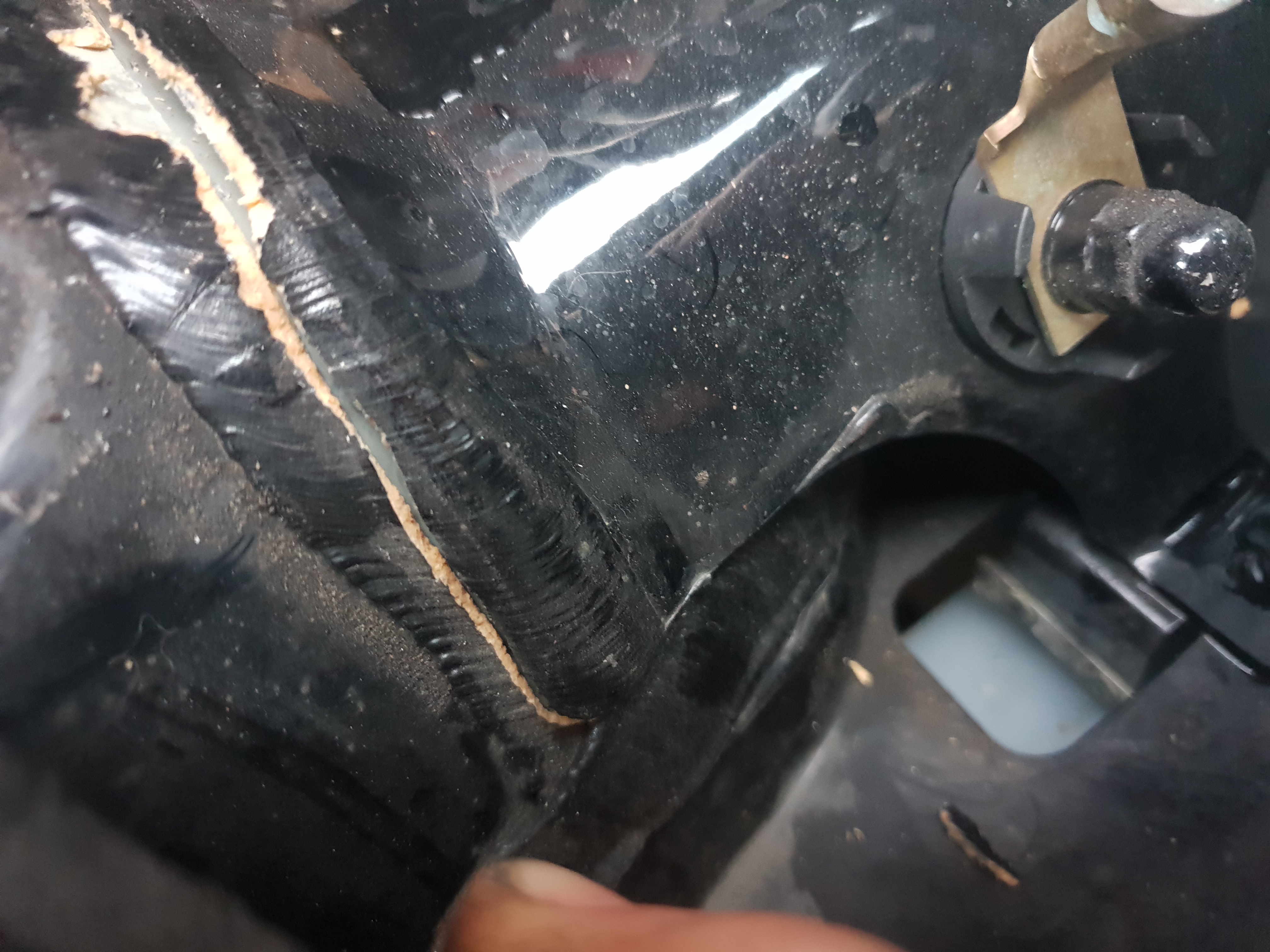

So found the knock I would check your polos cause VW told me it's a common fault
Right here is the timing chain side of the engine bay it's the engine mount this part is welded too the frame and comes apart from the car and cause a knock and over time it gets louder and louder till it goes pop.

VW SAY it is I've managed too weld around it but tbh I'm gonna pull the motor out on the weekend too go over it again too make sure I got every corner. Bloody s**t design just spot welding an engine mount on a performance car with the capability too make decent power.

LawrenceDGraham wrote: Mon Jan 28, 2019 6:15 pm So found the knock I would check your polos cause VW told me it's a common fault 20190120_155124.jpg20190120_155156.jpg20190122_190504.jpg
Thanks...I have checked there and can see no crack but has yours only recently cracked the sealant or has it always shown a crack during the time of the noises.

Yeah I didn't have a visable crack untill recently but the welds must have cracked just wasn't visable and yeah the noise seemed too come from both sides depending on what bump I hit the the gearbox mounts Aka the dog bone are common on theye polos as Well that's where I started then work way up too strut top mounts and coilovers then i seen the crack when washing the car so pretty much was wasting money trying too fix a noise I was never gonna fix I think putting pollyurethane bushes in put more stress on the engine mount causing it too show a visable crack
