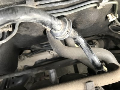

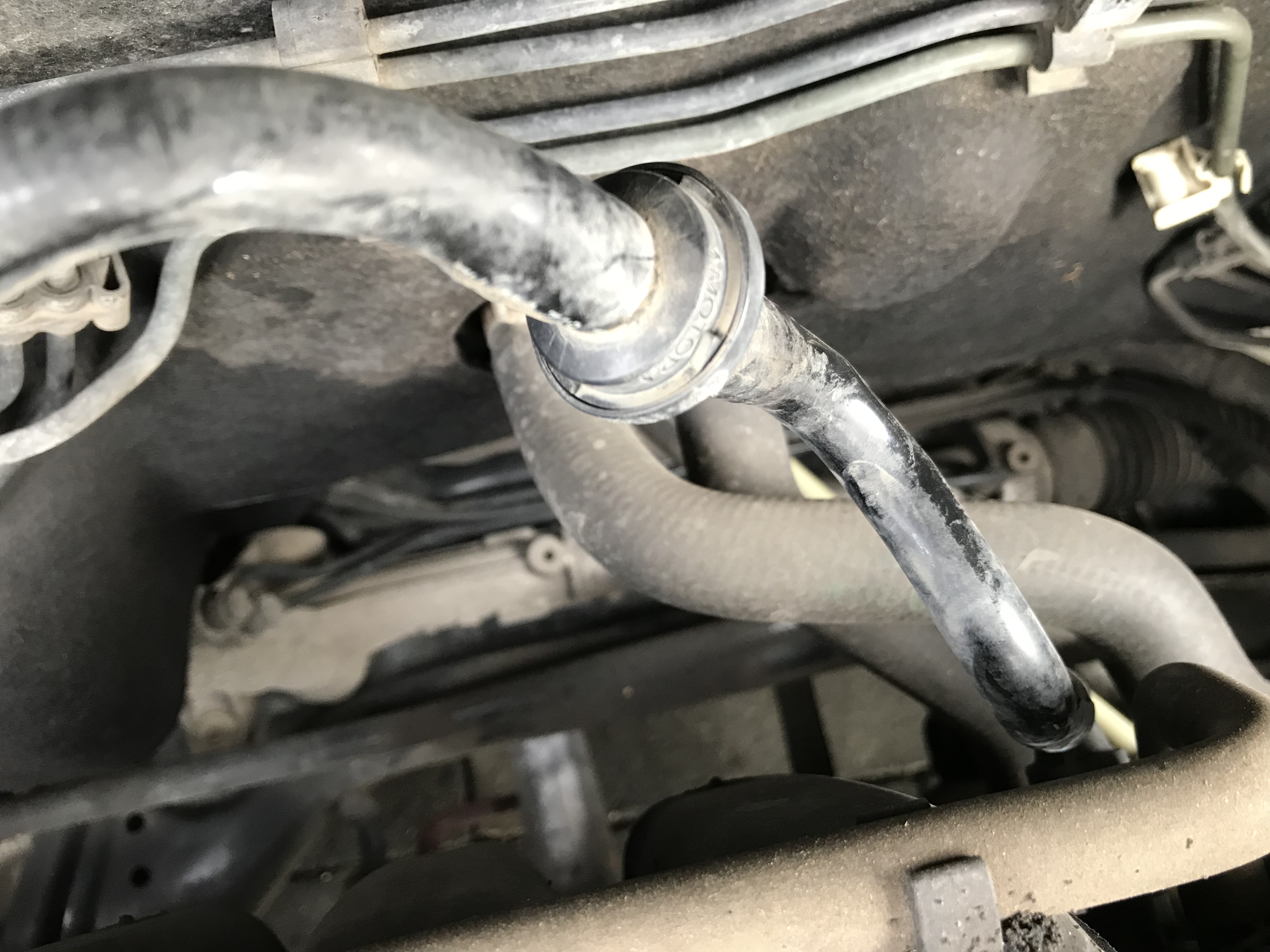

Can anyone help, I have a 2007 1.2 9N3 which has suddenly lost power and serious juddering. I have changed the fuel filter but not worked. I took the air filter off and found two split hoses at the rear of the engine bay but don’t know what the are, can anyone help please?! [img][

If it is that hard plastic pipe that is cracked then that will annoy the engine a bit as it is the brake servo vacuum pipe.
Edit:- that picture is mainly showing the brake servo vacuum pipe complete with a one way valve, you should replace the complete pipe assembly if it is cracked, I’d buy it from VW dealer as there are many different versions, one for each engine type I think, so too easy to get one that does not fit if buying elsewhere.
