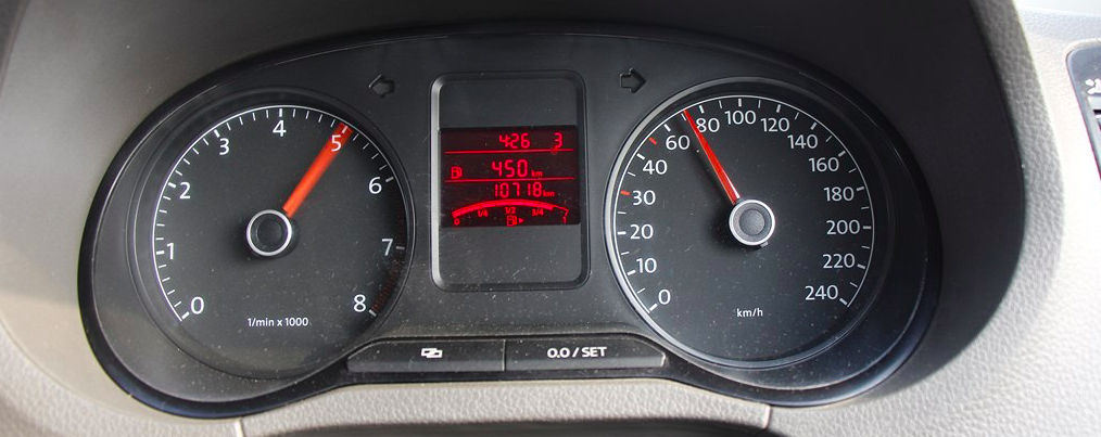

Re: Polo 6R - Questions (MFA, CC, cluster)
I have a 2014 Vento (Polo) 6R TSI with the below cluster. I am planning to upgrade my current cluster with 5K0920870F.
The reset buttons are on the middle are in my current cluster. They are on the side in the cluster above. Will there be any issues in the fitment?
Any suggestions on model numbers for cluster upgrade? I need the maxi dot version. Suggestions on sourcing the same would be appreciated.

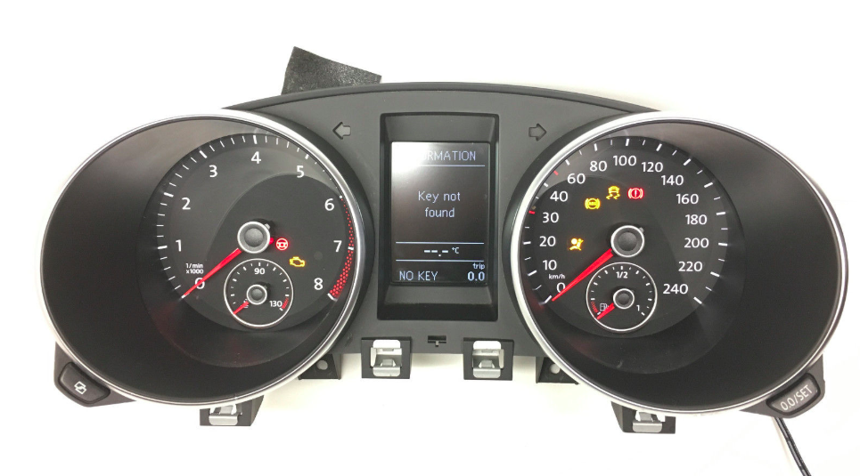

- Posts: 6387
Go for a polo GTI or blueGT cluster. 6R0 part numbers.
Alternatively you could use a cluster from a Skoda Fabia or Seat Toledo. These cars must be PQ25 platform. Clusters from a different platform (5k0 = pq35, 6c0 = pq26/mqb) will not work on a polo 6R.
Keep in mind that swapping a cluster will require the adaptation of your immobiliser. Do not do this yourself unless you are 200% sure what you are doing. Do not put the cluster in the car unless there is an expert in immobiliser adaptations with you.
