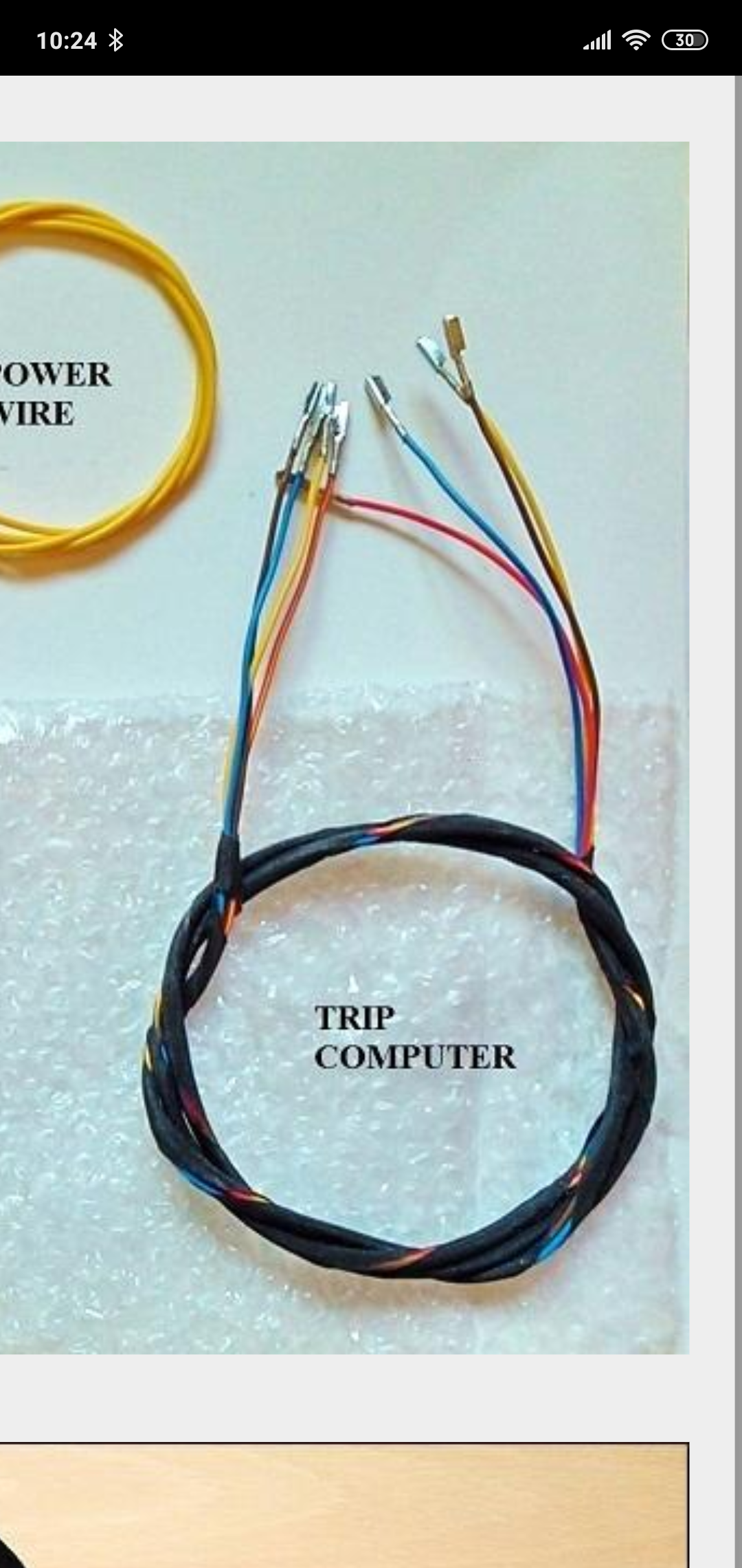

could someone tell me numbers or size of pins for MFA in polo 6R? I have to add wiring for new stalks and MFA, like this on photo below
6R MFA cable pins
6R MFA cable pins

Re: 6R MFA cable pins
MQS - Micro Quadlok System - 0,63mm
Could you tell me are this pins on both sides of cable? Or there are another on left side of photo?ciclo wrote: Sat Mar 09, 2019 9:48 am MQS - Micro Quadlok System - 0,63mm
Both sides, T41 and T32.
