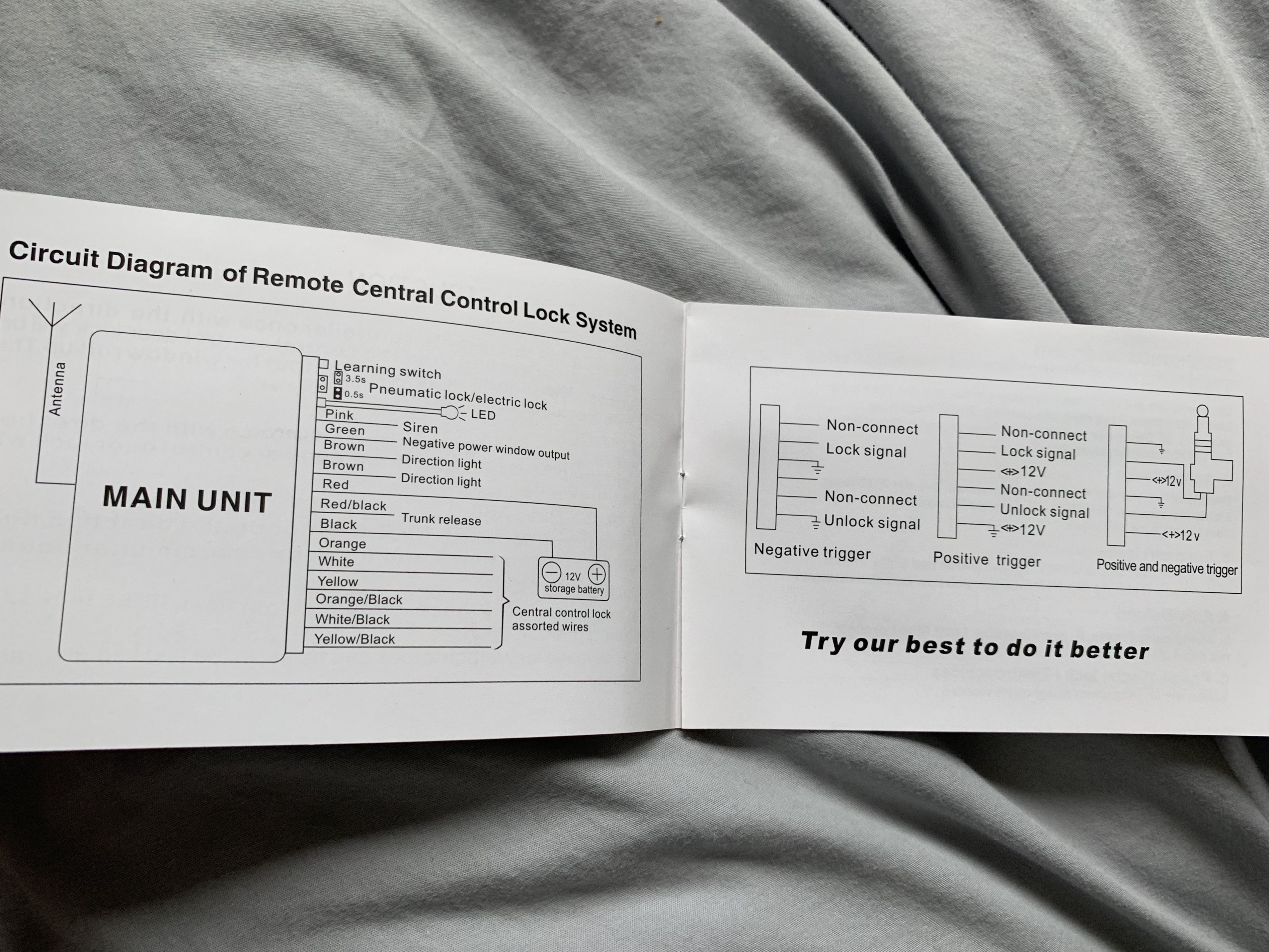

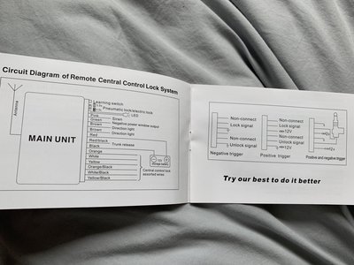

Scan or photo of each page of the instructions please Owen
OwenNorton
- Posts: 18
- Joined: Sat May 06, 2017 12:43 pm
- Drives: 6R MY13
- Location: Leeds
Re: Installing Remote Locking
see attachmentalexperkins wrote: Mon Apr 01, 2019 4:41 pm Scan or photo of each page of the instructions please Owen![]()
what are my next steps?alexperkins wrote: Mon Apr 01, 2019 4:41 pm Scan or photo of each page of the instructions please Owen![]()
- alexperkins
- Site Admin
- Posts: 14874
Ok so it’s the same as the rclick guide in the DIY section. 180ohm resistor but the wire colour is different. I’m double checking my notes and will come back to you

VW Polo Mk V remote central locking unit instructions.
Remove boot release handle (unclip on side).
Remove screw and driver’s side kick panel, on right below steering wheel.
Locate wiring loom coming from door.
(Thin) blue wire = central locking control. (Green/yellow wire prior to May 2011).
Negative trigger. Pull this directly to ground to lock or via 180 Ohms to ground to unlock. Use 5 A cable lock connector.
(Thick) Red/yellow wire = +12 V permanent. Use 15 A cable lock connector.
(Thick) Brown wire = ground. Use 15 A cable lock connector.
