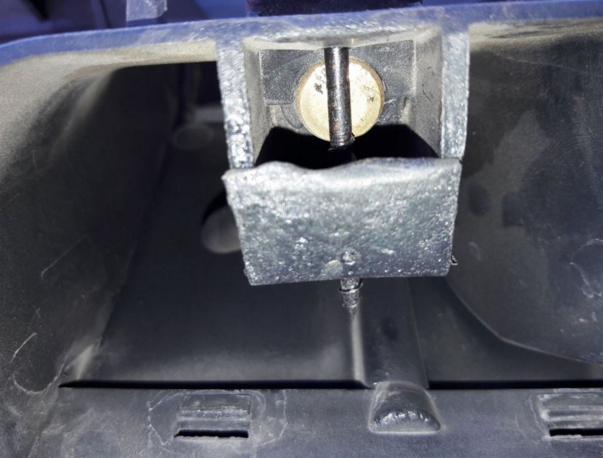

Might be worth checking the Hot Air Flap in the Engine Cover,controlled by a waxstat - they tend to fail 'Open' which would give permanent Hot Intake Air,we took our AUB engine 1.4 16v (almost identical to BBY) and monitored the Intake temperature on the 'Torque' APP - even with our Air Flap manually locked in 'Cold' and on a cool day of 9 deg c - the intake temp eventually got up to over 40 Deg within 14 miles.I am not saying it is causing your problem but might be aggravating it.

This is a pic looking forward inside the Engine Cover with the air filter removed,the brass disc is the rear of the waxstat,it is being held forward (closed) by a woodscrew.Tried out my new 'Torque' app/OBD dongle thingy today and we went for a short (14 mile) drive to get some real time engine parameters - Engine Intake Temp started off at +9 deg c (agreeing with ambient) but was up to + 35 deg c at the halfway point - by the time we got back into town it was reading +42 deg c - so even with the Intake Flap closed - the engine is still getting hot air LOL.
