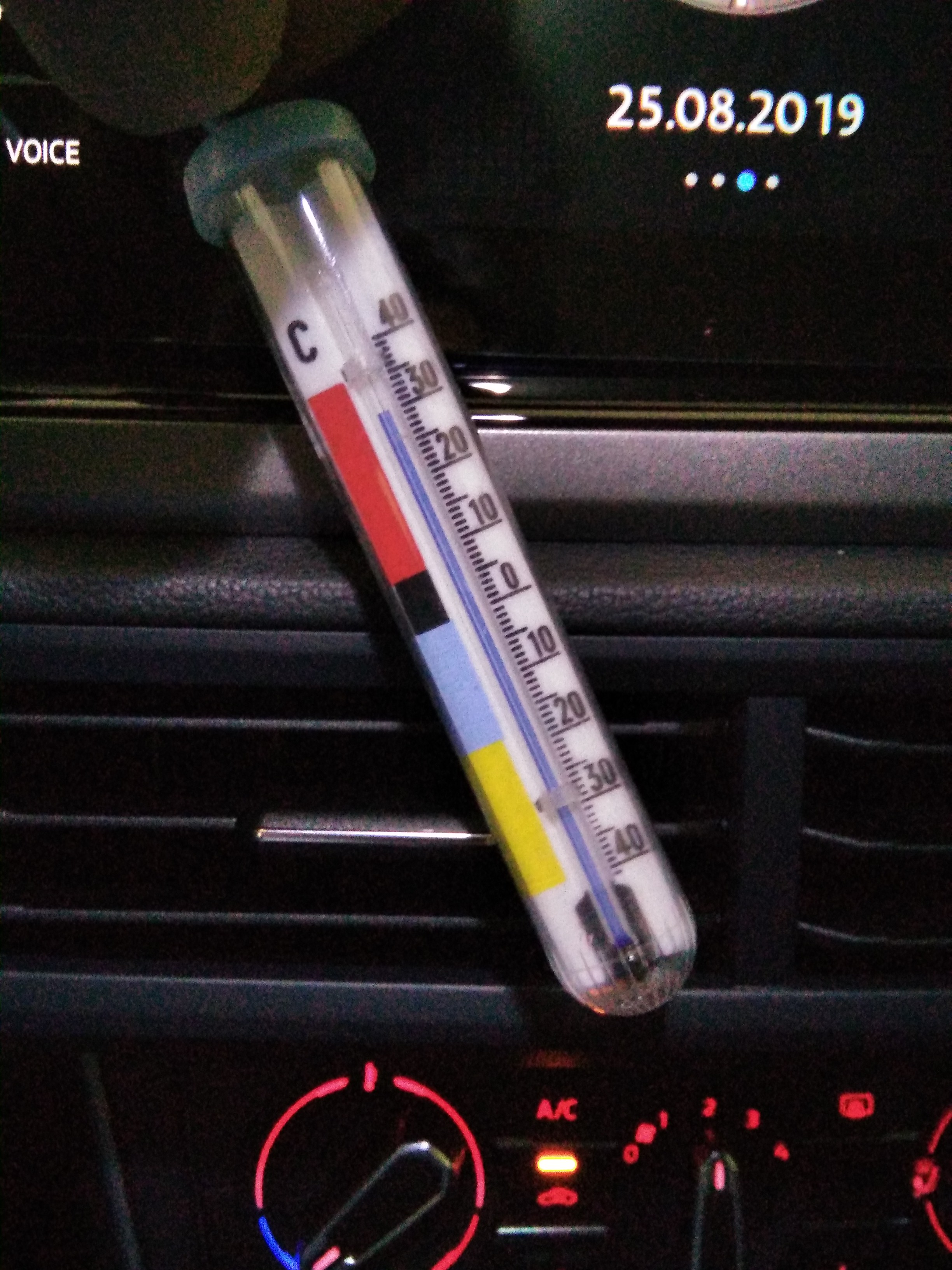

Re: Heat issue
Hi I have the same exact problem my car has manual ac and if I put ac off and low temperature the air is always war/hot and it keeps the car always hot inside, I have to talk to the dealer and see what we can discover.

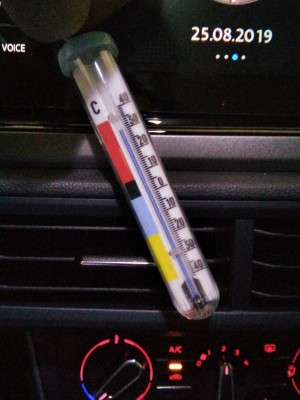

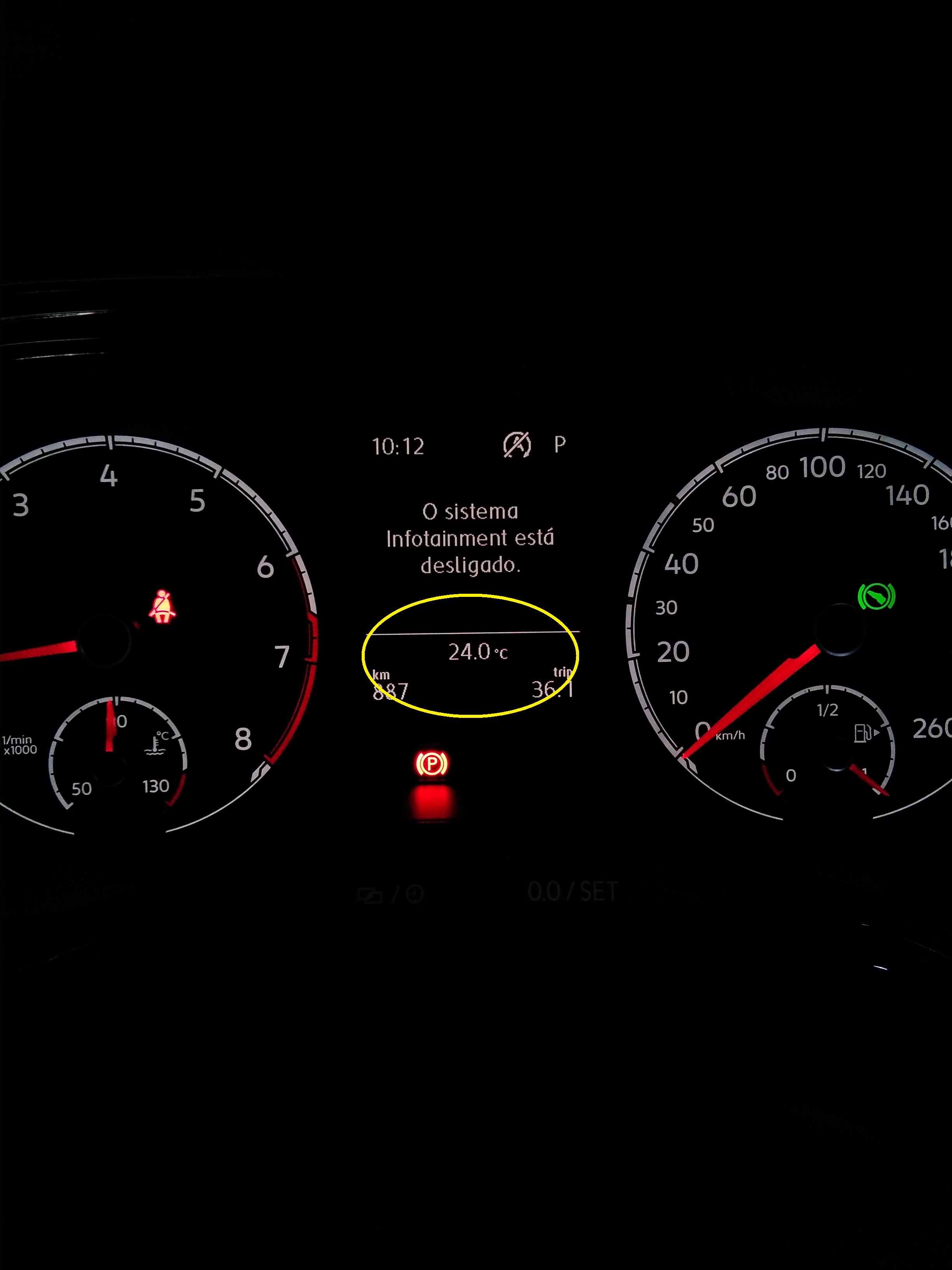

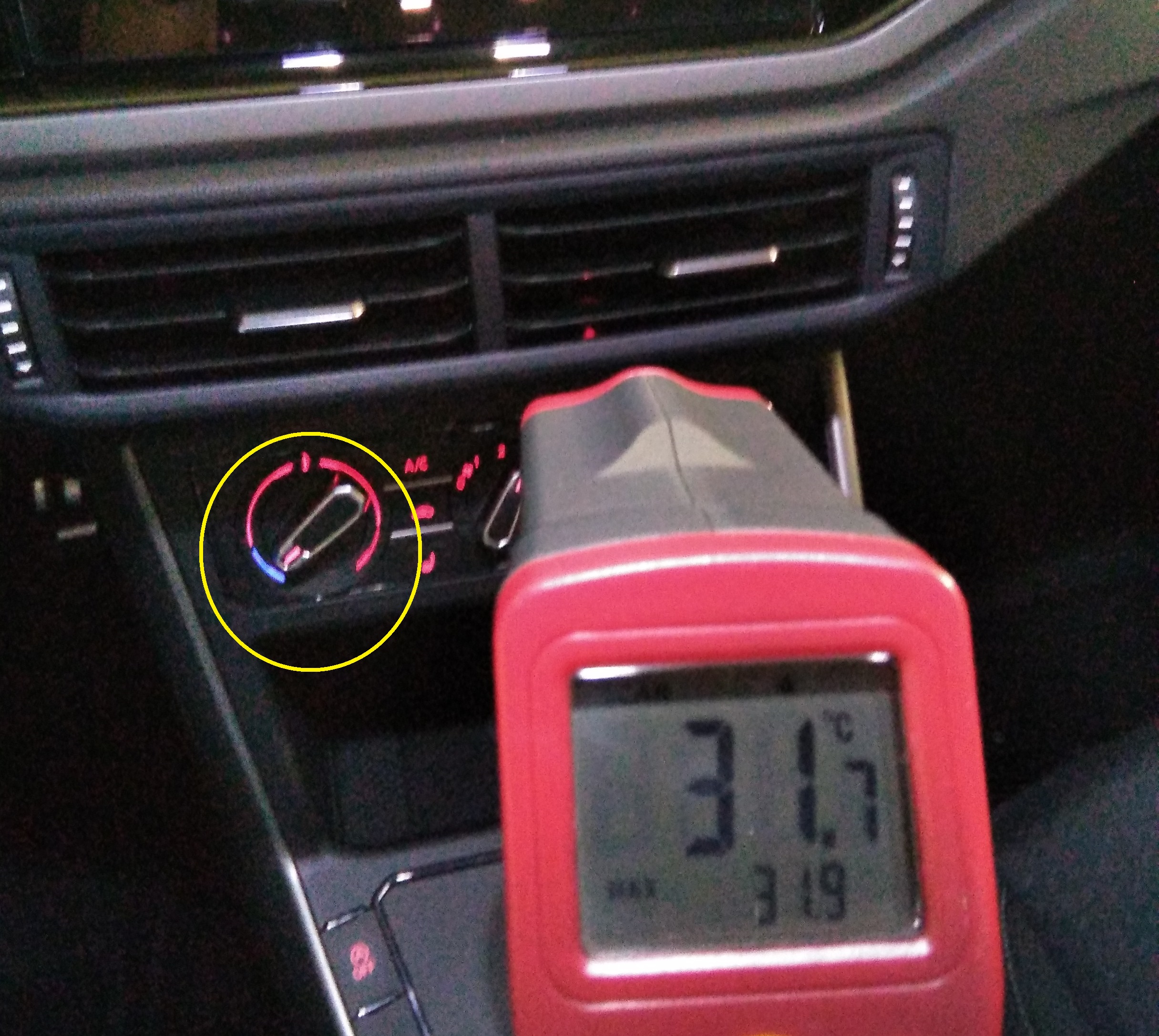

Re: Heat issue
Hi, let me tray to explain, the a/c its off, I turn speed fan on, the temperature regulator its in the lowest temperature, the air that should be getting in should be the temperature out side, but the temperature that enters its always harm/hot I measured it and its coming about 32ºc. It happens the same with fan off but driving the incoming air its always harm.

Re: Heat issue
What I intend to explain is that if the outside temperature is 20 the air that goes inside without the ac on should not be much higher and it is not what is shown in the pictures.
