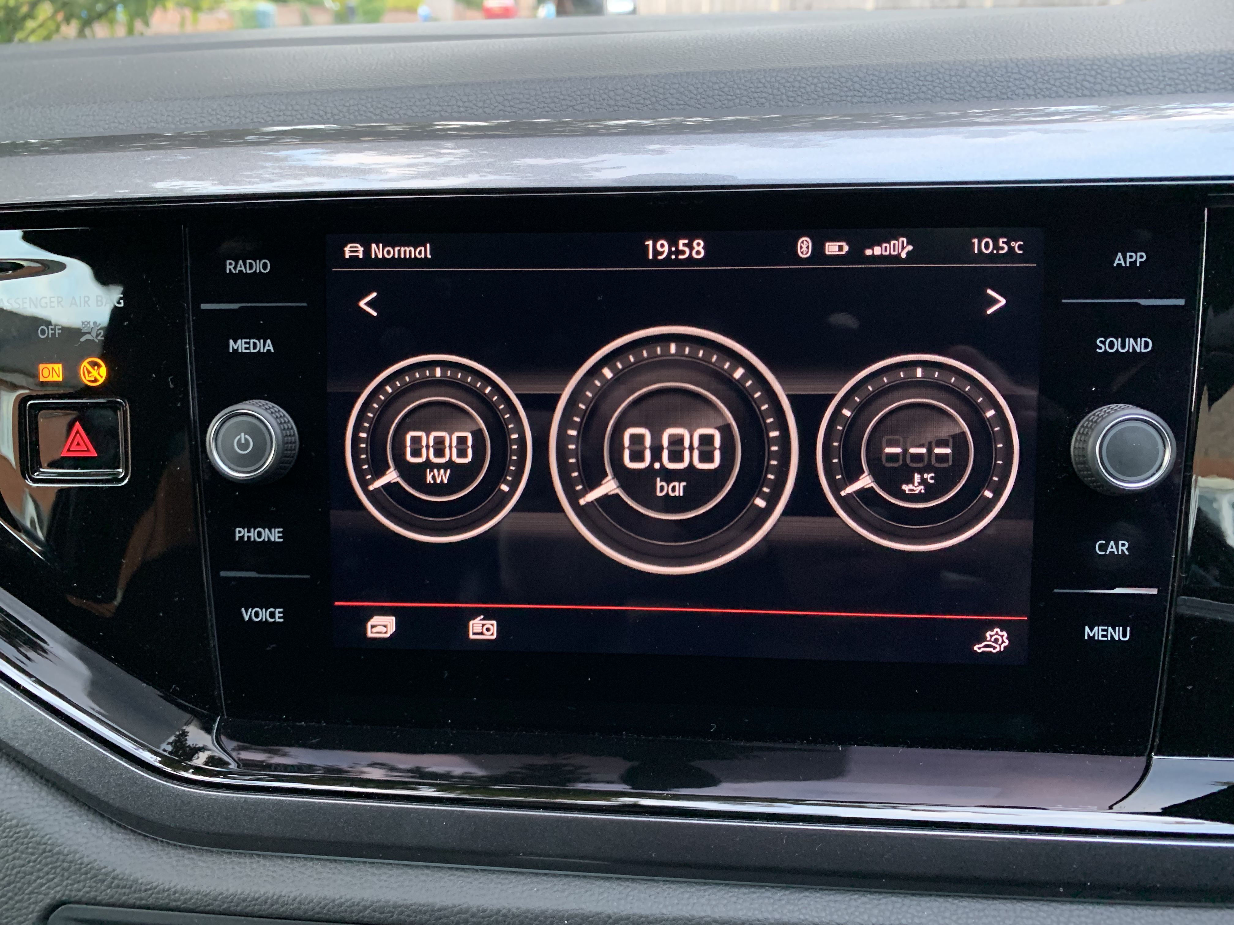

I’d definitely wait for the oil to warm up before pushing the throttle pedal down too much. On the infotainment screen, I always have the ‘Sports’ info showing the power in Kw, the boost pressure and the oil temp. I wait for the oil to be reasonably warm before using the car properly.

Thanks Martin. How do you go about showing the power like that on the infotainment screen?

To get the sports information on the infotainment screen, hit the ‘Car’ soft button on the right, then as you move your hand to the screen it’ll pop up a select option at the bottom. Tap that, select the ‘Sports’ option and it’ll present three dials. You can swipe the dials up / down to configure the screen for the information you want.

That's great thanks Martin.
You’re welcome. The oil temperature only reports from 50.C upwards. That’s usually 4 or more miles from cold. I usually wait until it’s above 70.C until I start accelerating hard. I plan to keep my GTI for quite a few years, so I’m a little OCD about making sure the oil is warm before using the power fully.
