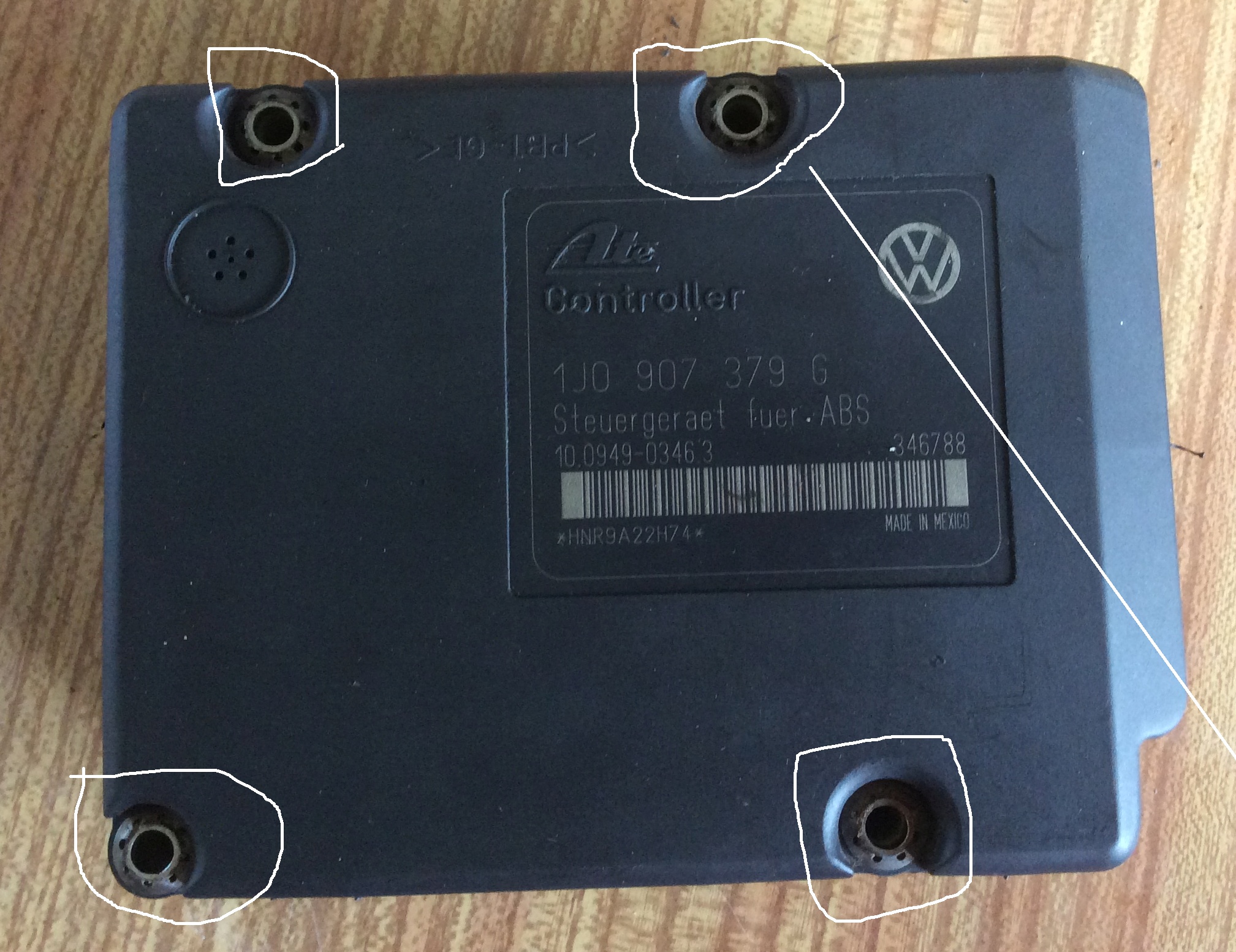

Morning all.
So I've had the control unit off, it's got part number 1J0 907 379G which is not quite what it should be I think. Hard to know.
Reason it's causing problems now is that there are sleeves through the plastic casing where the studs go to hold the ECU onto the ABS manifold.
These sleeves have an integral capping washer/disk which means that removing the lid from the unit is even harder than it is already. This doesn't appear in the handy guide!
Not sure if the photo is going to work, we shall see.
Anyhow, solution currently is to consider drilling out the washers on the sleeves, or to locate a second hand unit that would fit.
Can anyone confirm the original ABS ECU part number that would have been fitted to the car in 1999? I think it's been replaced once already (judging by previous MOT failure history)
Ciderpolo
