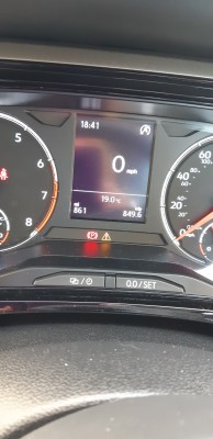

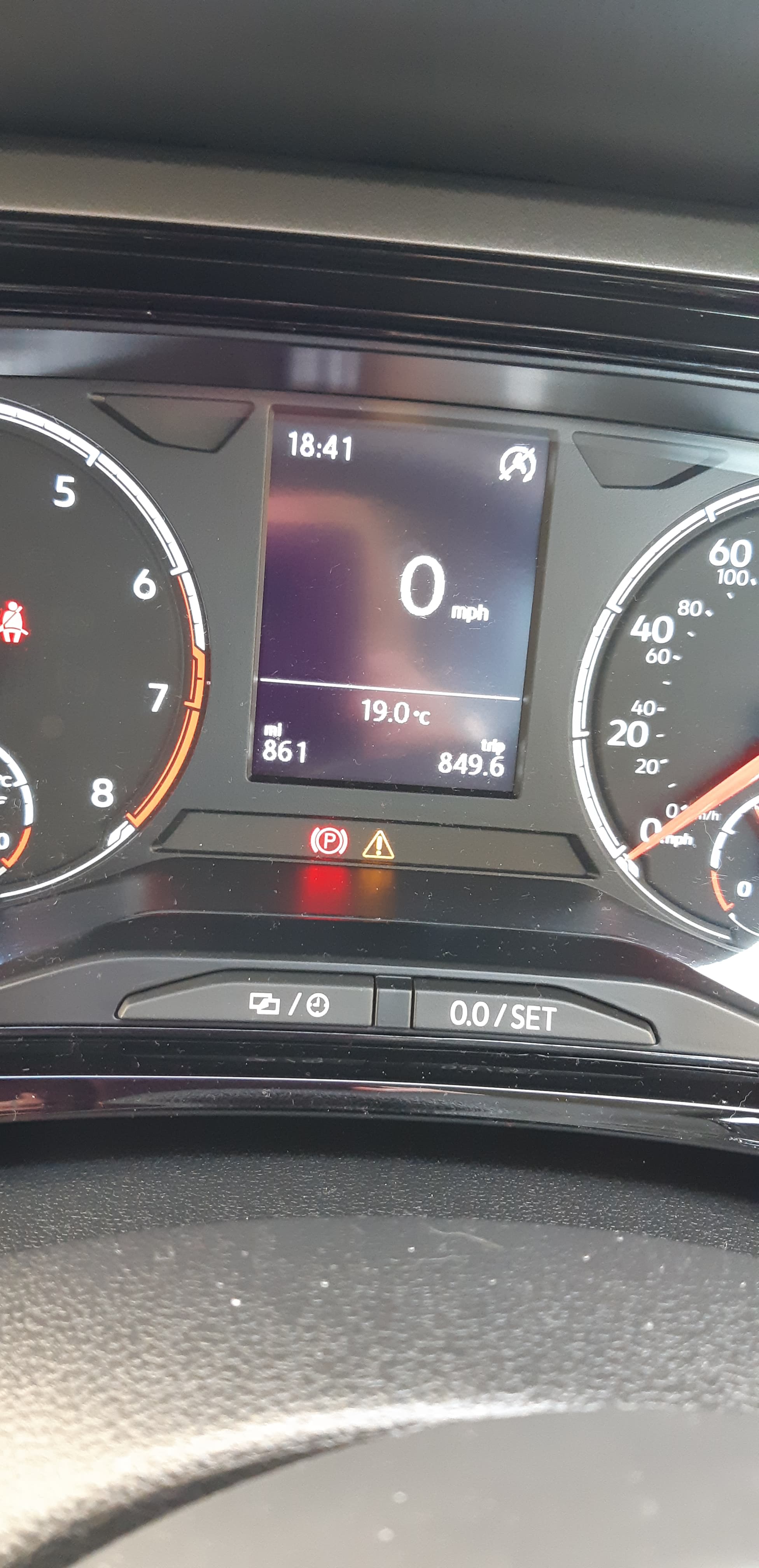

Can anyone give me anymore info to what maybe the issue here and does it need to go to the dealer or is it a case of topping up fluids or something?

Have a look in your owners manual under ‘Driver Information - symbols in the instrument cluster’; always a good place to start if you see an unfamiliar warning symbol displayed.
A yellow triangle with an exclamation mark inside is a general warning. When this is displayed, there should be additional information displayed in the instrument cluster to indicate what the issue is. If no other information is (or has been) displayed in the instrument cluster, suggest you check the car settings menu(s) accessible via the infotainment screen.

The yellow symbols don't herald imminent failure - they're usually indicative of oil , coolant or washer fluid top ups, or letting you know something needs to be replaced, like a blown bulb, or your brake pads are closed to the limit.
You should have an accompanying message to tell you what's wrong.. A red warning is a different matter- pull over immediately if you get one of those.

Unless there's an oil leak or oil consumption has been very high during run in (unlikely), it's more likely to be low washer fluid or maybe low coolant level because of an airlock in the system when it was filled at the factory.Athlonman wrote: Mon Jul 08, 2019 8:44 pm It's a female friends car so i cant check atm, hopefully it's only a low fluid of something as the car is only 6 weeks old.
For anything other than washer fluid, I'd get it back to the dealership, they should top up the oil or coolant for free if it's those, and check for leaks or dodgy sensors, given that the car is only 6 weeks old.
It could also be the GPF is filling up and needs a longer run to clear it, but I've not heard of that happening to anyone yet.
There is one other situation that would leave the yellow warning on, with nothing actually wrong with the car - if your friend has turned the front assist off, the car leaves you with an annoying warning if you turn it off.
There will be accompanying text with any of the warnings if the car is running, to explain what is wrong.

Everytime she starts the car it will tell her what the issue is on the MFD between the dials, also scrolling through the options on the MFD to "Vehicle Status" will show here the problem, as well as on the ICE\touchscreen\stereo (whatever you want to call it). It could be anything from low washer fluid (if winter pack fitted) to low oil or a TPMS (tyre pressure monitoring) warning. Advise her to read her cars manual and familiarise herself with her cars (many) safety functions, warnings and convenience features.Athlonman wrote: Mon Jul 08, 2019 7:10 pm Can anyone give me anymore info to what maybe the issue here and does it need to go to the dealer or is it a case of topping up fluids or something?

Easy, press “car” on the entertainment screen, and cycle through them until you reach “Vehicle status”. There you’ll see all faults and warning messages.Athlonman wrote:Can anyone give me anymore info to what maybe the issue here and does it need to go to the dealer or is it a case of topping up fluids or something?

As Philos saysphillos wrote: Tue Jul 09, 2019 9:22 pmEasy, press “car” on the entertainment screen, and cycle through them until you reach “Vehicle status”. There you’ll see all faults and warning messages.Athlonman wrote:Can anyone give me anymore info to what maybe the issue here and does it need to go to the dealer or is it a case of topping up fluids or something?
Any help much appresiated.66385565_494012294686930_4373464832721027072_n.jpg
Press 'Car' on the central media screen and scroll to the 'Vehicle status' page.
