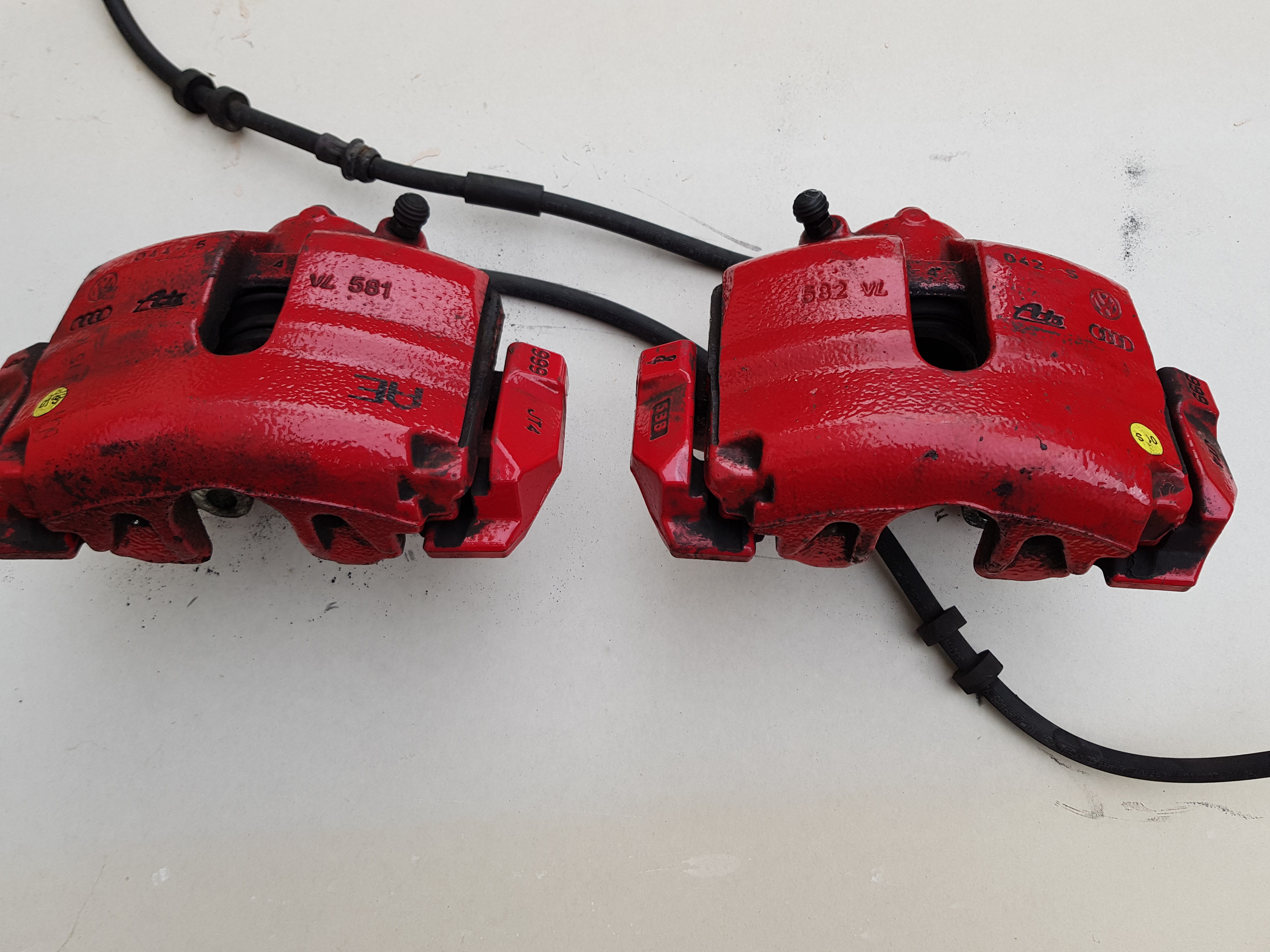

Re: Best brake upgrade from 256mm without changing hub carriers
The 9n3 gti even had 288mm brakes up front.
I've got a complete 312mm setup off my 6c if you are looking for that
Not sure what they are worth tbh only done 18k and i can chuck in a set of brand new brembo pads.
