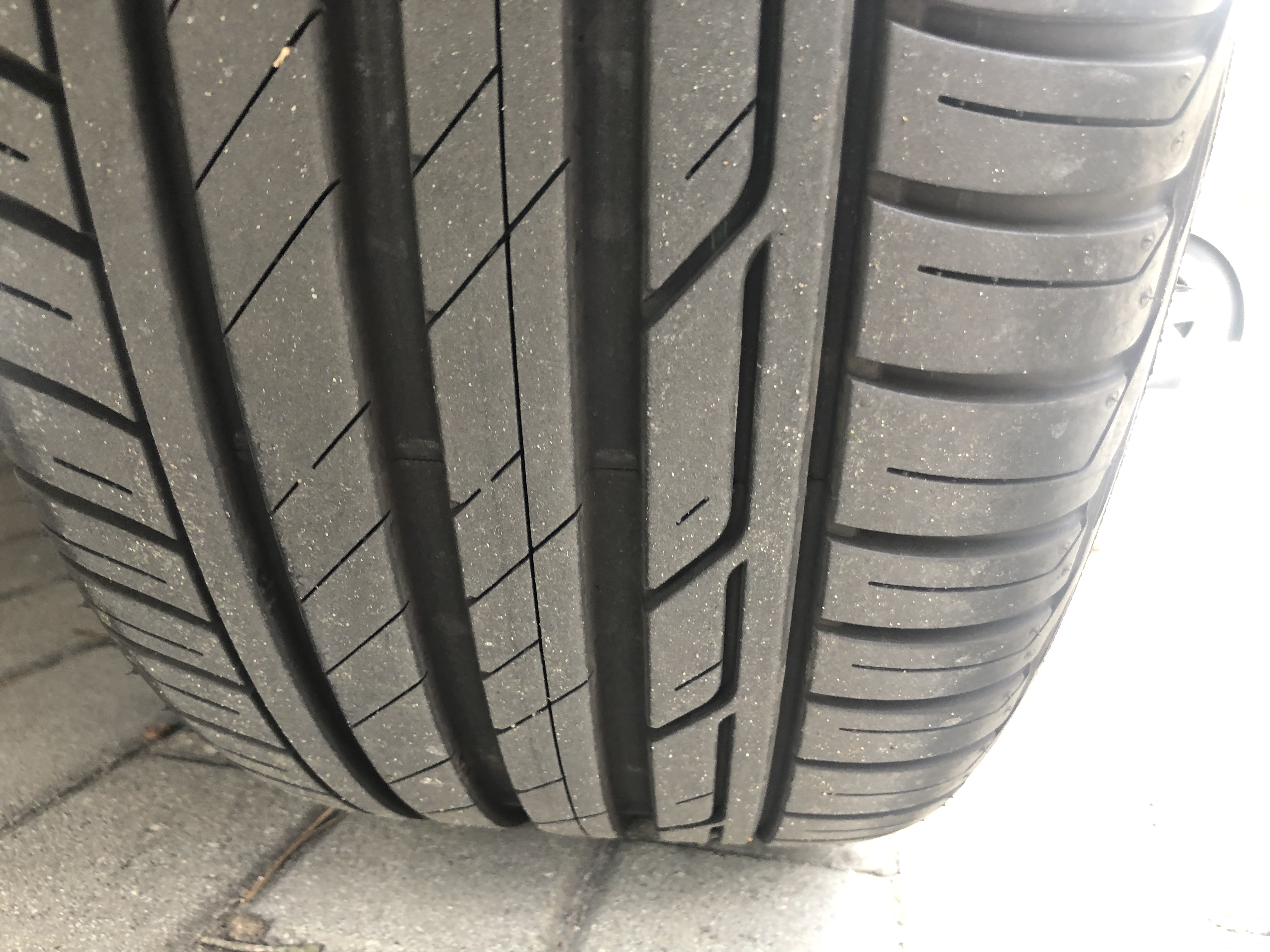

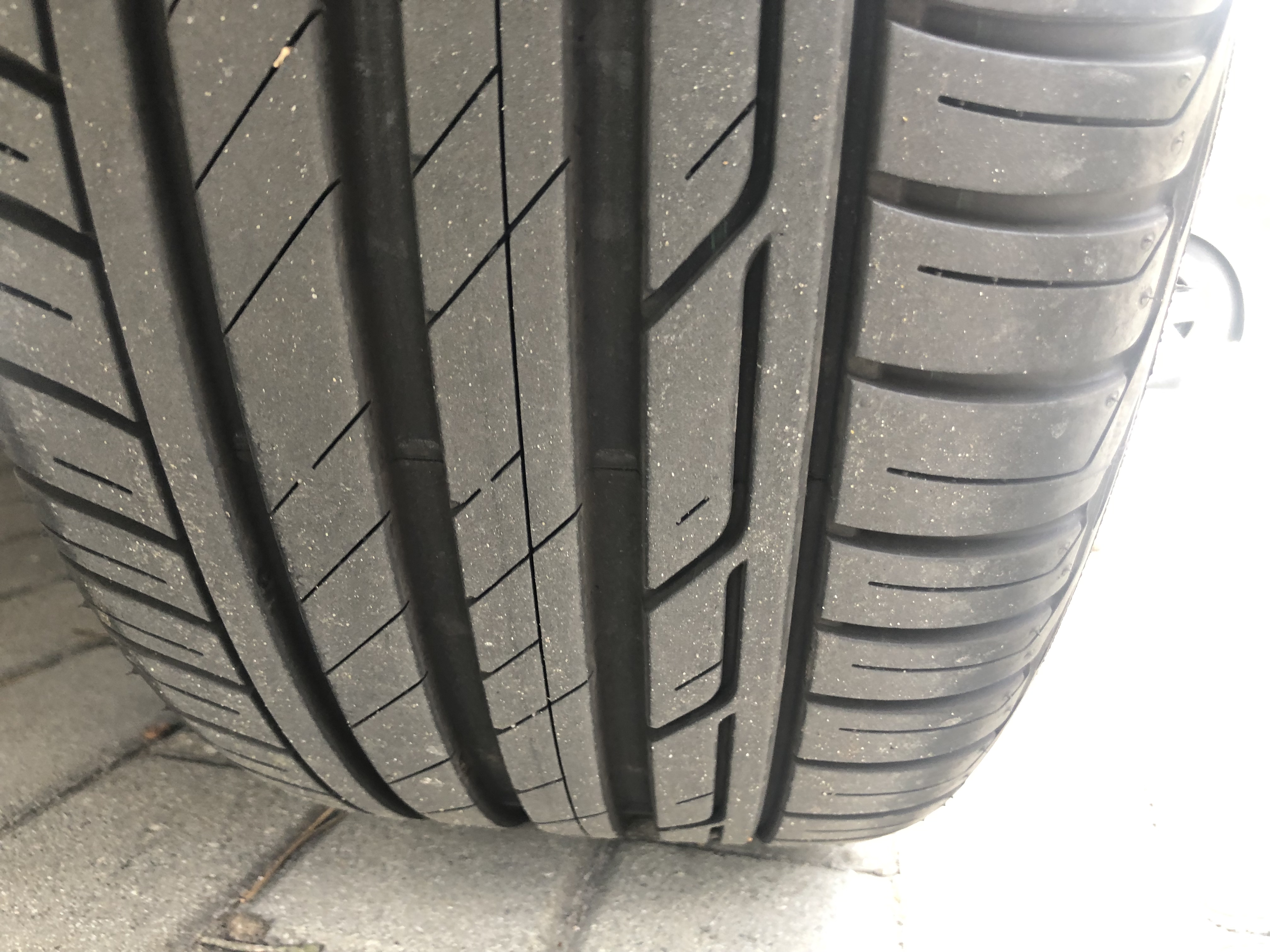

What tyre pressure are you guys running in your GTi's?
According to the manufacturer sticker on the door sill, 18" tyre should be 2,8 bar (41 psi) front and 2,6 bar (38 psi) at the back.
I have fount that running the recommended tyre pressure, the car is jumpy at speed and the tyre is not fully in contact with the surface.
So I have decreased the pressure to 2,4 (35 psi) in front and 2,2 (32 psi) at the back and it's substantially better.
Curious if anybody else has experimented with different pressures?

At 2.4 bar front, the tyres looks abit flat.
Re: Tyre pressure adjustment
The standard recommended tyre pressures seem way too high, probably set that high to help meet an emissions target.
Are you still running 215/40 R18 tyres that came with your car? When I swapped out the rock hard and poor grip Bridgestone Turanzas for Michelin PS4 225/40 R18, the tyre fitter recommended 33psi off the car, equating to 35/36psi on the car. They feel much better. I would expect 215 with tyres to be running at a higher pressure than 225 width - maybe try 38psi if still on 215s?
Looking at your pic, the lack of dusting on the tread towards the shoulders of your tyres does look like slight over inflation to me.

monkeyhanger wrote: Sat Jul 13, 2019 8:24 am The standard recommended tyre pressures seem way too high, probably set that high to help meet an emissions target.
Are you still running 215/40 R18 tyres that came with your car? When I swapped out the rock hard and poor grip Bridgestone Turanzas for 225/40 R18, the tyre fitter recommended 33psi off the car, equating to 35/36psi on the car. They feel much better. I would expect 215 with tyres to be running at a higher pressure than 225 width - maybe try 38psi if still on 215s?
Yeah, I'm still running stock 215/40/18 Truanzas
I enclosed the pic because it is clearly visible that standard pressure is actually overinflation.
Like Green Justin said: at 2,4 bar (35psi) the tyre looks a bit flat. I reckon, because more of the tyre surface is actually making contact with the road...
