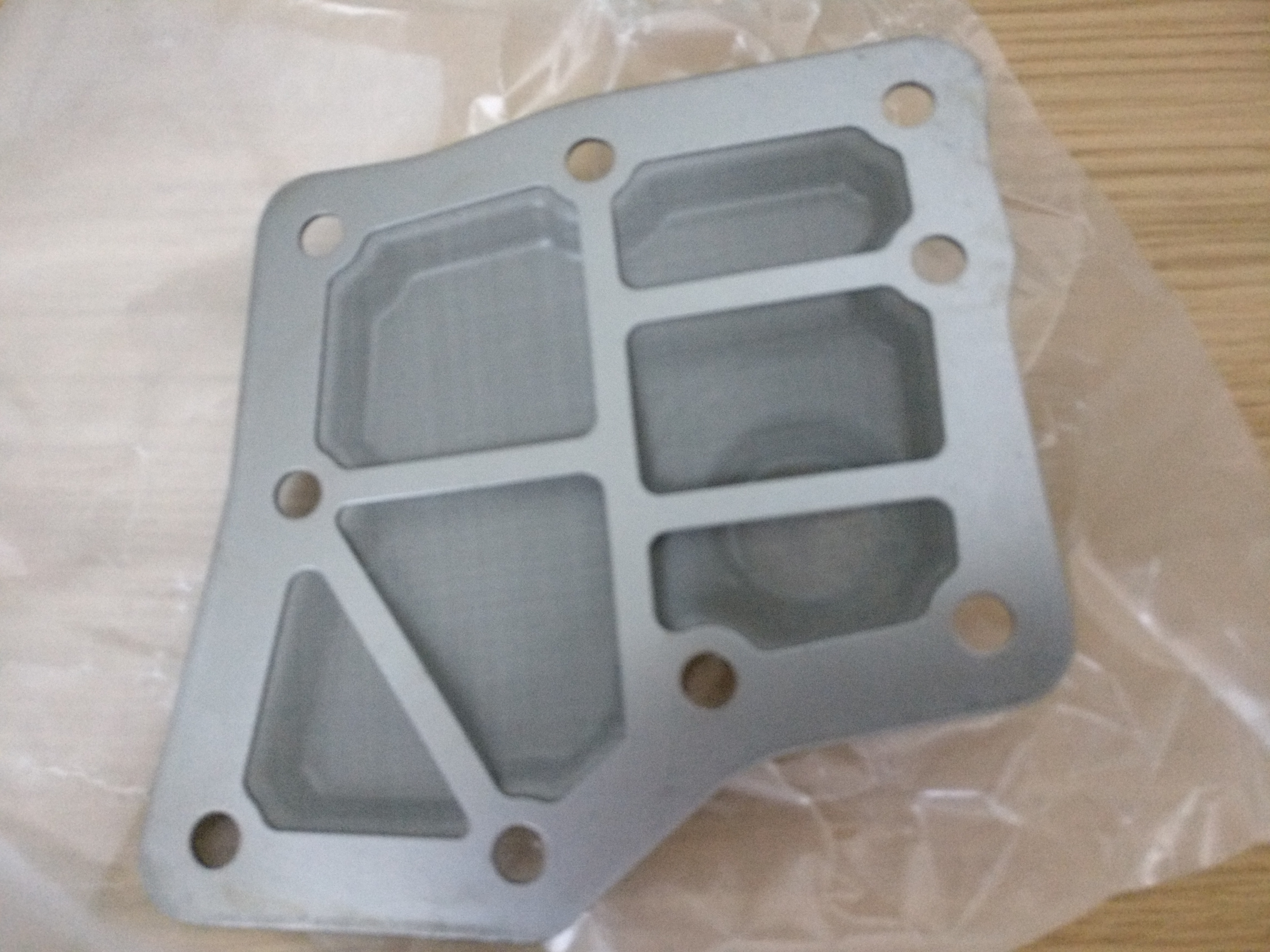

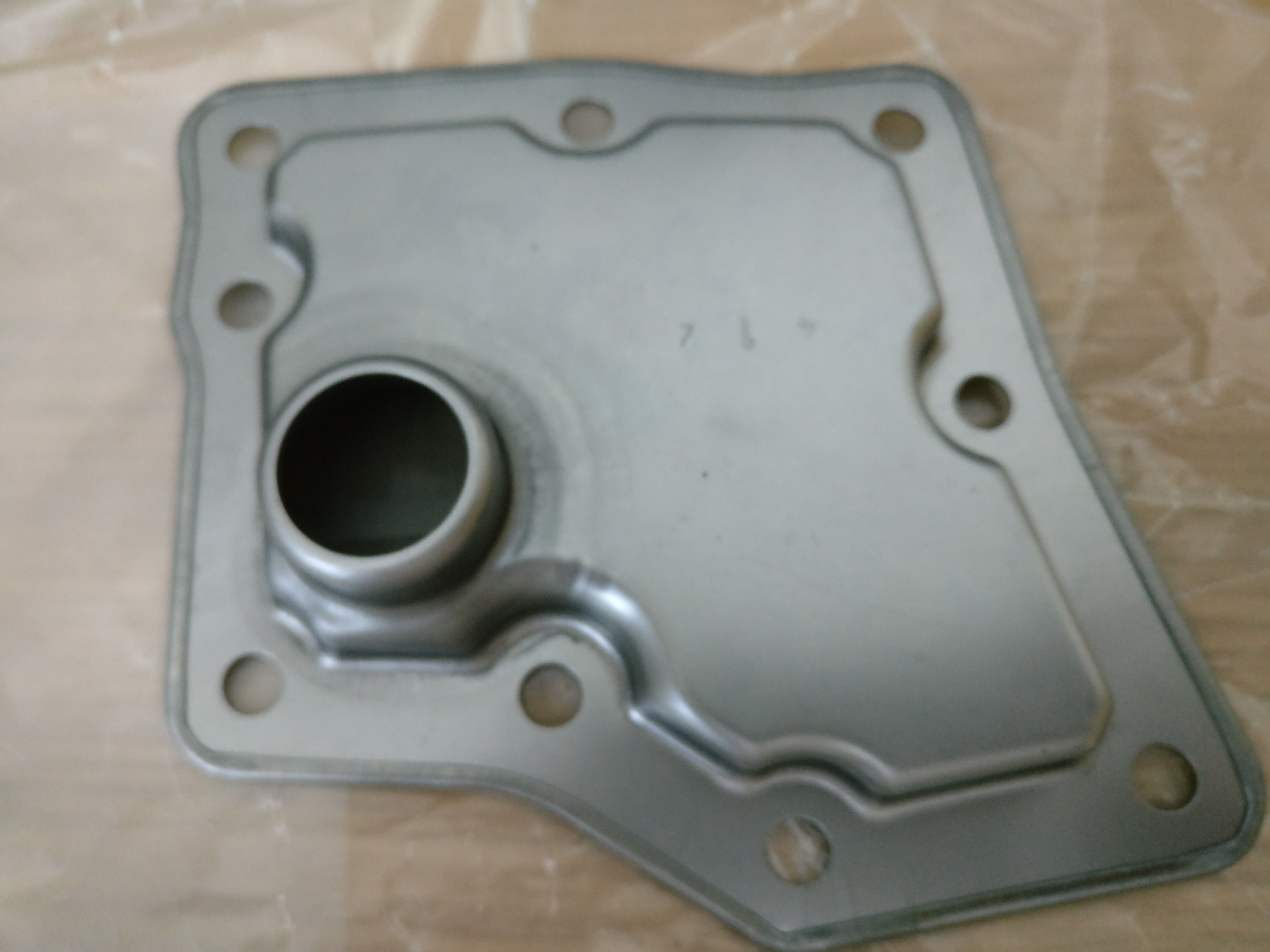

ATF filter and sump seal arrived today.
Any idea if this filter looks like the correct item?

- alexperkins
- Site Admin
- Posts: 14873
Re: Automatic fluid change
G 052 990 A2 is the oil - Febi 29934

- alexperkins
- Site Admin
- Posts: 14873
Strainer is also correct
