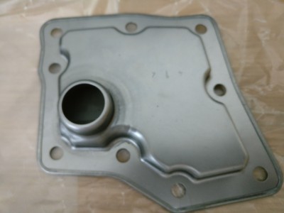

ATF filter and sump seal arrived today.
Any idea if this filter looks like the correct item?

by alexperkins
Strainer is also correct
