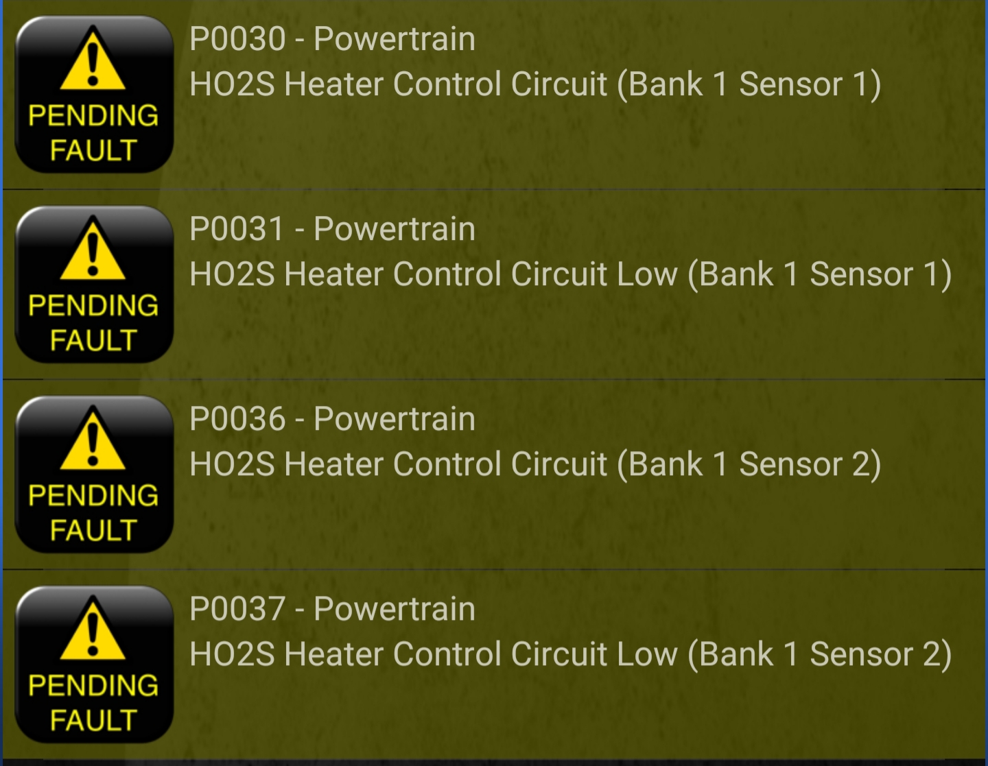

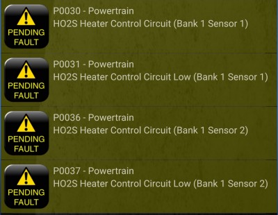

I have just ran it through my diagnostic and have the following fault codes:

It could be that the heater for either probe has developed a fault and/or blown the fuse, so just replacing a probe will do nothing, or even the wiring has been damaged and has blown the fuse or fuses.
Maybe buy a Haynes workshop manual as that should have the wiring diagrams for that engine - and that would help you find the related fuse, and see if its gone, replace it to see if it blows again as that is a cheap thing to do, then take it from there.
Edit:- probe sensor 1 bank 1 is the precat control Lambda sensor, probe sensor 2 bank 1 is the emissions monitoring/warning probe. Your car only has one cylinder bank so that is why it gets called bank 1.

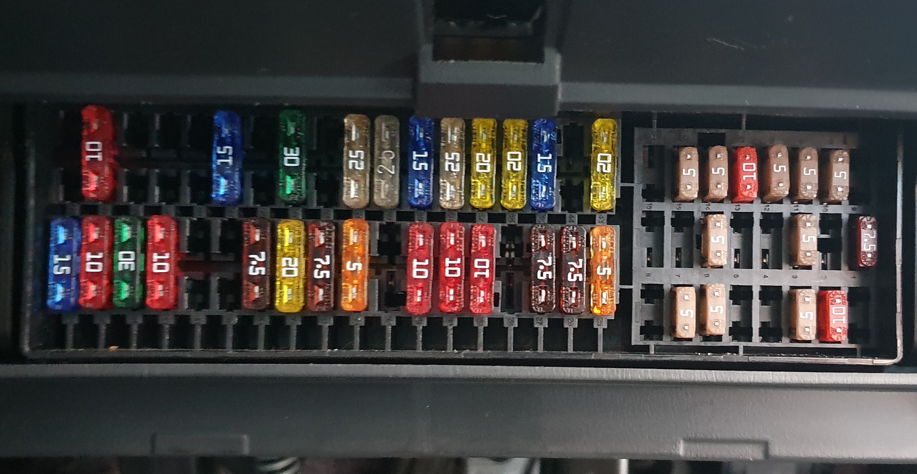

According to the following:
https://drive.google.com/open?id=0BxYPV ... m56Y19tOE0
The lambda sensors should be house in either fuse 8 or 28. Mine doesn't seem to have a fuse in either...

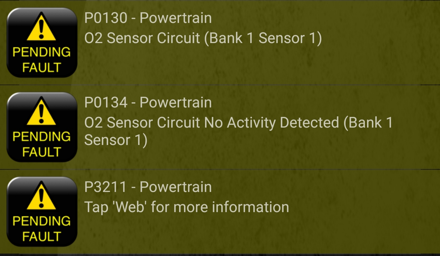

I've now put a 10a fuse in socket 28 and am receiving the following fault codes, no engine management light after 3 startups.
Any further advice?
Any further advice?
- Posts: 6078
Re: O2 Sensor Bank 1 Sensor 2
Bother, so now you have found a "fuse map" and it does not tie in with how things are in your car, not very handy! As far as that info is concerned, FS8 is for the injectors and you don't have one fitted in that slot so the engine can not run, very annoying, keep trying for other info on fuses for the 6R.
I think that VW were aware about this lack of consistent correct info and in the owner's handbook said "ask at your dealership"!

It looks to have rectified the Sensor 2 issues, so I'm wondering whether it may be an issue with the Sensor 1 upstream sensor.
I may have a look tonight, do you know exactly where it is located?
- Posts: 6078
It could well be visible under the bonnet, sticking out from the manu-cat.
