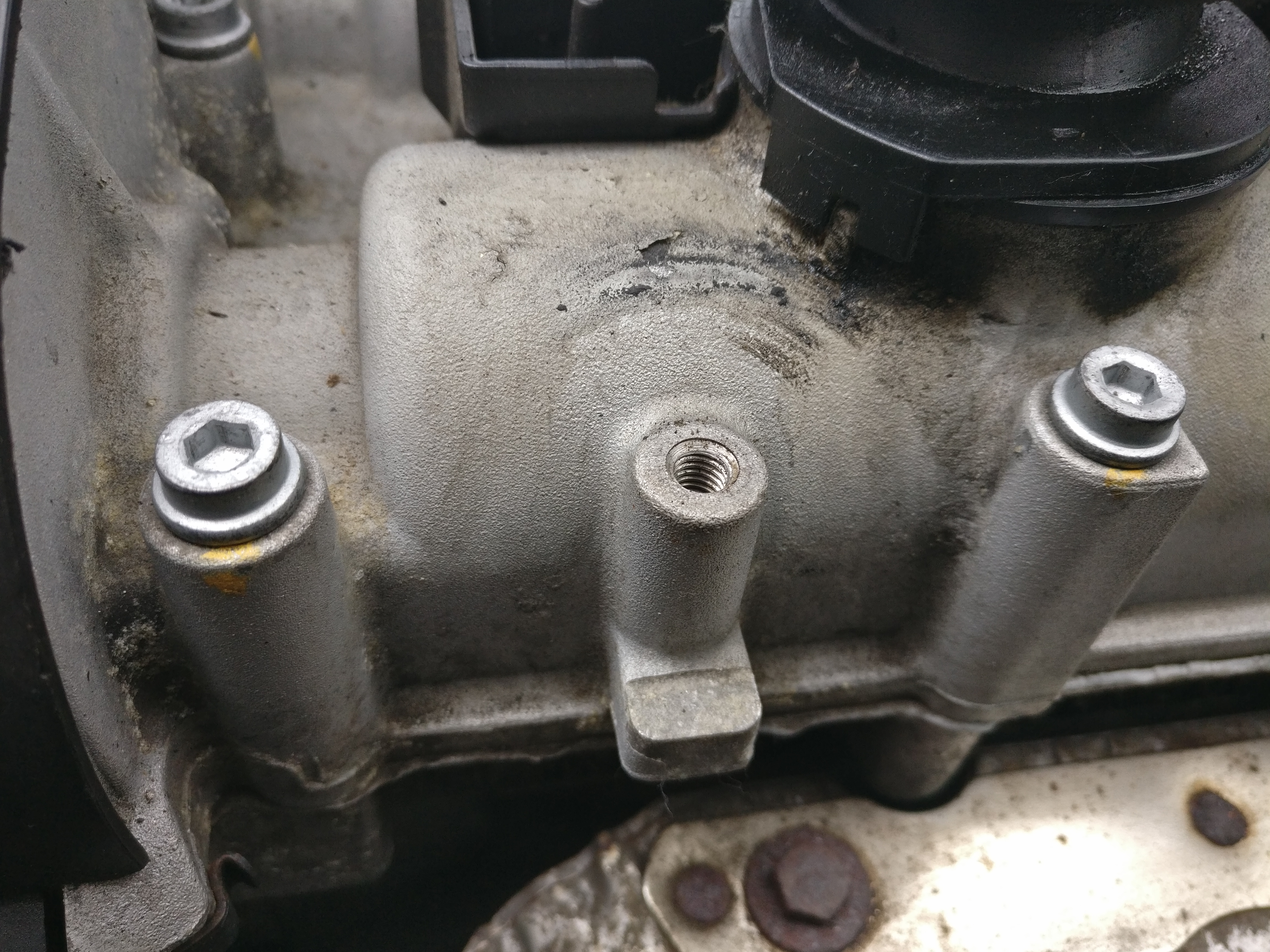

Changed my air filter today and noticed the rubber mounts for the front of the airbox were missing. This was probably an oversight when I replaced the cylinder head. If I recall correctly there is a metal stud and a rubber mount that goes atop?
Airbox rubber mount (front)
- Posts: 6090
Re: Airbox rubber mount (front)
Or maybe even a black plastic ball ended mount - the rubber donut will still be fitted into the underside of the air cleaner assembly will it not?
There will be 2 of these things on the front and 2 on the rear - from memory.
Edit:- part number for donut/STOP BUFFER is 036129689B part number for ball ended mount/STUD is 036129846 - these parts were used on most VW Group cars and vans around this period - well the engines that had the air cleaner/engine trim type of air filter assembly.
