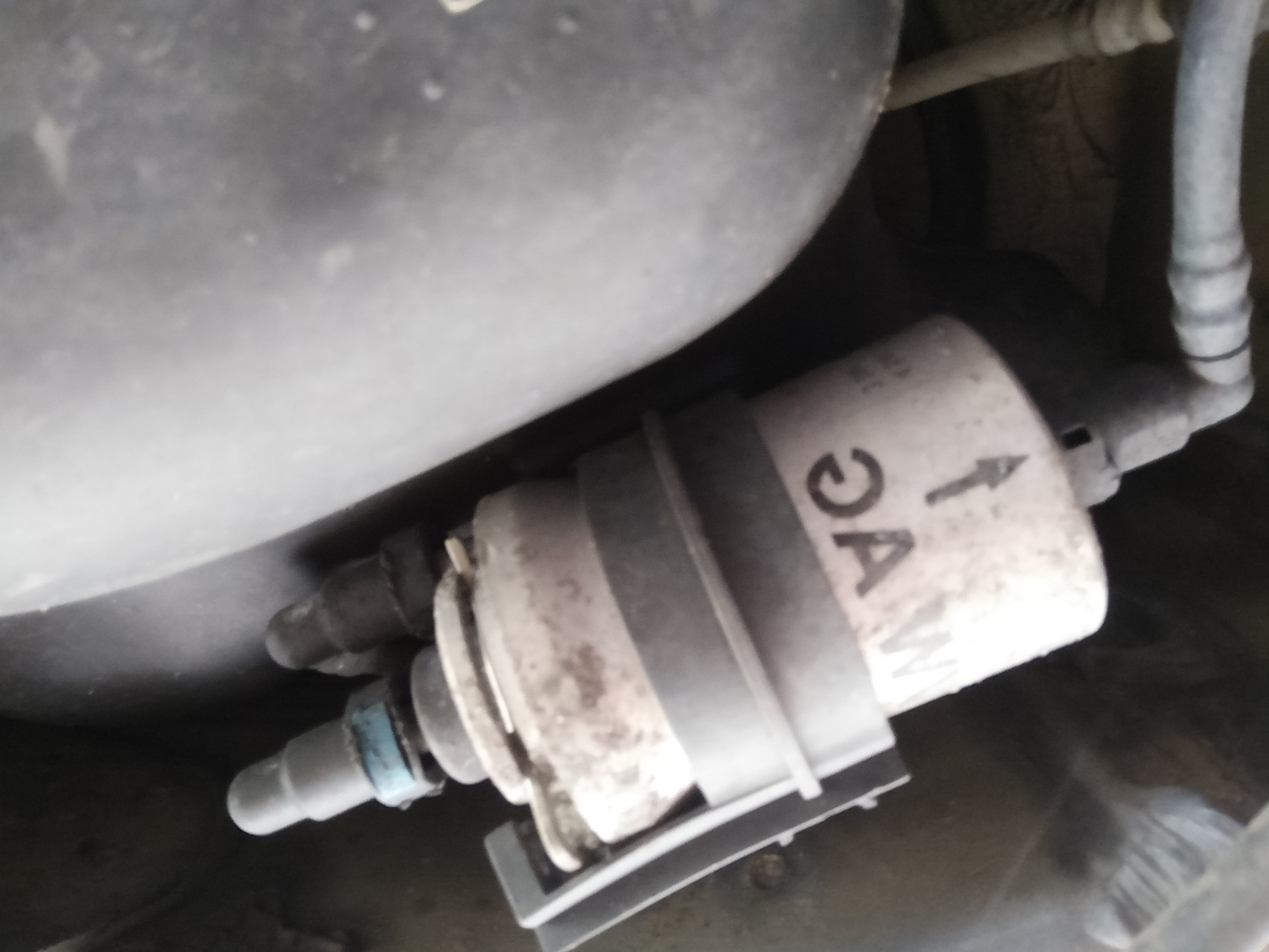

I'm going to replace the fuel filter and guessing the rating is 3.0Bar since the engine is only 75hp?
Current filter:

Yes, I have a complete set of bits but never used them, though you would be easier/cheaper buying from ECP - a single filter-regulator unit and bin the original regulator as the original plan was to just replace the filter part and that would never work 10,15 etc years down the line!

Thanks, I was looking at the Mann part WK69/1 (about £20)
