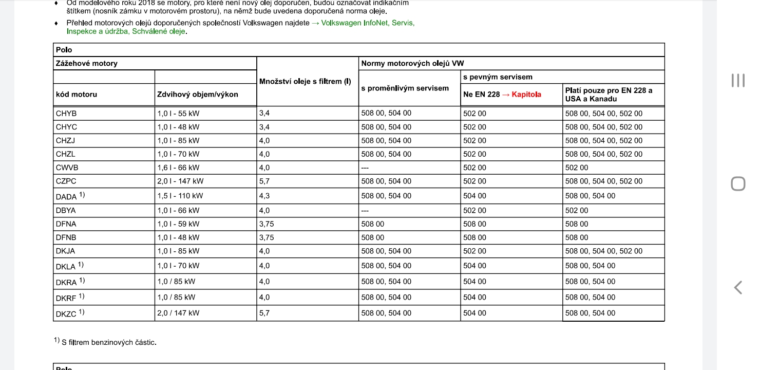

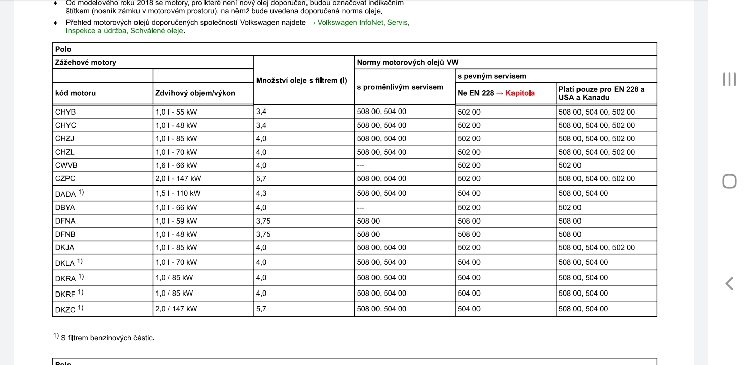

Well ... there are several options. It depends on what oil interval they setup for your car. But by official erwin document polo can use 3 grades of oil. It they setup 2years/30 000km oil change interval then 508 (0w20).

Is there not any oil info labels on the slam panel - my daughter has an April 19 reg'd SEAT Leon Cupra and it has a "504/507" label on the slam panel, so I got her to buy a "Castrol 5W-30 Prof Edge" top up pack to keep in the car. I've never worked out how/why VW Group has always been a bit vague in term of exactly which spec and weight of oil that they say is what your car needs. I was quite glad to see that SEAT had at least pointed out which spec of oil to use. That SEAT Leon Cupra's engine is be to the original new testing regs, so maybe you asking about a car that conforms to the later, and current testing regs/requirements, and that is why the lower viscosity 508 oils are being spec'd for it.
Edit:- mind you, even that table above allows for 508 or 504.

Yeah ... you are right ... Lately I feel like Iam blind or stupid

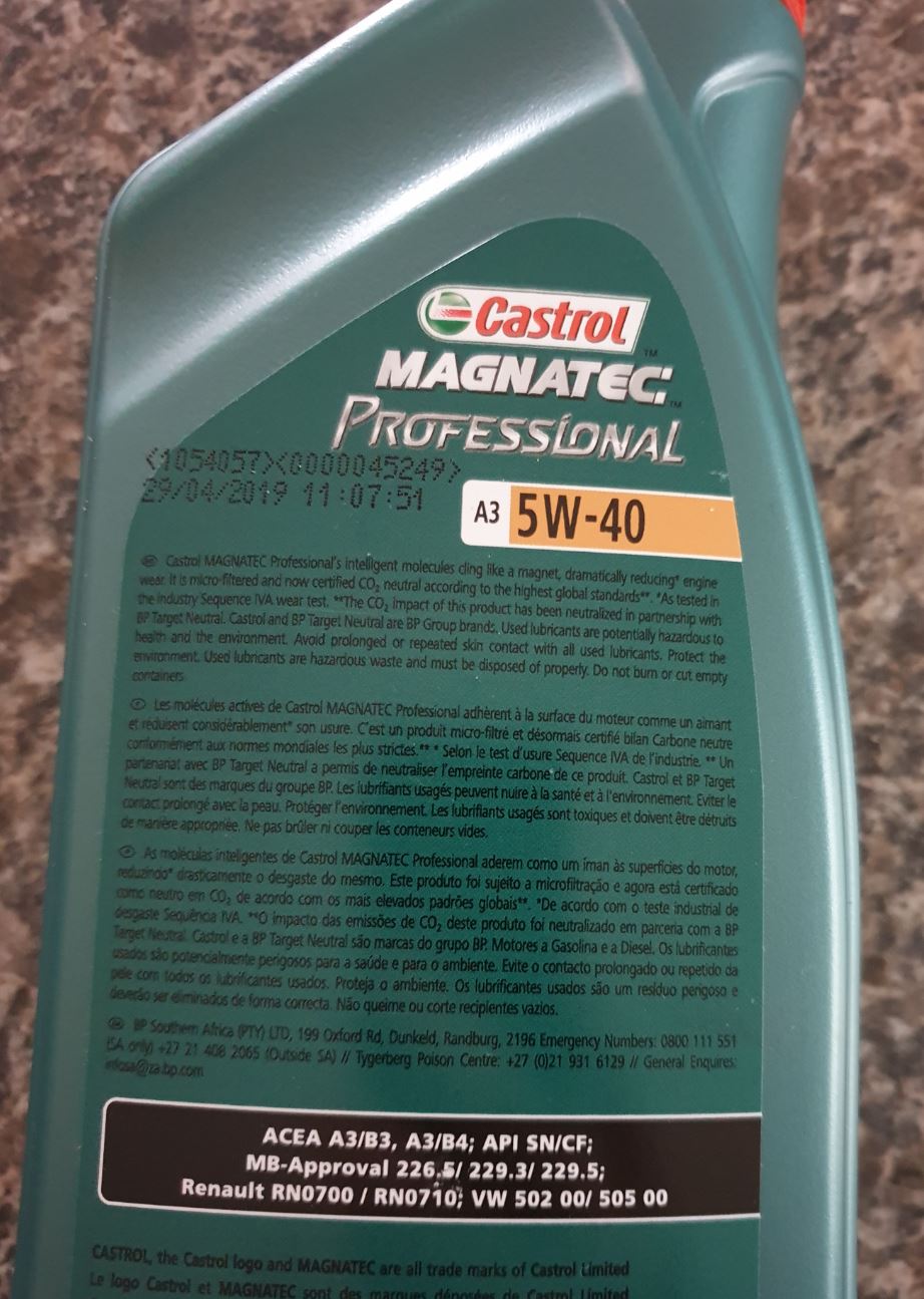

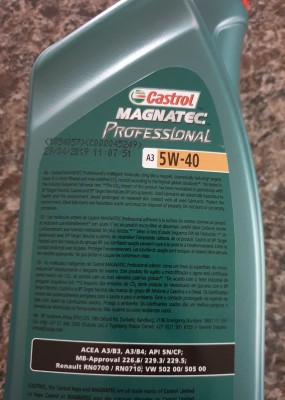

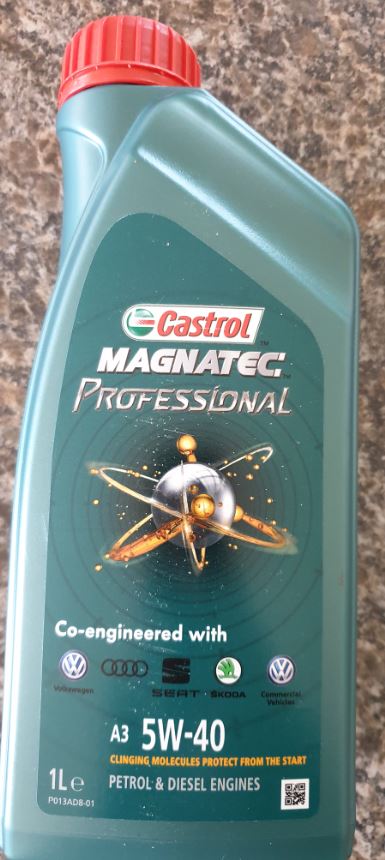

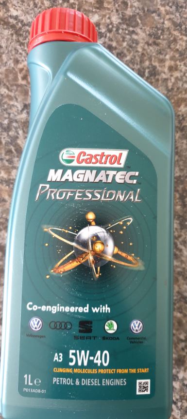

With all this chit chat re oil I went and bought a top 1L from my VW dealer who asked what I drove then presented me with this:
5w40
5w40

How much did VW want for that oil?OomStu_ZA wrote: Sun Sep 22, 2019 1:11 pm With all this chit chat re oil I went and bought a top 1L from my VW dealer who asked what I drove then presented me with this:
5w40

If you drive a Polo AW, that's not the correct oil grade. You should use 0w20 longlife oil. Unless your car is set to a fixed interval (every 15000 km) on your instigation.
It's all in your manual.

About 200 bucks ZAR so like 10/11 quid?Steve_2019 wrote: Sun Sep 22, 2019 3:21 pmHow much did VW want for that oil?OomStu_ZA wrote: Sun Sep 22, 2019 1:11 pm With all this chit chat re oil I went and bought a top 1L from my VW dealer who asked what I drove then presented me with this:
5w40

See the worry in my eyesRosinfield wrote: Sun Sep 22, 2019 3:41 pm If you drive a Polo AW, that's not the correct oil grade. You should use 0w20 longlife oil. Unless your car is set to a fixed interval (every 15000 km) on your instigation.
I also have the ext motor plan to 100 000 KM's although I only keep cars for 2 - 3 years but get very close to the 100K in that time.

I agree that that choice of oil from VW dealership is a slightly weird, normally, only normally, Castrol oils in green packaging and with only Magnetec in the name, are cheaper oils for older cars, this one is also titled as being Professional, so it will also contain a fluorescent marker dye, and as it is 5W-40 I'd guess that it also has 502 as the quoted VW Group oil spec seeing as it has been developed in conjunction with VW Group.OomStu_ZA wrote: Sun Sep 22, 2019 1:11 pm With all this chit chat re oil I went and bought a top 1L from my VW dealer who asked what I drove then presented me with this:
5w40
So, what is the VW oil spec quoted on the other side of that oil container - I'd expect an oil suitable for adding as top up only, to any current VW Group car would be Castrol Edge Professional 5W-30 and come in a gold coloured container and have 504 and 507 rating shown on the rear?
Edit:- the price does seem near enough, probably £13>£14 in UK.

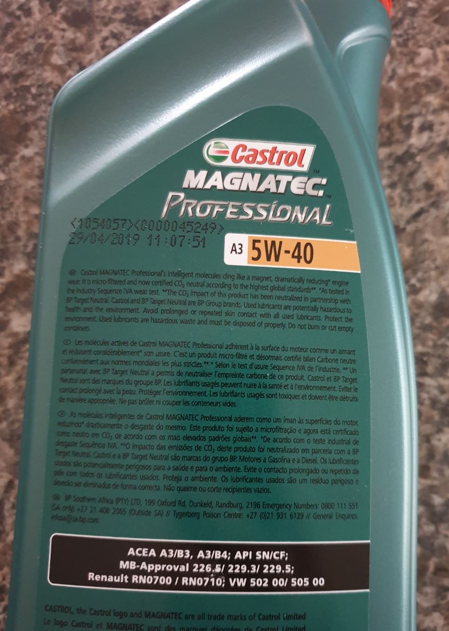

Interesting I see it refers to 502:RUM4MO wrote: Sun Sep 22, 2019 4:46 pmI agree that that choice of oil from VW dealership is a slightly weird, normally, only normally, Castrol oils in green packaging and with only Magnetec in the name, are cheaper oils for older cars, this one is also titled as being Professional, so it will also contain a fluorescent marker dye, and as it is 5W-40 I'd guess that it also has 502 as the quoted VW Group oil spec seeing as it has been developed in conjunction with VW Group.OomStu_ZA wrote: Sun Sep 22, 2019 1:11 pm With all this chit chat re oil I went and bought a top 1L from my VW dealer who asked what I drove then presented me with this:
5w40

Ouch, a VW main dealer handing a 502 spec oil out for use on a modern engine, now that is not very clever, better than nothing though. That oil was what was used back in 2000 and maybe up to 2006 on some low output/low tech engines. Gold packaged 504 is better all round and more acceptable for modern engines and as a stop gap/top up for 508 spec'd engines.OomStu_ZA wrote: Sun Sep 22, 2019 5:20 pmInteresting I see it refers to 502:RUM4MO wrote: Sun Sep 22, 2019 4:46 pmI agree that that choice of oil from VW dealership is a slightly weird, normally, only normally, Castrol oils in green packaging and with only Magnetec in the name, are cheaper oils for older cars, this one is also titled as being Professional, so it will also contain a fluorescent marker dye, and as it is 5W-40 I'd guess that it also has 502 as the quoted VW Group oil spec seeing as it has been developed in conjunction with VW Group.OomStu_ZA wrote: Sun Sep 22, 2019 1:11 pm With all this chit chat re oil I went and bought a top 1L from my VW dealer who asked what I drove then presented me with this:
5w40

this makes me wonder what they actually put into your engine at service time because there oil is dispensed through a nozzle meaning the mech...associate doesn't probably have a clue either.
I've sent an email to VW customer care (at factory) and await their reply in this regard.

Hello guys i have polo 1.0 2019 and here in Greece dealers use 5w40 magnatec professional too.
