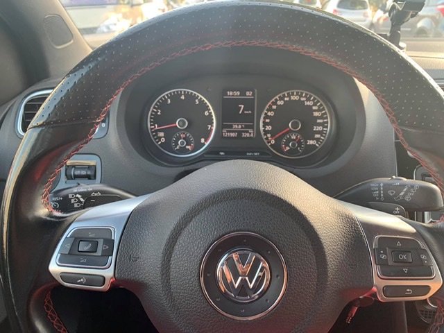

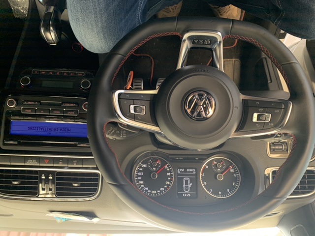

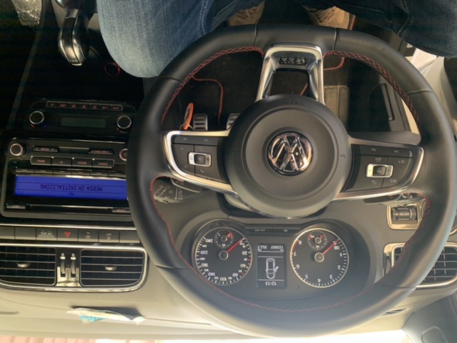

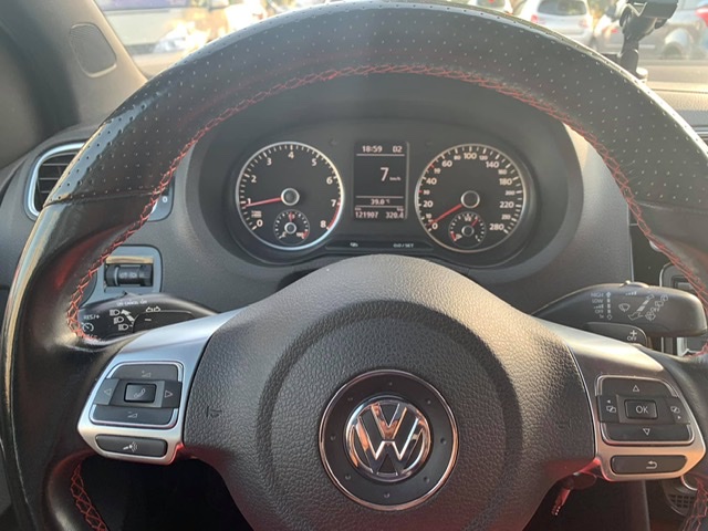

I have 6R GTI 2011 and retrofit the SW. just 2 buttons works...no horn, no light, no mfa, no volume... luckily the shiftpads work. Any solutions?
- Posts: 6695
Re: mfsw on polo 6r
I see you have the Australian spec wheel on the bottom picture.
Do you maybe have the coding of the old wheel? For the button backlights you need to replace your bcm.
A tool like vcds would be helpful
