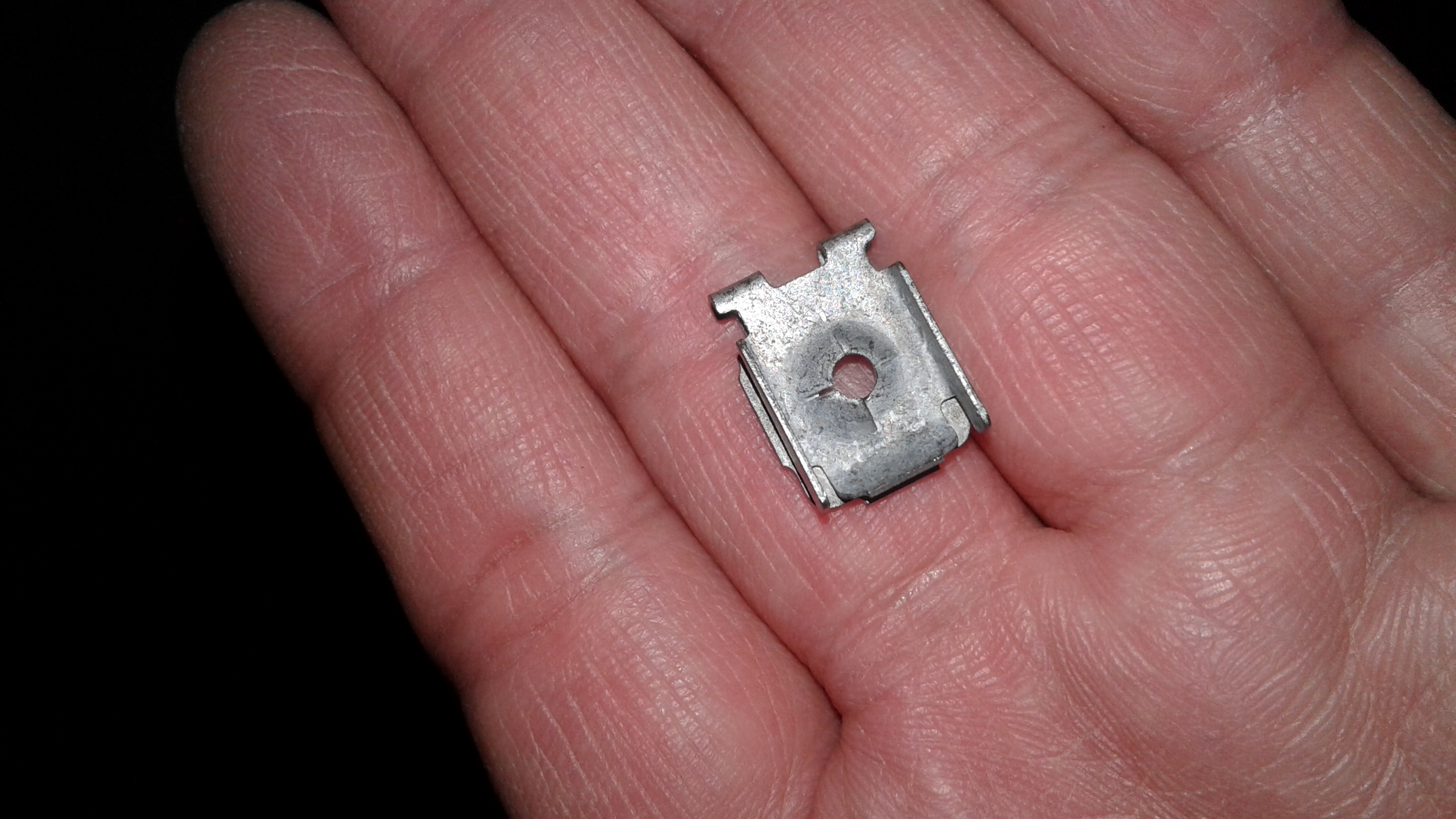

I have my AW Polo (1.6 Conceptline) for about 2 months now, the car is assembled in South Africa in August 2019.
Whenever I drive into a corner I will hear a marble rolling noise from the tailgate section, I don't brother to waste my time taking it back to the VW dealers.
I strip the interior trim of the tailgate and I found this clip running free in the tailgate:
I guess the guy who assemble my Polo dropped this clip in the tailgate and just leave it there.
You could have a similar problem.

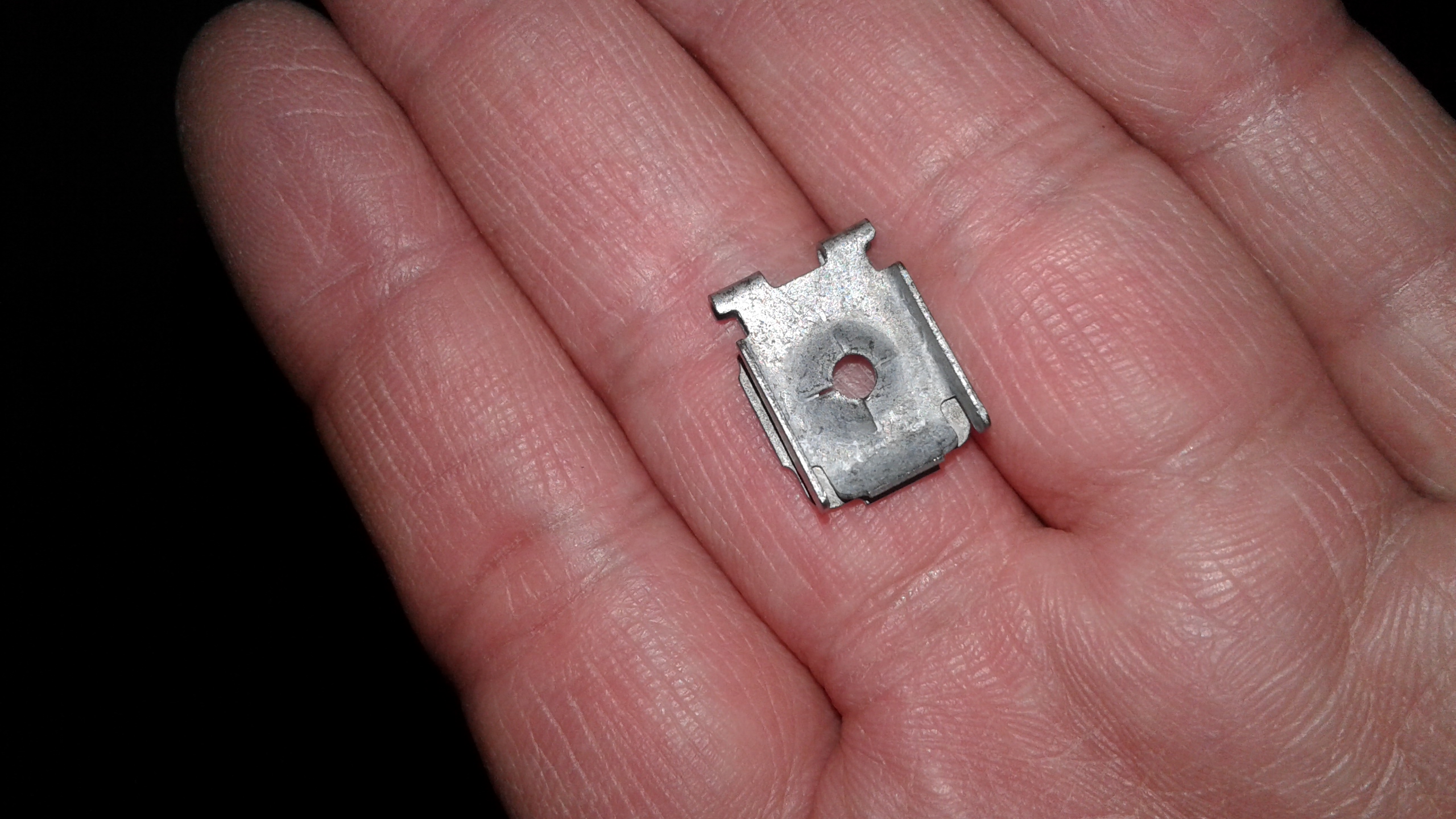

I can imagine a worker at assembly line droping this clip while putting them on a was like "meh, warranty will solve that"ho8882000 wrote: Wed Oct 30, 2019 6:07 pm I have my AW Polo (1.6 Conceptline) for about 2 months now, the car is assembled in South Africa in August 2019.

Dark_cze wrote: Fri Nov 01, 2019 1:21 amI can imagine a worker at assembly line droping this clip while putting them on a was like "meh, warranty will solve that"ho8882000 wrote: Wed Oct 30, 2019 6:07 pm I have my AW Polo (1.6 Conceptline) for about 2 months now, the car is assembled in South Africa in August 2019.
You could have a similar problem.![]()
This is why the assemble quality of the Polo from South Africa is not great, it is this kind of bad working attitude of another man's problem.
