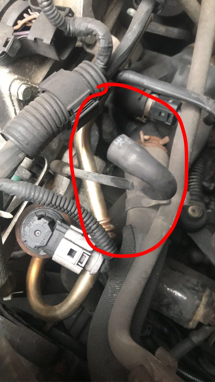

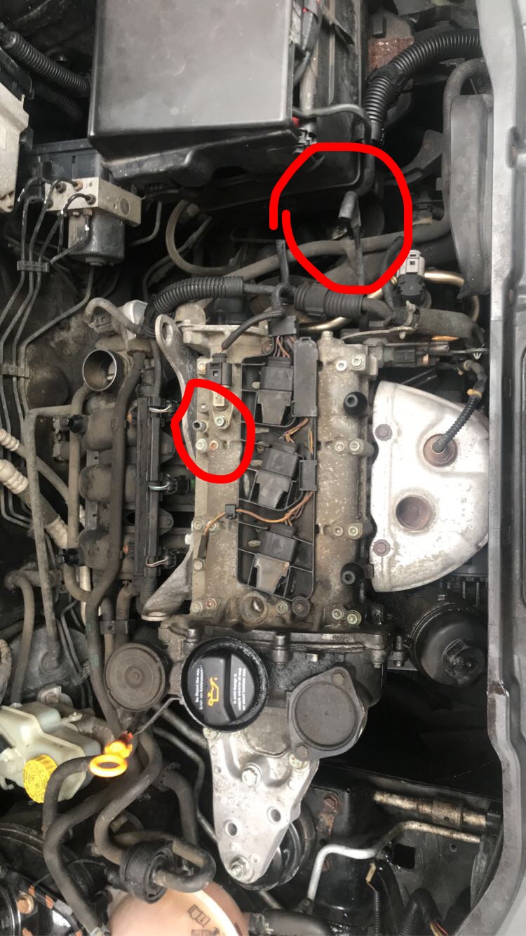

I’m just wondering what this pipe does, it connects into my air filter box/engine cover. I have put in a cold air intake but need to have a filter on the breather pipe. Is it necessary to have this pipe being filtered? If so could I join the pipe from the cam cover to this pipe and then up to a air filter ?

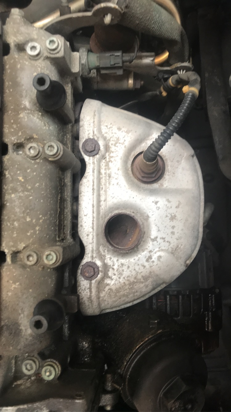

Also does anyone know what this hole is for on the silver box ?
What does this pipe do on my air filter box

The hole on top of the engine on the valve cover is the PCV. The other hose seems to be a vacuum line to the EGR system (not sure what it does) and the hole on top of the exhaust manifold heat-shield is where the intake takes hot air from to prevent icing in cold conditions. There’s a small valve in the engine cover which you’ll see a tube coming from that will fit into that hole. Hope that helps.

Thank you so much, couldn’t find what they were anywhere. Is it necessary to have these pipes being filtered . I have an air filter fitted to the throttle body but will it do any harm if the other small pipes aren’t being filtered?

I think these breather pipes are filtered essentially for emissions controls.

Most people have 2 bungs put onto their intake pipe and either put the PCV straight in or through a catch can then connect the vacuum hose for the EGR. Not sure what effect it will have if they are not connected. The PCV will just vent oily residue and the EGR may not work as intended.
