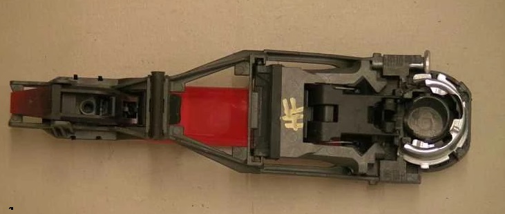

Problem = the door lock cylinder does not stay in the handle, hence it is easy to pull out which is clearly not great
Cause = A little investigation and I've discovered that the T20 bolt that you can access from the edge of the door has been replaced by a pointless small headed bolt (by some idiot before me !) and so the collar around the lock barrel never spins to retain the actual lock (If you look at the attached image, you can see the bolt in question to the top right).

The screw head rotates the barrel locking ring, seen in the OP picture in silver it’s like a C shape
Prone to falling out and landing in the bottom of the door if undone too far

As CarbonChaos says, it’s the T20 screw seen top right in original photo that turns the silver locking ring (silver C shape in top image). If you remove the rubber bung in the side of the door, shine a torch in you be able to see the screw (or lack there of I suspect).
Sadly to repair it requires the inner door card (the plastic trim) to be removed and then the inner steel door panel as well. Trim is fiddly but ok, whilst the steel door also requires the window to be removed, as the lifting mechanism is part of that steel panel which suddenly becomes an ever bigger job.
All in, a massive job all because some bright spark loosened the screw too far originally and hence it fell out !!
