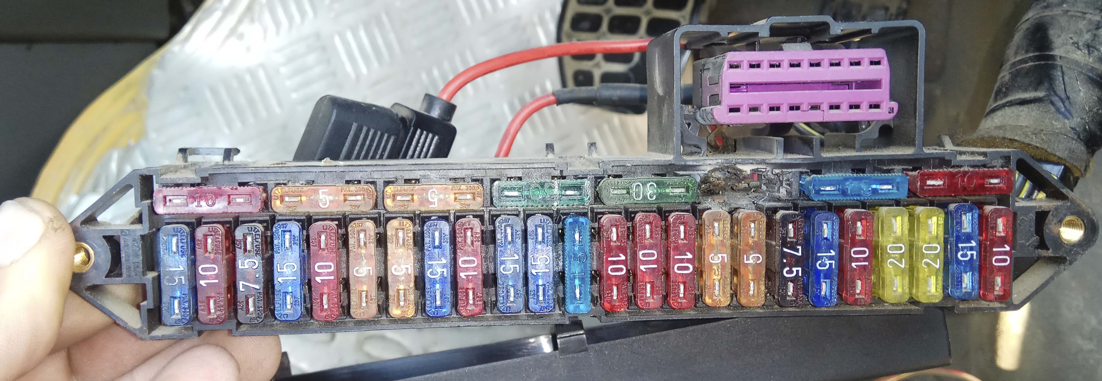

hello i have a 1997 polo with 1.4 engine, the fuel pump is not working i have located the fuse via haynes manual and it was burnt i replaced it but no power is going to the fuse so it must be a relay problem. i can not find any guide as to where is the fuel pump relay. i have attached two photos the first is the fuse bank

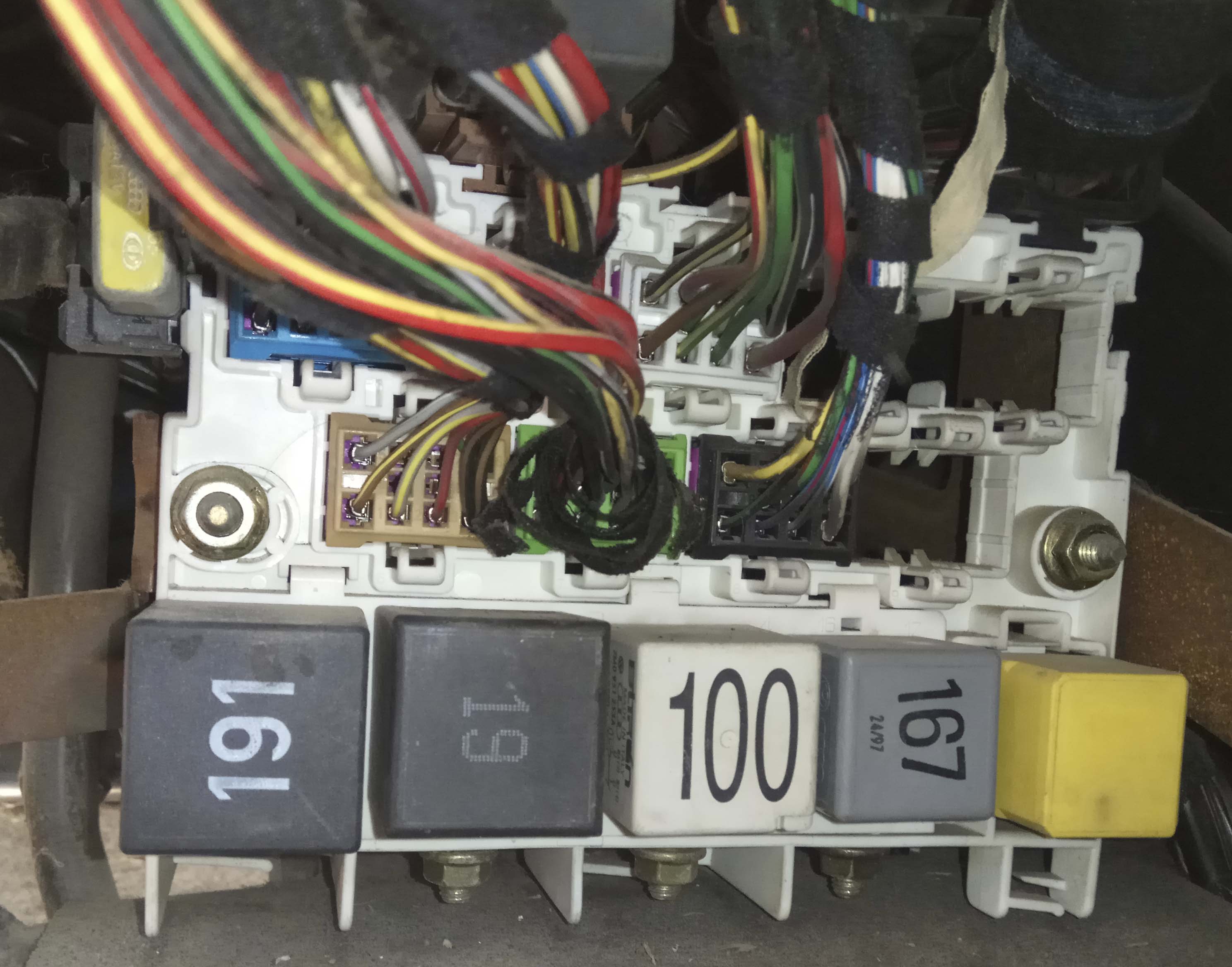

and the second is the relay bank
that sits behind the fuse bank , can someone please tell me which relay is the fuel pump relay so that i can check it .thank you very much for your help.

Welcome
167 is the fuel pump relay
