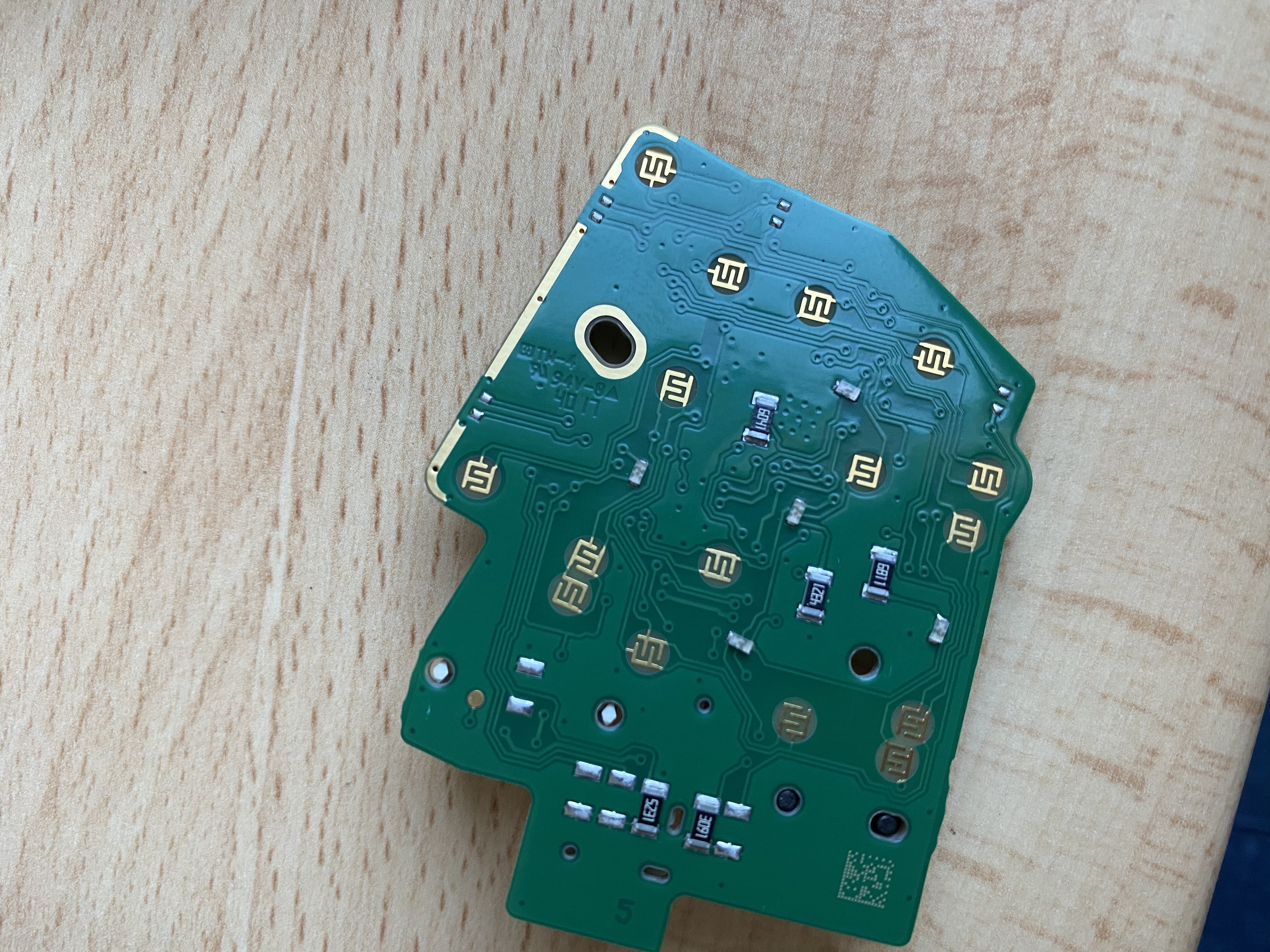

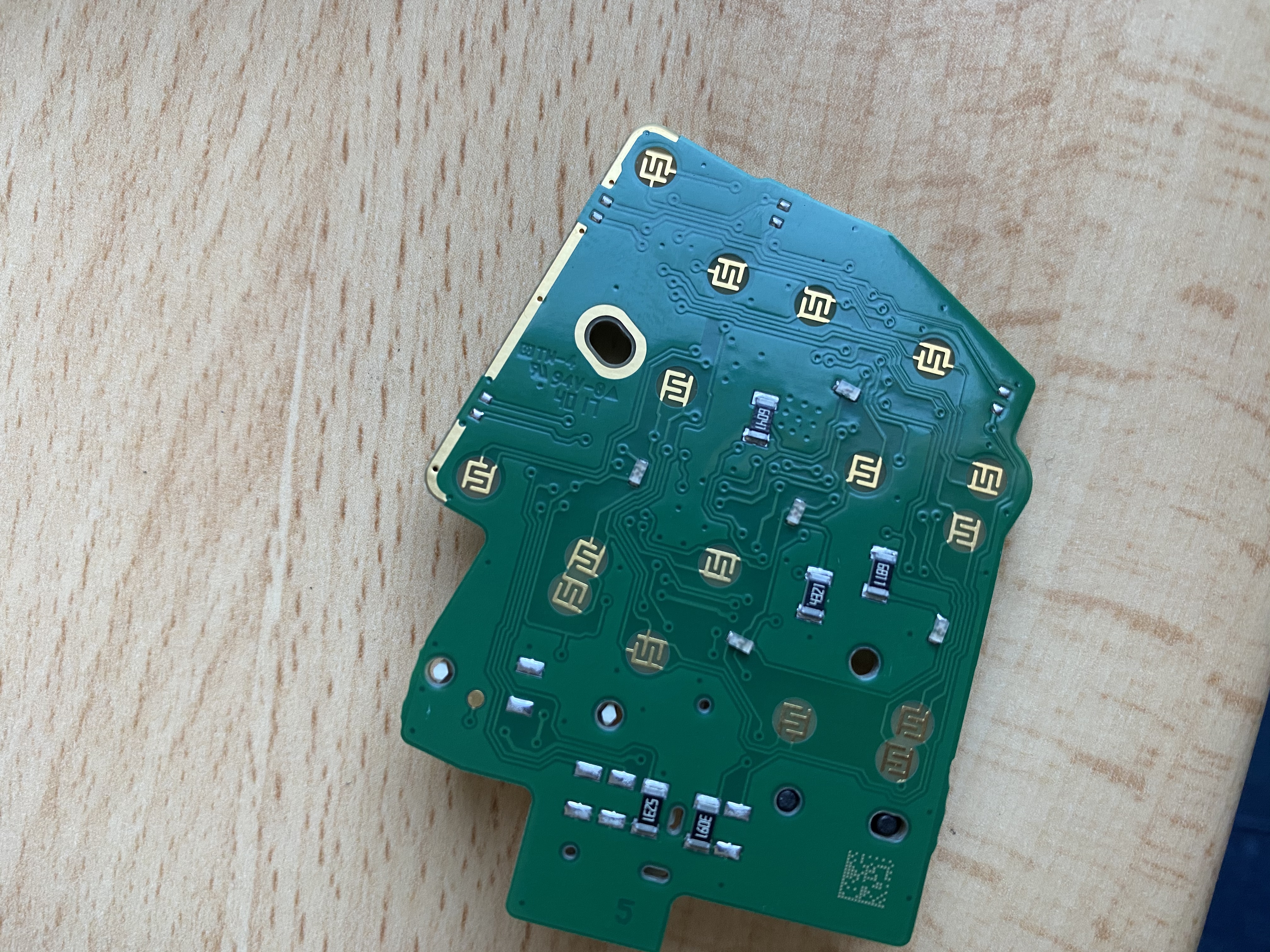

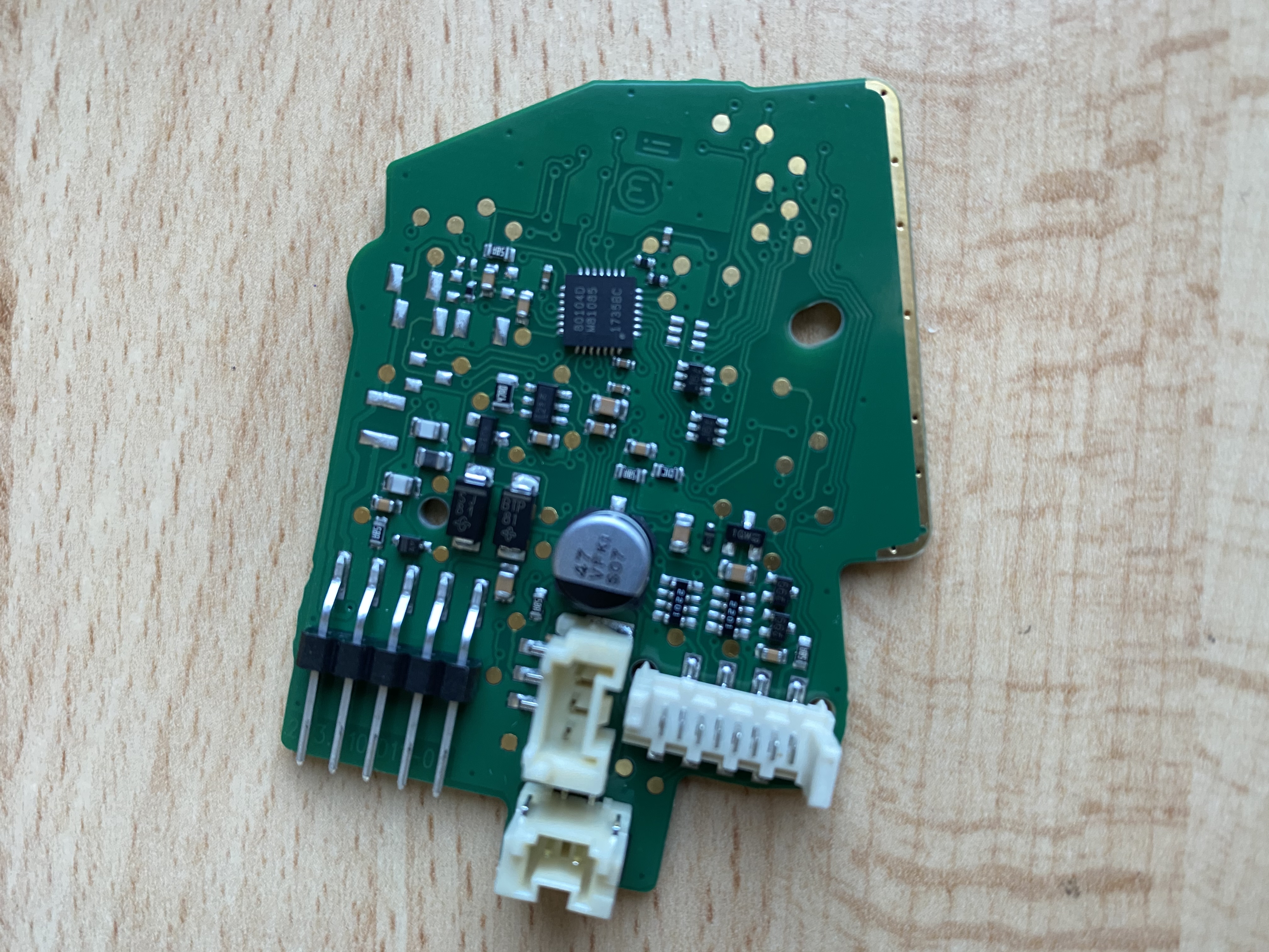

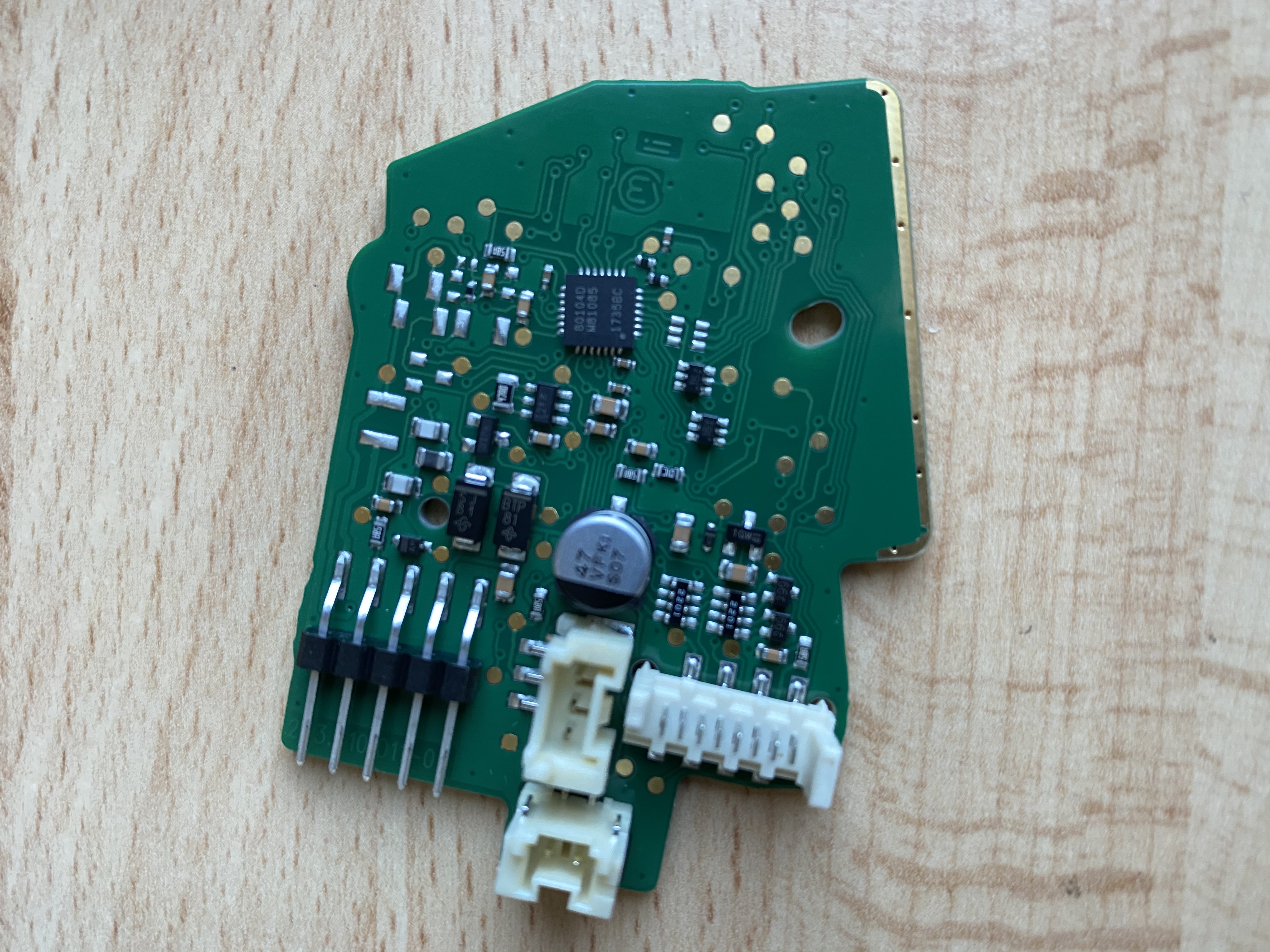

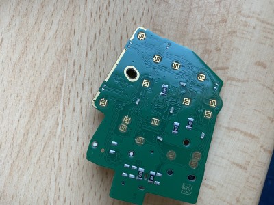

I have fitted a MSFW from an Up!, which fits and the buttons work too, just no light.
Found this guide last night on 1k8 buttons. : https://www.mk5golfgti.co.uk/forum/inde ... 12.45.html
This wheels buttons is 2h0 959 442, and is slighty different to the 1k8, my question is, does anyone know where solder on this part? :D
2h0 959 442
2h0 959 442
2h0 959 442 back
2h0 959 442 back

Did you ever find the answer, I'm in the exact same area as you are/were. Can you help me out?
I have the one side working but not the other.

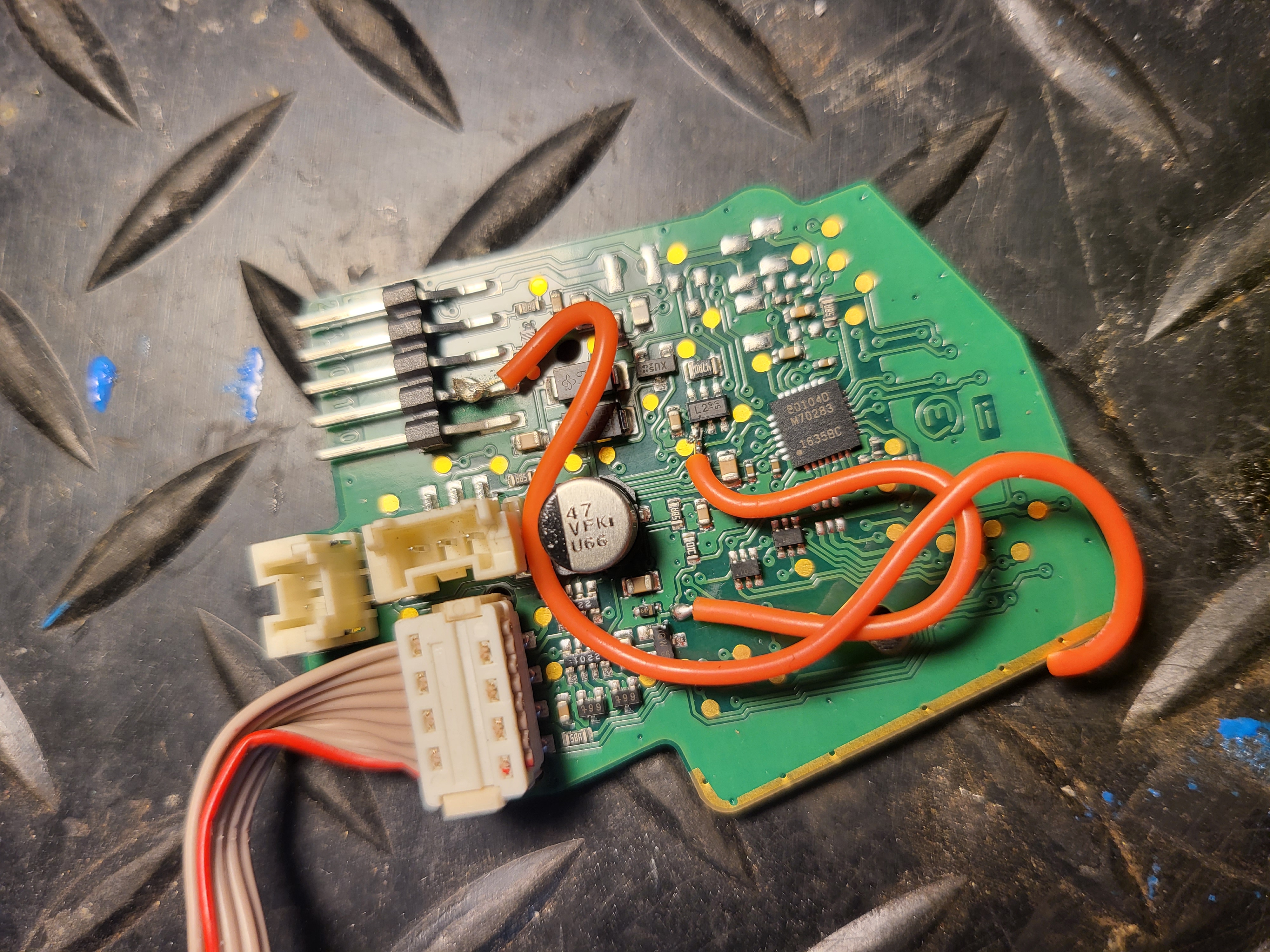

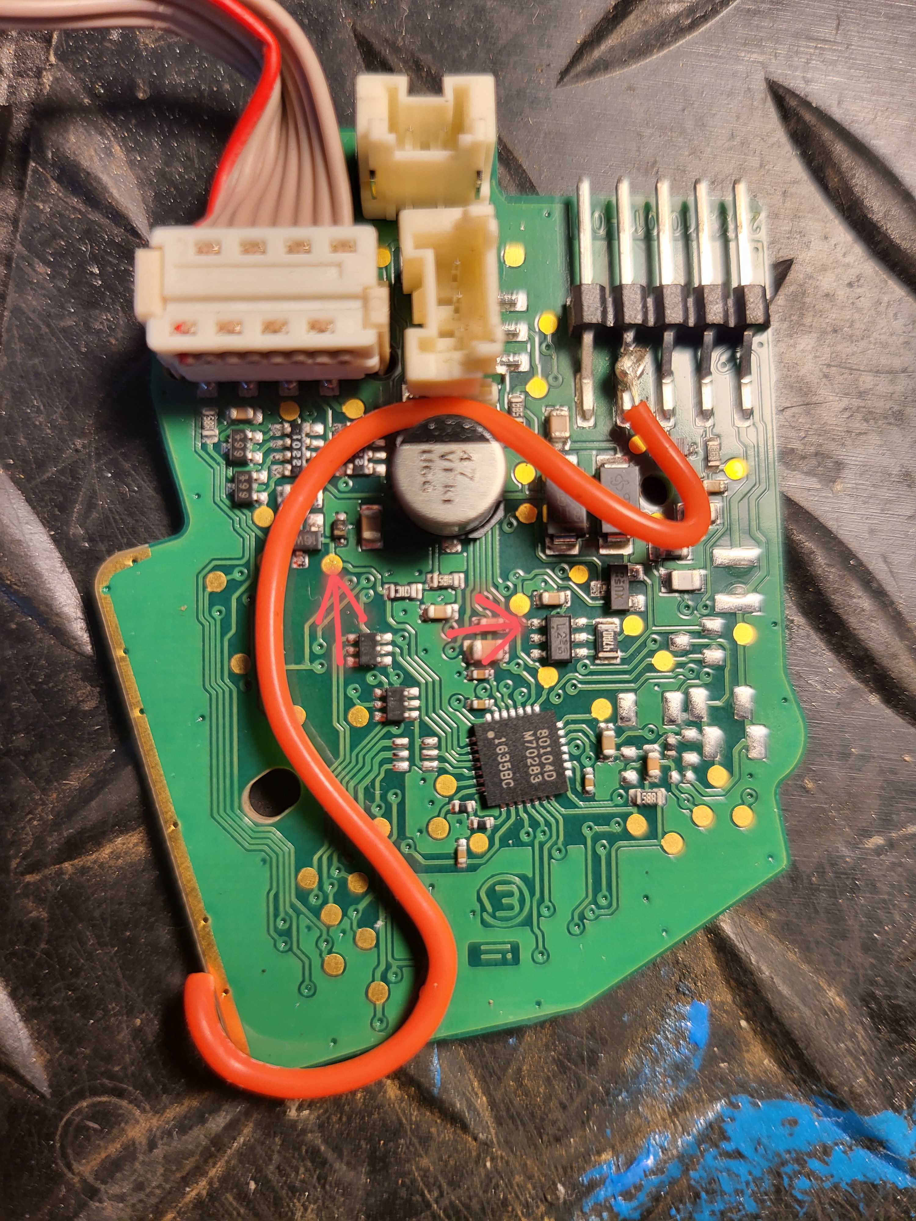

***SOLVED***
OK, just incase anyone else comes across this for help. I worked out where the second wire needs to be attached to get both sets of lights to work.
PLEASE NOTE, the is for unit No. 2H0959442
