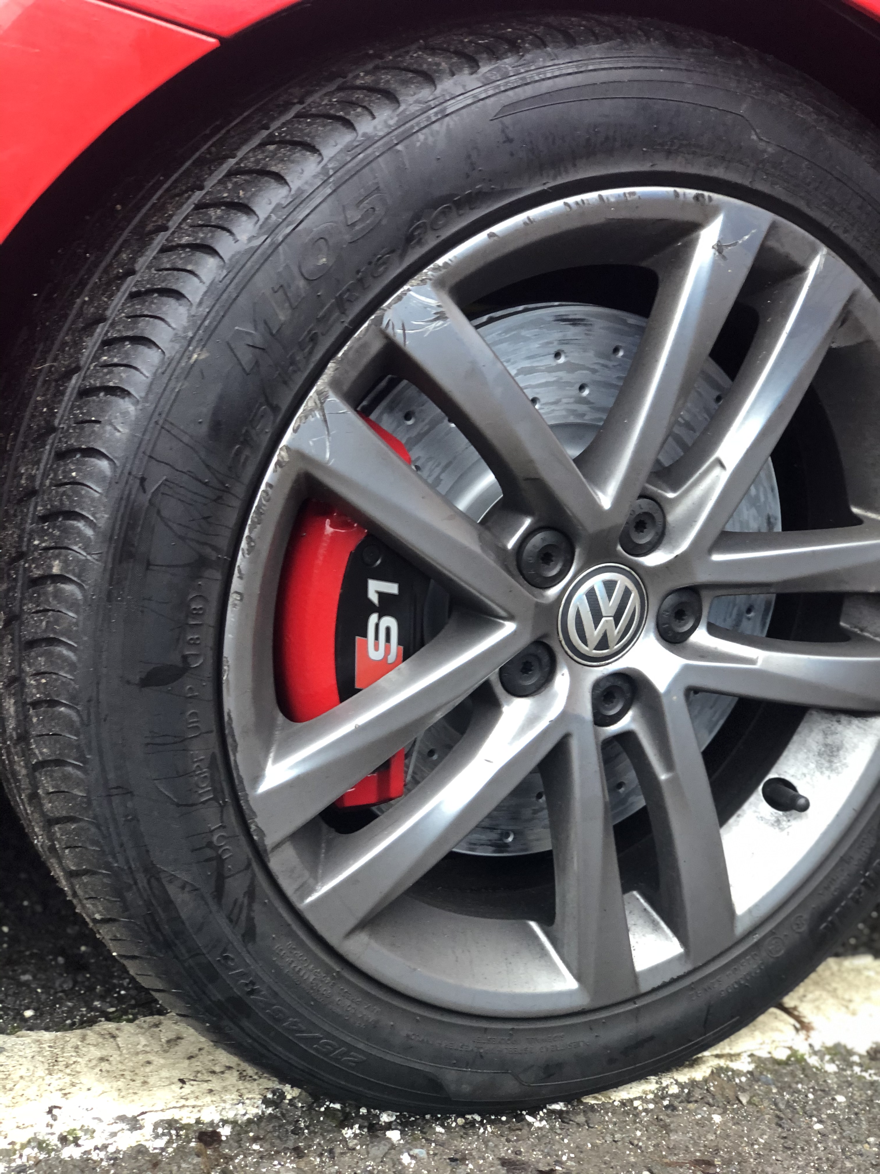

Posted: Tue Jan 26, 2021 7:06 pm
by iichel
perhaps if you take off the audi sticker, it will work ;)
Re: ABS Coding after upgrading brakes
Posted: Tue Jan 26, 2021 7:26 pm
by jackb57
Maybe sticking a VW sticker over the top they would want to work? :lol:
Posted: Tue Jan 26, 2021 7:43 pm
by iichel
Worth a shot, isn't it?
