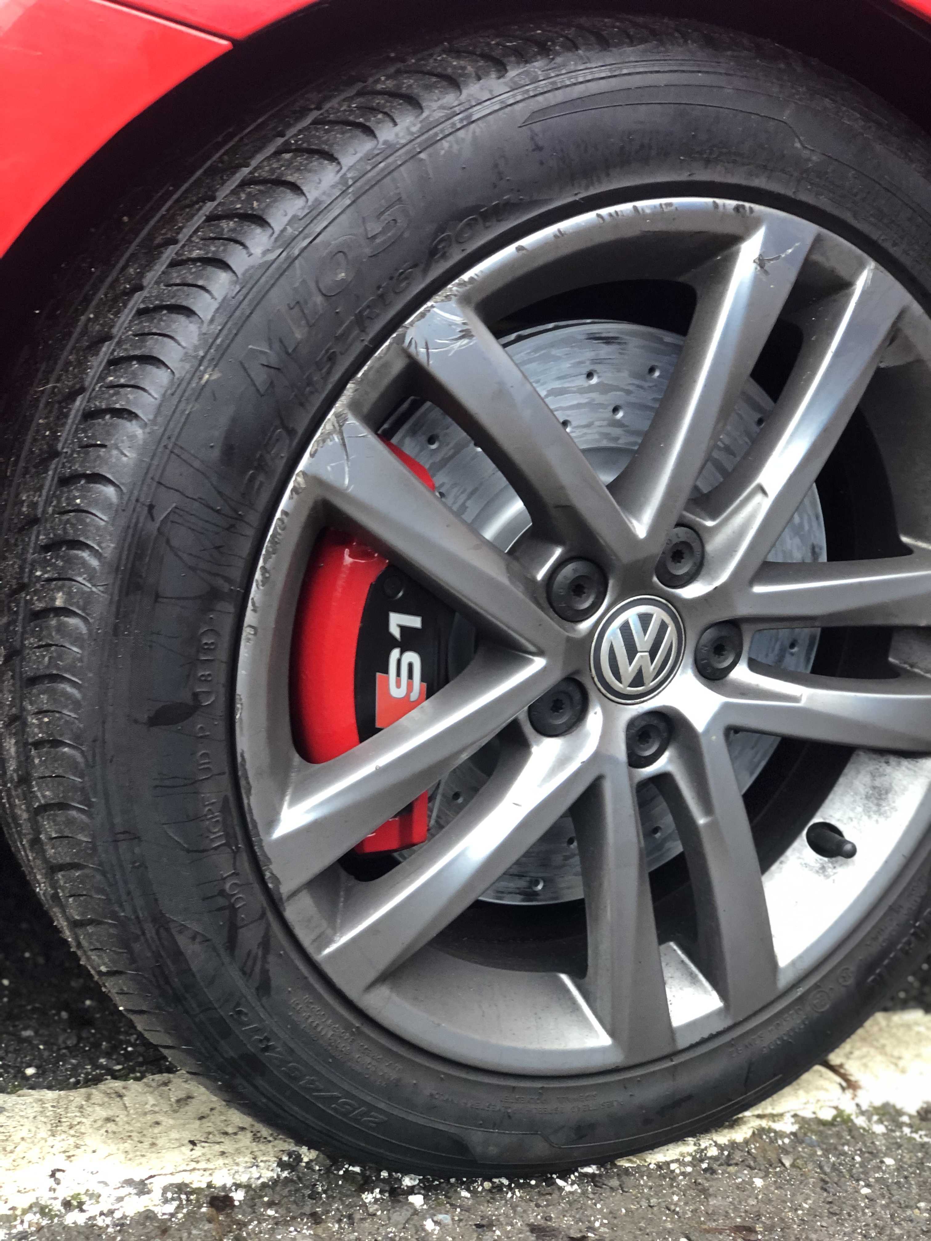

Hi I’ve just changed my front brakes on my r line from 256 to 288
This is my code:
23DD2885492333C9091A10700059C41492CC90080005CB098F00
I’ve tried changing byte 2 to 48 and byte 10 to 12 but that coding wasn’t accepted?
This is my code:

Never mind, I got it. Your car is a 6C. Please change the coding to:
23DD4885492333C9091A10700059C41292CC90080005CB098F00

Hello i tried your code and it was accepted!
i will be doing the upgrade to 312 brakes once these have run their course, whilte i have your attention could i bother you for that code too?

Finally got these 312 on and struggling again to find the code I need
I had 288/230 on now 312/230
23DD4885492333C9091A10700059C41292CC90080005DB098F00
I’ve tried changing byte 2 to 68 and byte 15 to 16 but no luck

Also tried changing byte 2 to 68 and byte 10 to 16 to no avail.
Reading other posts this could be a problem...
with a 2016 Polo 1.2 TSI R-Line is it even possible to code the ABS Module for this combination of brakes?
If this turns out to be true might I be better off upgrading rears to 270mm to keep the braking balance?

I think it's only available with the correct engine power class (GTI).

These look so good want them to work good too!
- Posts: 6693
Re: ABS Coding after upgrading brakes
perhaps if you take off the audi sticker, it will work
jackb57
- Posts: 11
- Joined: Tue Jul 25, 2017 6:33 pm
- Drives: 6R 1.2 TSI R-line 130hp
- Location: Darlington
Maybe sticking a VW sticker over the top they would want to work?
- Posts: 6693
Worth a shot, isn't it?
