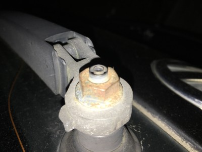

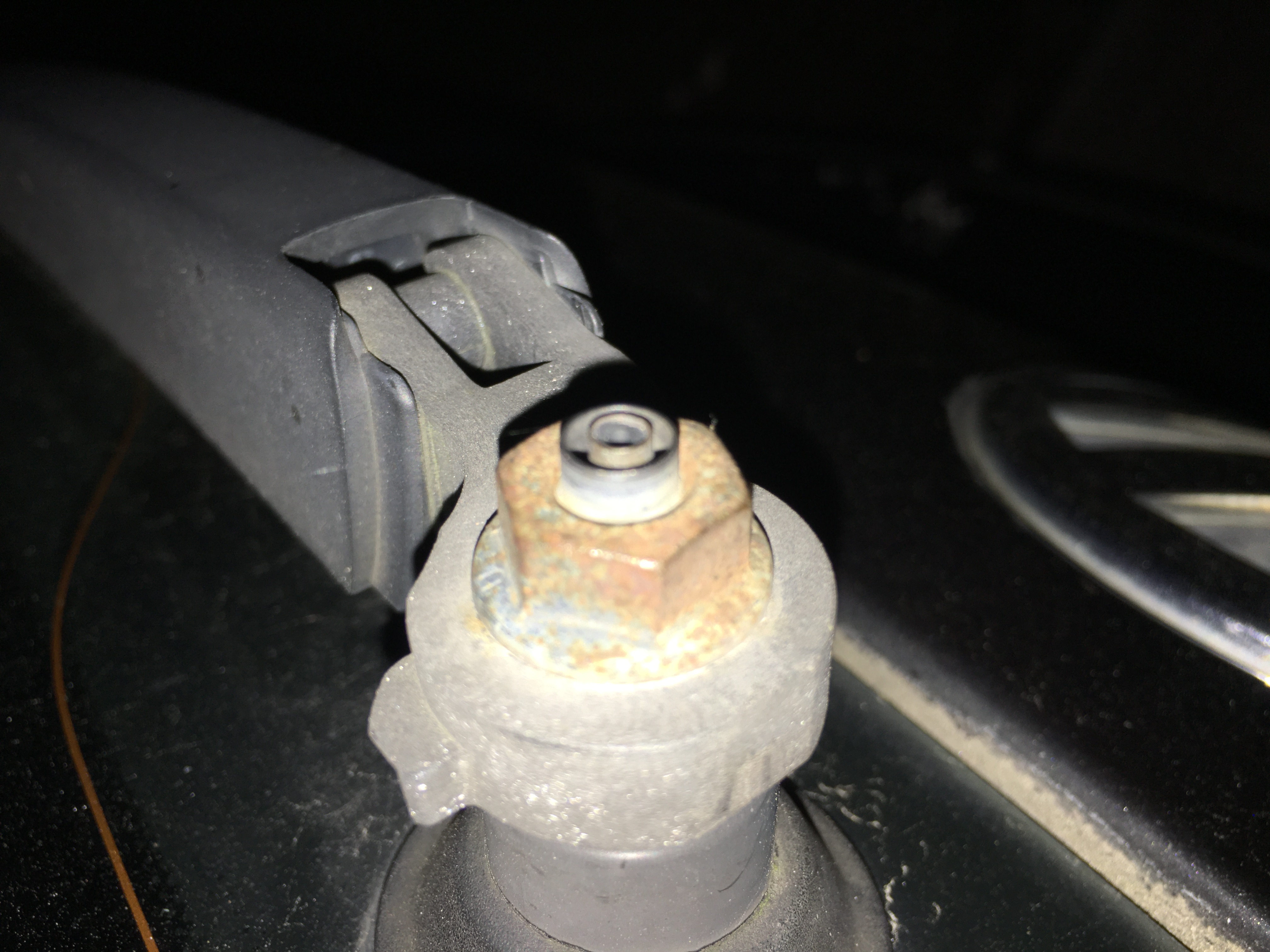

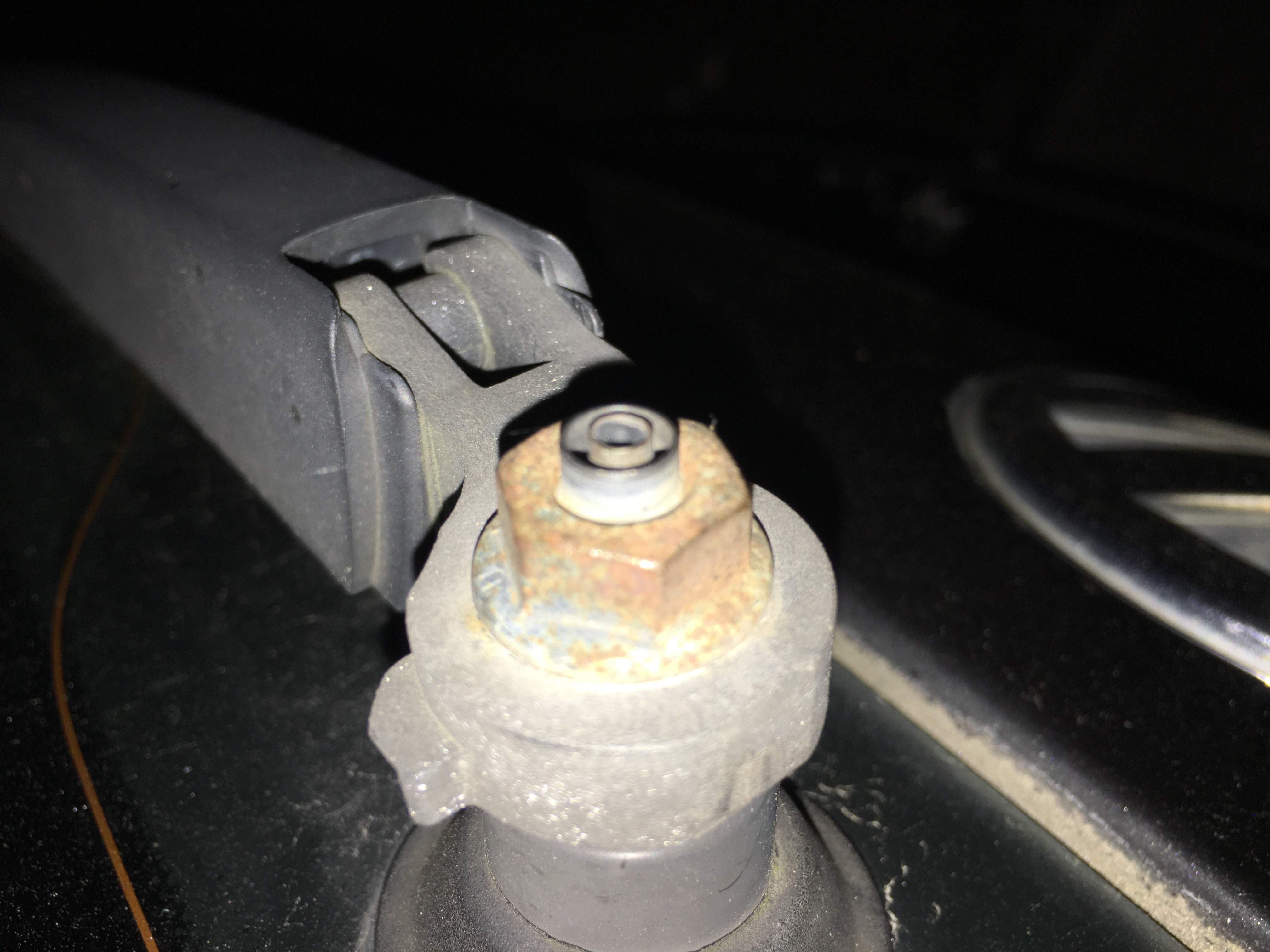

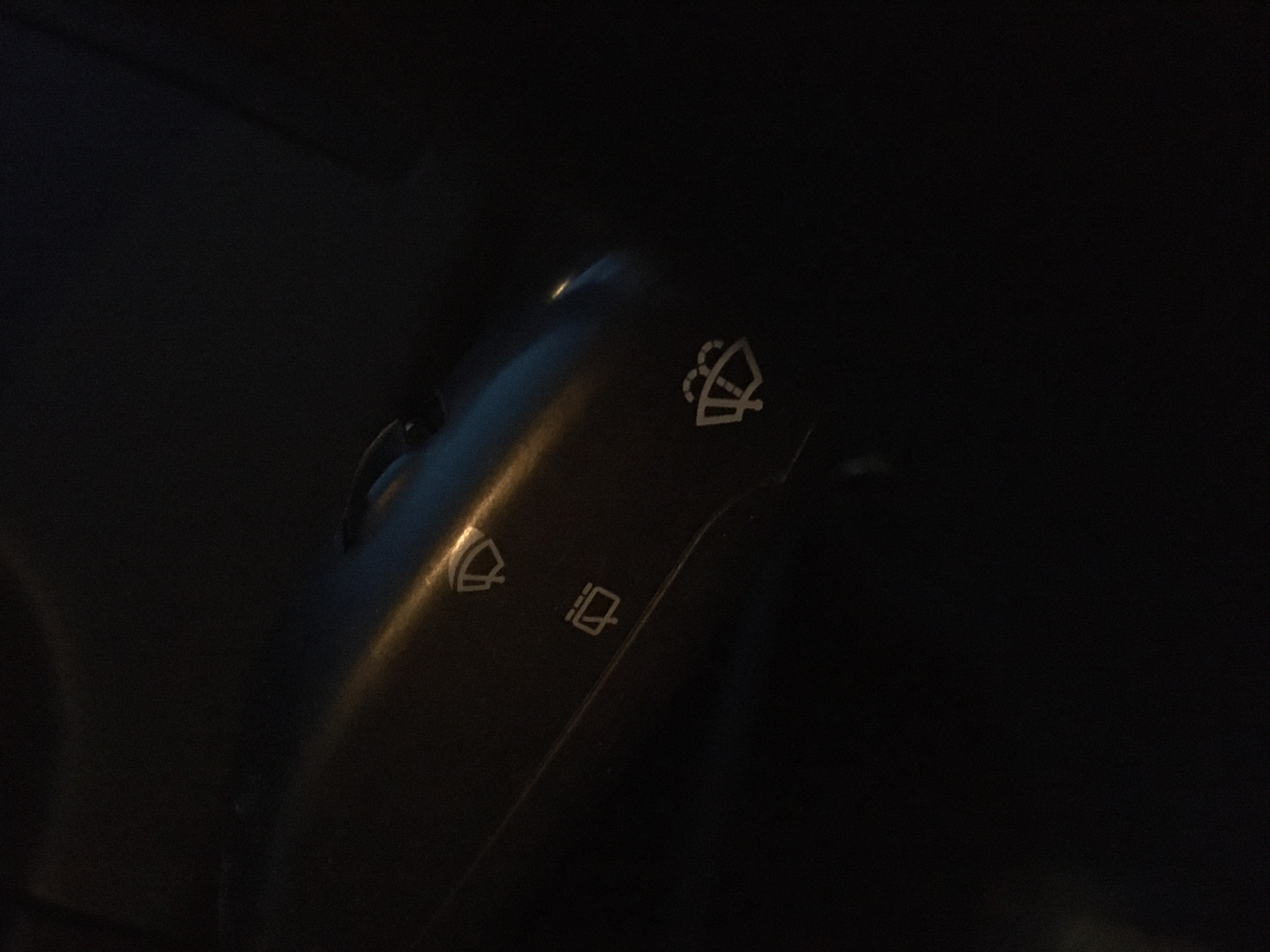

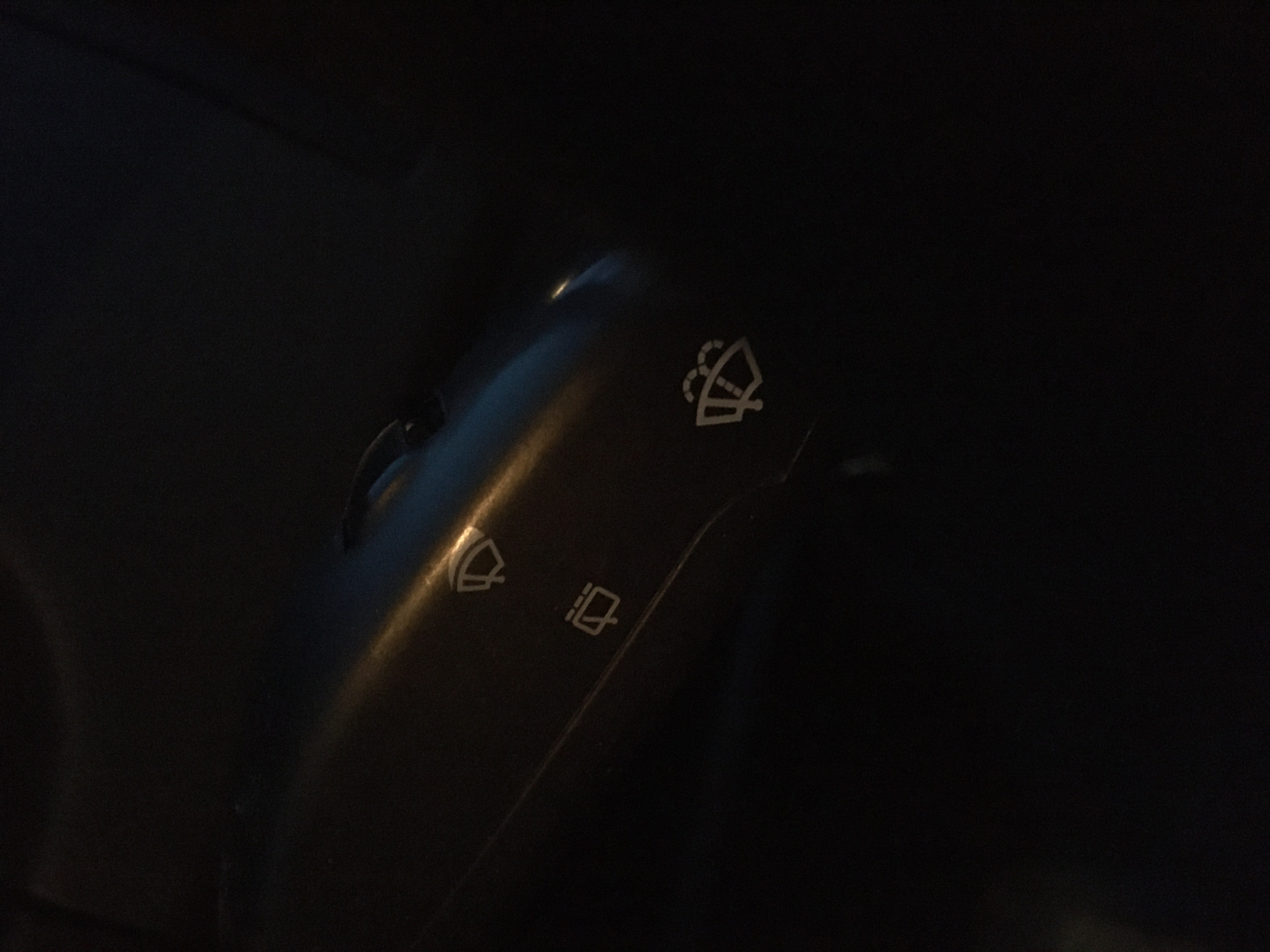

Out of interest, can anyone tell me please if I am supposed to have a rear screen wiper washer working or even fitted? If so, another little job to do
The model is a 2004/5 1.2 9n
Cheers
Andrew
Rear screen washer
- Posts: 6079
Re: Rear screen washer
All Polos will have a rear washer.
The jet should push down into the pipe inside the wiper shaft.
Can you hear the pump running when you select the rear wash and wipe.
Edit:- there should be a cover on the end of the rear wiper arm, if the jet is broken off, you will need to get the broken off end of the jet assembly out and press a new one in.

Thanks for all advice. Fitted new motor and arm and found the washer bottle to rear pipe disconnected and now all working
