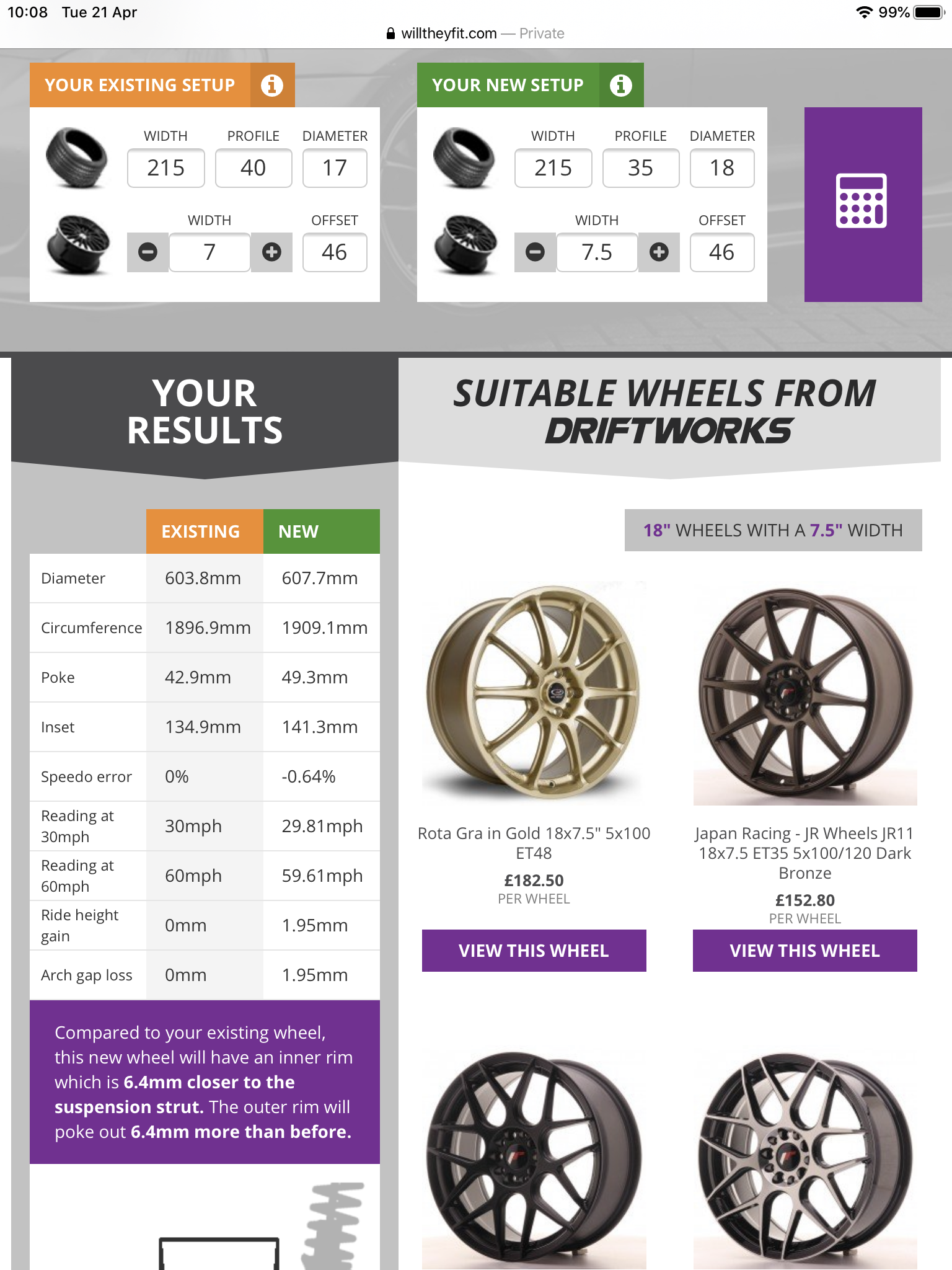

Assuming you still have the original factory alloys on at present (7Jx17” ET46 with 215/40 R17 tyres), the difference between your current set up and 7.5Jx18” ET46 wheels with 215/35 R18 tyres would be as per the screen shot below (from
www.willtheyfit.com with the above details);
You’d need a 35 profile tyre on 18” wheels to maintain broadly the same overall rolling radius / circumference of the new wheel + tyre compared to the standard GTI wheel/tyre set up and to minimise errors in speedo accuracy. If you increase the tyre width above 215, then the sidewall height will increase, so the speedo reading error would increase, and you’d also increase the risk of rubbing issues.

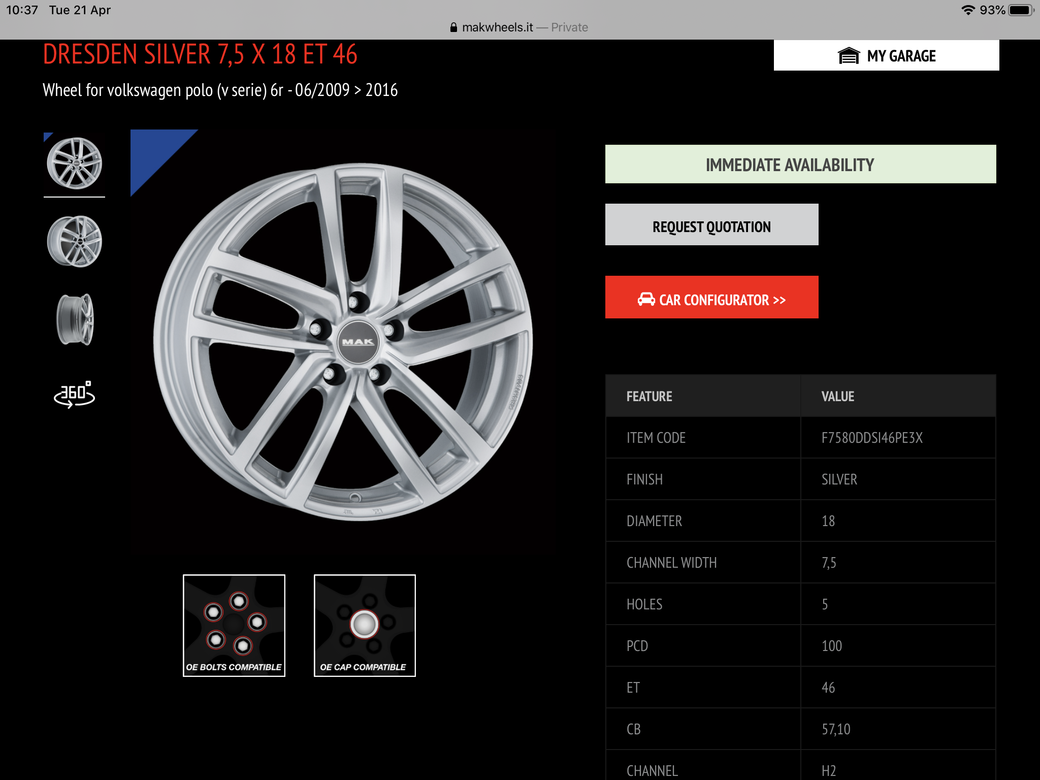

If you input details of your car into the Tyre Leader website, it confirms that those wheels are certified for the 6R Polo GTI. If you click through to wheel+tyre packages, you’ll see that they’re also recommending 215/35 R18 tyres.
Those wheels should also be compatible with your existing wheel bolts and centre caps - confirmed on the Mak Wheels website, and as they have a 57.1 centre bore, there’s no need for spigot rings;
